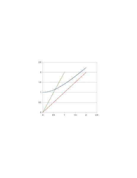

  • #121
cos;
from post 110
In that chapter (paragraph 1) Einstein wrote:- “If at the points A and B of K there are stationary clocks which, viewed in the stationary system, are synchronous; and if the clock at A is moved with the velocity v along the line AB to B, then on its arrival at B the two clocks no longer synchronize, but the clock moved from A to B lags behind the other which has remained at B by .5tv2/c2 ... t being the time occupied in the journey from A to B.”
In paragraph 3 Einstein refers to a clock that has remained at rest compared with an identical clock that has moved in a closed curve around that clock. I am of the opinion that he implied that clock B in paragraph 1 remains at rest ergo, in that chapter, Einstein does not allow that clock B “moves through spacetime”.
If someone were to draw a diagram of clocks A and B moving through spacetime they would be presenting that phenomenon from the point of view of another reference frame however Einstein specifically pointed out that the event is “viewed in the stationary system” (i.e. clock B’s reference frame).
Here is a space-time diagram from the B-frame.
Here is a quote from the Max Born book, page 257, which you have (A and B swapped).
"The paradoxical feature of this result lies in the circumstance that every internal process in the system A must take place more slowly than the same process in the system B."
Because A & B are synchonized initially, the only change is the motion of A. If Albert states there is a time difference when they meet, the time effect must be caused by the motion. He authored the theory, so he should know.
For those who do not understand, just because we can find a reference frame with a different perspective, does not mean this case is less real.
  • #122
phyti said:
cos;
from post 110Here is a space-time diagram from the B-frame.
I'd like to see the context of that quote, I wonder if Born specified that he was talking about what was happening in the rest frame of A. Looking at some other sample pages from the google book preview, I note that on p. 255 Born writes:
The same remarks apply to the relativity of time. An ideal clock has always one and the same rate of beating in the system of reference in which it is at rest. It indicates the "proper time" of the system of reference. Regarded from another system, however, it goes more slowly. In such a system a definite interval of the proper time seems longer. Here, too, it is meaningless to ask what is the "real" duration of an event.
Only relative to the time coordinates of the frame where they are initially at rest.
I didn't say any frame's perspective was "less real" than any others, just that no frame's perspective is more "physical" than any other's, so if different frames disagree about some question there can be no singe "true" physical answer to that question. Of course it is valid to say that in the rest frame of B, A is running slower than B after A accelerates...but do you claim that in this scenario A is "actually, physically" running slower than B as they approach one another?
