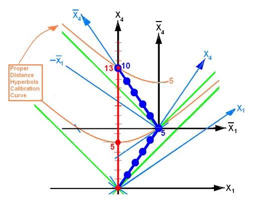

I like Mentz114 comments on this. Follow his lead (follow the world lines) and you will get there. Here are a couple of sketches that may or may not make sense to you. A stay-at-home twin is at rest in the black frame of reference, and his world line (red vertical line) is straight along the X4 axis. The traveling twin moves along the right-slanted world line (blue), then returns along the left slanted world line (blue). The world line distances along the traveler's world line (blue) are calibrated using the hyperbolas (in accordance with Mentz114's distance expression).
The blue dots (proper distance increments) correspond to proper distance marks along the red vertical world line. Note that the traveler blue proper distance traveled is less than the stay-at-home proper distance, even though the line lengths on the computer screen are the opposite. And of course an increment of proper distance along a world line is ds = c(dT) where T is proper time.
Summary: The traveling twin takes a short cut through spacetime (takes a shorter world line path), therefore he has aged less when reuniting with his twin.

That's nice but I'm trying to understand why I can't just invert your picture? Why can't I have the spaceman have his world line along the X4-axis and reverse your whole story? Especially for the away trip from Earth towards the midpoint with the star and the colony I should be able to reverse the roles of the observer on the colony and the spaceman as I please.
No Lorentz transformation will ever straighten out the kink in the spaceman's worldline.
Alternatively,
Suppose the Earth observer constructs a spacetime diagram by stacking his lines [hyperplanes] of simultaneity. If the spaceman tries the same procedure, something funny happens at the turn... his completed "diagram" will have two-sets of coordinates for some events and some other events in the Earth diagram won't appear in the spaceman's diagram. That makes the spaceman distinguishable from the inertial observers (like the Earth observer).

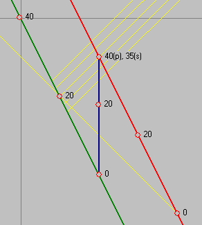

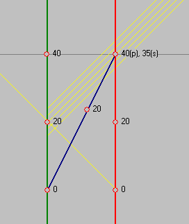

I can do that. Bur first, here is the situation where we use a rest frame in which each of the twins starts out moving in opposite directions at relativistic speeds with respect to the black coordinates. The numbers along the world lines for red and for blue represent calibrated proper distances (or proper times). The proper distances on the trip outbound are the same in this reference frame for both red and blue. But, after blue's turnaround, he is taking a shorter path to reunite with red.
I haven't really changed anything, just chose a different reference frame (I should have had the Earth flying off to the left instead of putting the stay-at-home twin in a red rocket--but you get the point). The blue twin is still taking an overall shorter path through spacetime (his short return path) and therefore ages less.
