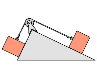

If the left-hand slope in the figure makes a 58° angle with the horizontal, and the right-hand slope makes a 32° angle, how should the masses compare if the objects are not to slide along the frictionless slopes?
F=ma

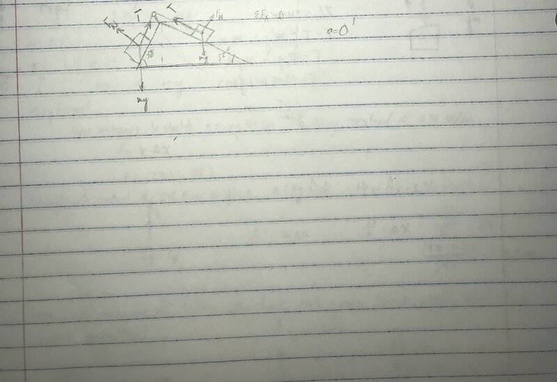

I have no clue how to do the problem. I created a free body diagram for each block. I assume that it is simpler than I am making it out to be.

First, use a different symbol for each mass. Calling them both "m" will confuse.
Next, write the force balance equations for each mass.
You can write an equation for each of horizontal and vertical or for parallel to the slope(s) and normal to them. Your choice.
