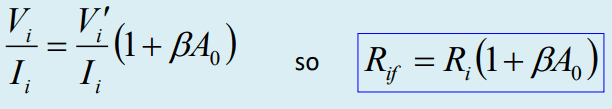

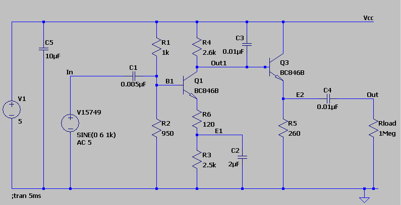

Am trying to find Effects of Feedback - Input resistance of this circuit.
Is this the formula that in need to use to find the input resistance of this circuit ?
Where do you see feedback in this amp? And R1 and R2 are in parallel with the input impedance of Q1...
