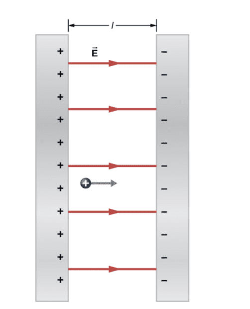

Two large conducting plates carry equal and opposite charges, with a surface charge density as shown in image. The separation between the plates is d. What is the
electric field between the plates?
##\vec E = \frac{\sigma}{\epsilon_0}##
I am confused with the solution. It says ##\vec E = \frac{\sigma}{\epsilon_0}##. Shouldn't E = ##2*\vec E = 2*\frac{\sigma}{\epsilon_0}##? Electric field of the positive plate and electric field of the negative plate.
It should not. Use a pillbox Gaussian surface with one flat face inside the conductor and the other flat face in the vacuum to see why and become unconfused.
Well if you mean that the total E-field should be double of that of the one plate, yes that is true but the field of one plate is ##E=\frac{\sigma}{2\epsilon_0}##. So the total field is $$2\frac{\sigma}{2\epsilon_0}=\frac{\sigma}{\epsilon_0}$$
