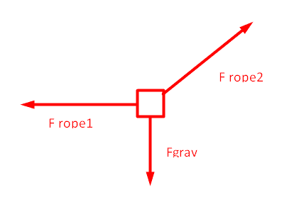

A box of mass X kg hangs motionless from two ropes, as shown in the diagram. The angle of rope 1 is specified amount of degrees. Choose the box as the system. The x-axis runs to the right, the y-axis runs up, and the z-axis is out of the page.
What is the magnitude of |F2|?

Here's the free body diagram:

To carry out a force balance in the vertical direction, in terms of the magnitude of F1, what is the component of F1 in the vertical direction?
I named the ropes inversely, but F1 would be 0 because it's the flat line. Sorry about the mixup, I'll fix that.
F2 is the opposite of gravity because it cancels out gravity's force, so -mg.

No. F2 is not equal to mg. In terms of the magnitude of F2, what is the vertical component of F2?
I thought the vertical component was the opposite of mg, but is it mg times sin(theta) rather than that?

In terms of the magnitude of F2, the component of F2 in the vertical direction is $$F_{2y}=|F_2|\sin{\theta}$$Does this make sense to you? If so, then, in terms of the magnitude of F2, what is the component of F2 in the horizontal direction?
Oh. For this problem, doing that made my homework site count it wrong for some reason, so I ruled it out.
F2x would equal |F2|cos(theta) based on that.
F2 would be the weight plus any force being exerted that moves it, but it's not moving so it's just the weight?

No. Please write down the force balances in the vertical and horizontal directions in terms of the components of F2 in the horizontal and vertical directions that you just determined.
F2 = <|F2|cos(theta), |F2|sin(theta), 0>

You don't seem to want to answer my question, so I'll answer it myself (again).
FORCE BALANCES
$$|F_2|\sin{\theta}-mg=0$$
$$|F_2|\cos{\theta}-F_1=0$$
Do you agree with these equations? If you solve the first equation for ##|F_2|##, what do you get? If you substitute that result into the 2nd equation and solve for ##F_1##, what do you get?
I didn't quite realize what you meant by force balances, I'm really sorry about that. For some reason I saw "components of F2" and assumed it to be the components in the vector.
It would end up as:
|F2| = mg/sin(theta)
And lead to:
F1 = mgcos(theta)/sin(theta)
I think I see what I wasn't connecting together now, thank you.
