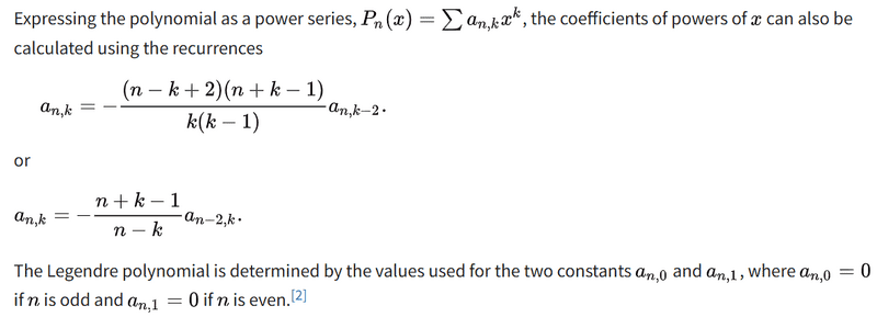

https://en.wikipedia.org/wiki/Legendre_polynomials
Does your sequence coincide with this ?

This is the correct recurrence. If you se l = k - 2 you will get it in the form posted by @anuttarasammyak.
For even solutions, we set ##a_1 =0## and ##a_0=1## Is this always the case?
Note that the ODE is linear, so a constant multiple of a solution is a solution. The same is true of the recurrence relation for the a_k. But the recurrence has to start somewhere, so a_0 and a_1 are arbitrary constants.
The recurrence is of the form a_{k+2} = f(k)a_k. It follows that if a_1 = 0 and a_0 \neq 0 then y will be even, and if a_0 = 0 and a_1 \neq 0 then y will be odd.
The Legendre polynomials are normalized such that P_n(1) = 1. This means that we don't get P_{2m} by setting (a_0,a_1) = (1,0); instead we have to leave a_0 arbitrary until we know the value of y(1) in terms of a_0.
