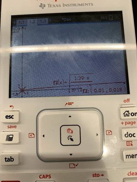

In regards to what is said here, I calculated it for water with the kinematic viscosity being 0.01 and t_0 being 1.31 (I have a question about this, how was 1.31 determined to be the initial time in order to find the maximum time for infinitely viscous fluids; the values for the boundaries basically) and I got 0.0196798321832. This answer is confusing to me as it is obviously not within the boundaries, any idea why this is happening or if I'm doing something wrong? For context, I am trying to plot
##\frac{16}{15}\sqrt{\frac{\nu t_0}{\pi R^2}}##
Also, if the equation:
##t_0=\sqrt{\frac{2L}{g\sin{\alpha}}}## is used to find the time for a completely inviscid fluid, then how do we determine the angular acceleration and how is it used to plot the times? My issue in understanding is that I'm unsure if the minimum time is the one that pertains to water or not?

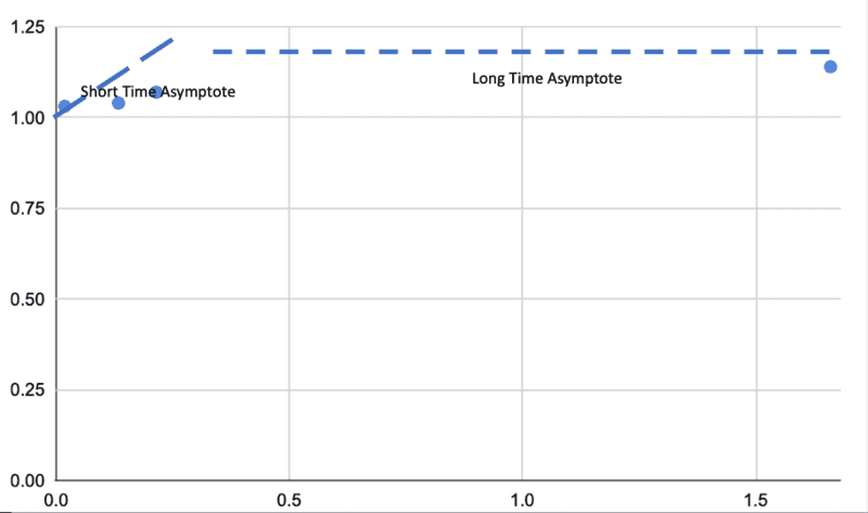

The minimum curve (analytic) should lie below the 4 data points. The maximum asymptote should lie above the 4 data points.
I understand that 1.31 seconds is an approximation for inviscid fluids and that the graph should have two vertical asymptotes at 1.31 and 1.6 with them being the boundaries for the time taken to reach the bottom of the ramp. I do not quite understand though how the approximation for 1.31 was made, was it an analytical approximation? I also understand that we need to plot that function for each fluid; however, when I calculated it for water using the value that t_0 is 1.31 and the kinematic viscosity is 0.01 poise, I was getting a value that would not make sense as a time value in the given scenario. Am I misunderstanding something? Is the formula not used to find the approximated time to reach the bottom of the ramp based on the fluid in question? For example: \frac{16}{15}\sqrt{\frac{\nu t_0}{\pi R^2}}=\frac{16}{15}\sqrt{\frac{0.01(1.31)}{\pi(0.035)^2}}=1.96798. What would this number represent, it is certainly too large to be that of a time value in the physical system being observed since the infinite viscosity limit is 1.6? As for the plot that I should make where \frac{16}{15}\sqrt{\frac{\nu t_0}{\pi R^2}} would be on the y-axis and t/t_0 is on the x-axis, what would this relationship show. I think I am also confused about the difference between t and t_0, I know t_0 is 1.31 but what is t? Is it the actual experimental value? Furthermore, why would the ratio t/t_0 approach 1+\frac{16}{15}\sqrt{\frac{\nu t_0}{\pi R^2}}? As this value again for example would be 2.96798 which I doubt that t/t_0 would give (in the case of water). Sorry for all the questions, I still have some uncertainty on this part of the investigation.
This seems to be an issue you can't seem to flush out... How are you expecting to pass all this analysis off as your own work if you are unable to understand the very simplest part of all this?

t=sqrt(2L/gsin(θ))=sqrt(2*1.45/9.81*sin(10.3)=1.28 seconds which can't be it and it would only equal 1.31 if the angle of inclination was 9.91 degrees which it isn't and why I have been confused.

Thanks for the reply. Did you use 10.3 degrees as the angle? I have calculated it and it is coming out to be 1.28 seconds (specifically, 1.28581369737) rather than 1.31 seconds. Also, in terms of the graph, ##\frac{\nu t_0}{\sqrt{\pi R^2}}## is the parameter that quantifies the time taken to reach the bottom of the ramp between the two limits? Furthermore, when calculating the time taken the results are confusing. For example, let's take water with a kinematic viscosity of 0.01 poise, ##t_0## is 1.31 seconds, and the radius R is 0.035 m. The value I am getting is 1.84498426718 seconds which cannot be the case in this physical system. If I'm understanding correctly, when graphing ##t/t_0## then I should be able to find that what is right hand side of the formula is equal to ##sqrt(3/2)## at high viscosities and what would it show at low viscosities? Also where is the formula for shear stress found in the Transport Phenomena book, the problem is on page 115 but I cannot find the formula for shear stress (using velocity, boundary layer thickness, and viscosity) that you had mentioned in the initial attempt on the solution.
  • #98
OK. 1.29 seconds

Yes, I am getting 1.84 for the calculation (for water) and the number increases/decreases based on the fluid inputted (in terms of kinematic viscosity in poise where the radius 0.035 m). OK, so it shows the values that are predicted by the analytical expression by looking at the changes in time divided by 1.29 seconds and that's where we can see the values predicted? Is that used to figure out that the timing for long times is given by ##sqrt3/2*t_0## where the values will approach but never be able to pass the horizontal line that gives that value? As for the second formula (second approximation for the solution), using the same values for the radius and kinematic viscosity of water gives the result that ##t/t_0=2.376## for water where that number is a dimensionless parameter presumably. I guess I'm having trouble understanding what this number represents?

The kinematic viscosity ##\nu=\mu/\rho## is not in poise. It is in cm^2/sec. Dynamic viscosity ##\mu## is in poise. Watch your units!!!

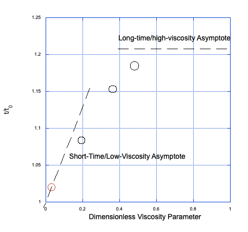

Let's see the results for t or t/to vs the other dimensionless parameter involving kinematic viscosity.
No. The ##\sqrt{3/2}## comes from the asymptotic solution at large values of the dimensionless parameter involving kinematic viscosity.
The analytic solution at short times can't give 2.376. It has got to be close to 1. I need to see your calculated results for t/to vs the dimsionless parameter ##\frac{\nu t_0}{\sqrt{\pi R^2}}## for each of the fluids. One data point for each fluid.

1.84 should represent the time it takes for water to reach the bottom of the ramp but that cannot be the case. I have done the calculation several times with a calculator and have gotten the same answer. It is weird that it comes out to 2.376, though, I thought that the value was supposed to be < < 1, is that not the case? Though I do note that in the solution you stated that it's much less than 1 for when we are calculating ##sqrtvt/R## and not ##\frac{\nu t_0}{\sqrt{\pi R^2}}## though I'm not quite sure of the difference and which one I should focus on. For the asymptotic solution at long times, how was sqrt(3/2) determined from the dimensionless parameters. On the section involving the dimensionless parameters I can't seem to find the derivation for it? I'll plot the rest of the values and see if there is any meaning to the data then using ##\frac{\nu t_0}{\sqrt{\pi R^2}}## for the other liquids I used.
  • #102
We lost something in transferring the results from post to post. The correct results are in post #45. The horizontal axis parameter should be $$\sqrt{\frac{\nu t_0}{\pi R^2}}$$ rather than $$\frac{\nu t_0}{\sqrt{\pi R^2}} $$
Try redoing the calculations with the correct parameter and let's see what you get. The incorrect parameter results should not have come out dimensionless.
Also, I’d like to see your calculations for the case of water.

##\sqrt{\frac{\nu t_0}{\pi R^2}} = sqrt((1.29*0.01)/(pi*0.035^2)) = 1.83##. Any idea why this is the case (this is the calculation for water)? Also, for how you expressed the change in angular velocity over time in post #51, is there a source for this formula or is this from your own knowledge (the part before deriving the solution based on dimensionless parameters)? Would it be fair to say that I can omit the asymptotic solution and the solution of the dimensionless parameters from the investigation because an in-depth discussion into the viscosity boundary conditions and the parameters used to find the time taken to roll down the ramp should be sufficient based on my personal judgement, no? The only thing I would include perhaps is the derivation using the dimensionless parameters in the appendix so that I can refer to it in the theoretical background when I refer to how the long-time formula is:
Yes. The units are screwed up. It should be 0.0183. The R should be 3.5, not 0.035. We are working with cgs.

I'm thinking of doing the experiment again today with more data points as it seems that the calculations aren't adding up, maybe they'll come out closer this time to the expression we have to calculate the time. I graphed the parameter as a function and you can see it here: https://www.desmos.com/calculator/fvlmni6hev
I can't read the graph. t/to should be y, and the other dimensionless group should be x. Do you not have access to Microsoft Excel? In terms of these x and y parameters, the short term solution should be a straight line. ##y=(1+\frac{16}{15}x)##

Like I said, the 0.035 should be 3.5.
I redid the calculations then and the range of values is 0.0183-0.2087. Also, I was graphing the parameter for ##t=\sqrt{\frac{\nu t_0}{\pi R^2}}## not ##t=t_0\left(1+\frac{16}{15}\frac{\nu t_0}{\sqrt{\pi R^2}}\right)##. In regards to the dimensionless parameters, I read it quite a few times to determine where the sqrt(3/2) came from but it was never explicitly stated in the post, I may have misunderstood it though or maybe it was inferred piece of information?
