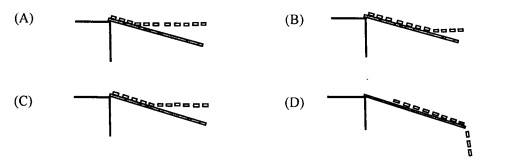

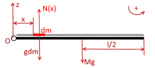

A uniform rigid scale is held horizontally with one of its end at the edge of the table and the other supported by hand. Some coins of negligible mass are kept on the meter scale.
As the hand supporting the scale is removed, the scale starts rotating about its edge on the table and the coins start moving. Which of the following would look closest to the situation if a photograph of the scale is taken soon after
2. Homework Equations
Torque = ##r \times F##
##L = r \times p##
Torque = ## \frac {dL} {dt}##
This problem looked trivial until I tried to reason why the different options given would not be correct. This is how I thought about. Initially coins are at rest supported by reaction force provided by the hand. Now when the hand is removed, there is going to be a moment about the hinged part as a result of change in angular momentum. The torque is highest at the ends due to the length of the arm and lowest at points closer to the hinge. Also I think it is fair to assume that friction is greater than the force pulling it to the right on the coins closer to the hinge as it is about the situation immediately after the hand is removed and therefore I can conclude the coins are going to stick to the rod. However I am not able to come to conclusion regarding the coins at the right end especially trying to reason why option C and B could or could not be possible. Also I could not get my reasoning correct as to why the coins should separate from the right end as shown,
