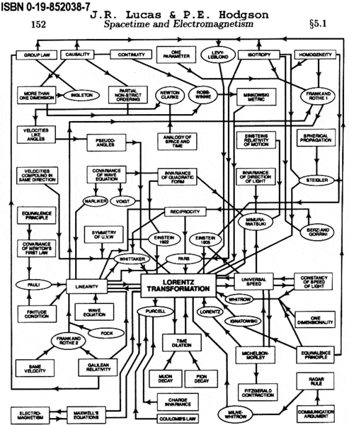

With the question of what assumptions underlie relativity,
I think it useful to appreciate that there are many ways, which depend on what one starts with.
Following up on my earlier post (#9) in this thread is a link to a very old post of mine
https://www.physicsforums.com/threa...-challenge-for-experts-only.83373/post-694535
which featured
a chart from "Spacetime and Electromagnetism" by J.R. Lucas, P.E. Hodgson
where they try to diagram the various approaches to obtain the Lorentz Transformations.
[Certainly, the chart is not complete... but merely representative.]
(Sorry about the small size... that was what I had at the time.)
So, the point is... where does one wish to start?
Likes Dragrath and martinbn
robphy said:
With the question of what assumptions underly relativity,
which featured
I think it should also be noted that just because one road can be taken or was taken in the historical development of the theory that does not mean that that road is in any way privileged. The theory is what it is and it can be tested experimentally. One could just as well start by defining Minkowski spacetime and introduce Lorentz transformations as coordinate transformations between orthonormal affine coordinate systems. Then there is the question of what experiments say.

One point to note is that it is circular reasoning to say that the transformation of velocities formula is derived from the Lorentz transformation, because the velocity transformation formula is often a step in the derivation of the Lorentz transformation.
  • Skeptical
Likes strangerep, weirdoguy and PeroK
Can you show us this step?
Likes strangerep, vanhees71 and Sagittarius A-Star

  • #33
I'm not familiar with such a derivation. The derivation I favor requires the following three assumptions. One: if we have two observers in relative motion at the same location, light emitted by one will experience a doppler shift factor k, when received by the other, the ratio k being the ratio between the interval of emission and the interval of reception. Secondly, we need the assumption that the speed of light is constant for all inertial observers. Thirdly, to handle two observers in relative motion who are not at the same location, we add another assumption, which states that light emitted from an inertial observer and received by another inertial observer at rest with respect to the first at a different location will experience no doppler shift, that the k factor will be unity.
This is basically Bondi's argument, though Bondi did not, to my knowledge, codify the third and last assumption. I feel the third assumption is a useful approach, though, and shores up some things I don't like about Bondi's approach. I should add, I've never seen the third assuption in a published paper, but I still like it.
We don't need any arguments about velocity addition to use the above assumptions, which are simple and straightforards, and only require high school algebra to analyze. The analysis can be found in Bondi's book, "Relativity and Common Sense", and basically uses a simple radar setup to determine the relationship between the factor k and relative velocity. Looking up "k-calculus" on the internet will probably also work for those who don't want to track down Bondi's book.
Likes robphy and vanhees71
  • #34
Everything follows from the invariance of Maxwell's wave equation. The velocity of waves is not derived from any kind of dx/dt. The velocity of a wave is more like a geometric speed. If you take a mass-spring system, with overall mass M and overall spring constant K, where the length of the system is L, the velocity of a wave is given by (KL^2/M). It is kind of a different type of velocity, as I said, not dx/dt.
Now, if you put the mass-spring system on a train, then it goes at the wrong speed, for an observer on a platform, since, classically, the velocity is KL^2/M+v, where v is the speed of the train. Therefore, the wave equation is not valid for a spring on a train.
For a mass-spring system, you can sweep this under the rug, as you can see the masses and the springs on the train. One can say, there is a preferred reference frame for a spring-mass system, the one where the springs and the masses rest.
For light, and Maxwell's wave equation, the sweeping under the rug doesn't work, as light doesn't require a medium. There is no preferred reference frame in which the medium rests, as there is no medium.
Then you have two options, you give up one the wave equation, or you fix the Galilean invariance, such that the speed of light is always the same, for every observer. If you assume a general space and time transformation, which leaves the wave equation invariant, you end up with the Lorentz transformation. This is pretty straightforward.
Once you got the Lorentz transformation, the rest, like relativistic addition of velocities, follows quite easily.
By the way, if you assumed for a minute, that light was a mass spring system, then, with the Lorentz contraction of L, the relativistic mass follows directly from the constance of KL^2/M.
