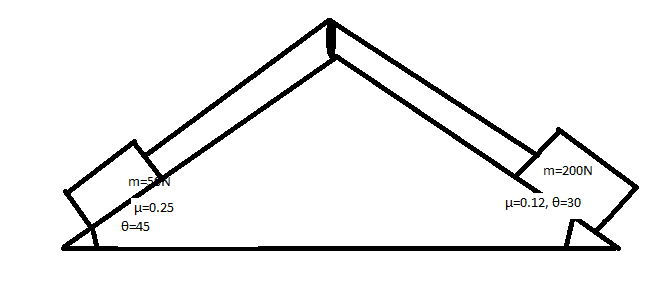

Two blocks of weight 50N and 200N are connected by a cord rest on two inclined planes .determine the maximum tension in the cord when limiting friction condition develop in both blocks
R1=Reaction of weight 50N
R2=reaction of weight 200 N[/B]
for block of mass 50 N moving upward
µ1R1+wsin45-T1=0
for block of mass 200N assuming moving downward
T2+ µ2R2-W2sin30=0[/B]
:Its just that I am not able to understand why there is different tensions in the cord .Doesnt the tension should be equal if the cord is weightless?[/B]

Yes, the tensions must be the same if the cord is massless and there's no friction at the pulley. What makes you think they're different?

Well, as I wrote, unless there is friction on the rope at the apex the tensions will surely be equal.

Ok, I think I understand what is going on here.
The T1 calculated is an upper limit on the tension for static equilibrium. If the tension exceeds this then block 1 will slide up. The T2 calculated is a lower limit on the tension for static equilibrium. If the tension is less than this then block 2 will slide down.
If the calculated upper limit were greater than the calculated lower limit then it would be stable. The actual tension would be anywhere in that range. (It can happen that it simply is not possible to determine the actual tension.). As it is, the lower limit comes out higher than the upper limit, so it is not stable.

There is only one actual tension throughout the cord. The calculation is finding an upper and lower bound for its value, on the assumption that there is static equilibrium.
If the upper bound is the greater then there is static equilibrium and the actual tension is somewhere in the range (but there is no way to find out where in the range).
If the lower bound is the greater then we have a contradiction, so the assumption of static equilibrium must be false.
In my view, the approach taken in the textbook is confusing, and even seems to have arrived at the wrong conclusion.
I would take the tension to be T both sides, then write down the constraints for static equilibrium each side.
##T<=m_1g\sin(\theta_1)+m_1g\cos(\theta_1)\mu_s##
##T>=m_2g\sin(\theta_2)-m_2g\cos(\theta_2)\mu_s##
Whence
##\mu_s(m_1\cos(\theta_1)+m_2\cos(\theta_2))>=m_2\sin(\theta_2)-m_1\sin(\theta_1)##
If that condition is satisfied, there is a T that produces static equilibrium (but we might not be able to say exactly what it is).
If the condition is not satisfied (as here) then it will slide. If we wish to find the tension in the cable we must now introduce an unknown acceleration and use the kinetic friction coefficient.

This is my take on this problem in light of the supplied "book" solution.
Both tension, T1 and T2 are arrived at assuming that the fiction forces are to the left, thus opposing motion to the right.
The value of T1 that's calculated is the maximum value of tension, T, that will produce static equilibrium. (If we consider this to be a kinetic situation, then T1 is the minimum value of tension, T, that will enable sustained motion to the right.)
T2 is a bigger puzzle.
The value of T2 that's calculated is the minimum value of tension, T, that will produce static equilibrium. Any smaller value for T2 will give motion to the right. If T is greater than this (up to a point), then the static friction will simply be less than μ2R2, R being the normal force. (T2 can be as large as 120.78 N for static equilibrium.)
Considering the values of T1 and T2, there is no possibility of this system being in static equilibrium.
