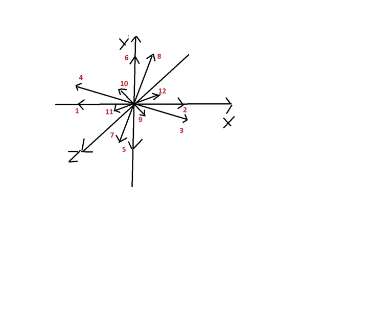

Could anyone explain which component Vy (Y-axis) will have velocity vector with Vx component (X-axis)? Is it true that if velocity vector has Vx component in X-axis direction and Vy component in Y-axis direction then there is velocity vector with Vy component in X-axis direction and Vx component in Y-axis direction?
If I understand your question, the answer would be any vector not parallel to the y-axis will have a nonzero x-component.
Not sure what you're asking here. A y-component never has a direction parallel to the x-axis, and a x-component never has a direction parallel to the y-axis.
Perhaps you could explain why you're asking these questions. They are worded strangely.

Sorry, but I try to ask correctly. If we have velocity vector V1(V1x, V1y) then do we have velocity vector V2(V1y,V1x) (if there is no specific direction)?
Are you talking about the velocities of two different molecules? And those are two molecules in a macroscopic sample of gas? What do you mean by no specific direction?
I'm thinking there's a language barrier in this discussion.
By swapping the components you are not canceling the momentum, you have to negate the components for that, if that was your idea here. If not, then explain what you are trying to achieve here. Your question makes little sense.

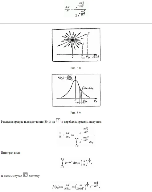

I read in one source that molecules of gas are moving in two directions (X-axis and Y-axis):
Are these images correctly? And how to understand what does this mean?
I don’t think those images are good. They give the impression that every molecule is going outward from a single point. They also give the impression that for every molecule going one way there is another with equal and opposite velocity. They also give the impression that all of the motion is in a 2D plane. None of those are correct impressions.
Likes A.T. and Mike_bb
Now I understand you. In this book it's written that one part of molecules (N/2) move in positive direction and another part of molecules(N/2) move in negative direction.
It seems logically to me because average of components of velocity vectors (axis X) is 0.

I understand it. But how is it possible that for Y-axis we have the same figure with arrows?
On average that is true. So the numbers 0.188, 0.268, and -0.456 are randomly distributed from a standard normal distribution, but none of them are equal and opposite to each other. It is not necessary for every value to be matched with its opposite for the average to be zero.

Ok. But in this book it's written that every value of X-component of velocity vectors match with its opposite. Is it wrong?
This book says that each of vectors has opposite vector because both direction (negative and positive) are equiprobable. It's true, yes?

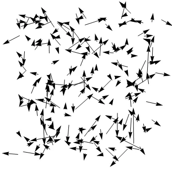

Here is a more realistic image:
The main thing wrong with this image is that it is 2D and this kind of motion happens in 3D, and also the arrowheads are a fixed size so on the shorter arrows you cannot see the tail. But this accurately represents a collection of 200 gas molecules that are randomly distributed (uniform distribution) in a box with randomly distributed (standard normal distribution on each axis) velocities.
Because the x-direction is chosen randomly. It could have been the y-direction that was chosen instead, or indeed any direction.
  • #31
Yes, with the qualifications stated below.
Not if you have a tremendously large number of molecules, which you do.
So the chances of these statements being true is so incredibly large that they can be considered true.

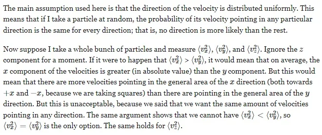

PS. I found on SE alternative explanation but I can't understand it. Could you explain in more detail? Big thanks!
  • #35
What exactly you don't understand? Which sentence? I think this description is really straightforward...
  • #36
"... it would mean that on average..." this сonfused me. What does it mean? Average of components?
  • #37
It means that you take the average. That's what the bracket notation <...> means. So the average value of ##v_x^2## is ##<v_x^2>##.
And yes, it's average of components. Because ##v_x## is the x-component of ##\vec{v}##.

Hi all!
In the book there was following expression:
##N\frac{mc_x^2}{2} = \frac{N}{3} \frac{mc^2}{2}##
##c^2 = 3с_x^2##
Explanation: 1/3 of all particles moves along one axis (in both directions).
I depicted 12 particles and their velocities. But I don't understand which 4 molecules move along one axis.
Could anyone explain it?
Thanks.
  • #43
What are the variables?
Again, this is not a good depiction, in my opinion. See above.

Mike_bb said:
Hi all!
##c^2 = 3с_x^2##
Looks like you have depicted something else than the book describes.
  • #46
Each velocity vector has opposite velocity vector because gas is isotropic.
  • #47
That isn’t correct, as we already explained above.
  • #48
If that isn't correct then there is specific direction but it's wrong.
  • #49

Really? What is the specific direction in the figure in post 29?
