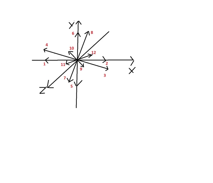

Mike_bb said:I depicted 12 particles and their velocities. But I don't understand which 4 molecules move along one axis.
Could anyone explain it?

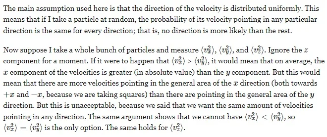

Herman Trivilino said:"The main assumption here is that the direction of the velocity is distributed uniformly."
Is this explanation verbatim from the book? Or is it your own interpretation? Either way, It is utterly incorrect.Mike_bb said:Explanation: 1/3 of all particles moves along one axis (in both directions).
It's not enough.Herman Trivilino said:It's the first sentence in the passage you quoted:
You asked for "idea of proof", and that's the idea: To show that the direction of the velocity is uniformly distributed.Mike_bb said:It's not enough.

Looking at your drawing here, those numbers are quite wrong. Where are you getting them?Mike_bb said:##<V_x^2> = \frac{1^2+3^2+2^2+7^2+...}{N}##
##<V_y^2> = \frac{(-3)^2+(-1)^2+2^2+7^2+...}{N}##
My post #65 is not about this situation.jbriggs444 said:Looking at your drawing here, those numbers are quite wrong. Where are you getting them?
As I read the drawing, ##v_{1x}## is negative, ##v_{2x}## is positive, ##v_{3x}## is positive and ##v_{4x}## is negative. ##N## is 12 for that situation.
For this proof:weirdoguy said:So what is it about?
So, again, where did those specific numbers come from?Mike_bb said:My post #65 is not about this situation.
These numbers are random but from expressions for ##<V_x^2>## and ##<V_y^2>## we can see that X-axis and Y-axis are equiprobable. (gas is isotropic)jbriggs444 said:So, again, where did those specific numbers come from?
Technically the quoted passage is false. It is an argument, not a valid proof.Mike_bb said:
jbriggs444 said:This illustrates the point that having a uniform distribution of directions is not sufficient to make a velocity distribution isotropic.
I've nothing to add to the responses given in Posts #66 through #73.Mike_bb said:
How can we infer a uniform distribution from a pair of samples that are not?Mike_bb said:Herman Trivilino,

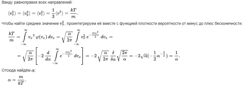

But what are you integrating over?Mike_bb said:
If you are integrating between these limits, you are probably integrating over a distribution rather than over a finite sample. The general form would be ##\int_{-\infty}^{+\infty}f(x) \text{pdf}(x) dx## where we have arranged that ##\text{pdf}(x)## is a proper probability density function, i.e. ##\int_{-\infty}^{+\infty} \text{pdf}(x) dx = 1##.Mike_bb said:But I'm confused because this integral is taking from ##-\infty## to ##+\infty##.
Stop reading that stuff and read a university-level introductory physics textbook. That's the best advice I can give you given that you haven't answered my questions about what you're doing and why. I have to glean from your posts that you are trying to understand something about the distribution of velocities of gas molecules. A university-level introductory physics textbook is the best place for you to do that.Mike_bb said:read now on Wiki how to derive expression for <Vx2> using integral. But I'm confused because this integral is taking from −∞ to +∞.
@Mike_bb, can I throw this in...Mike_bb said:... As is mentioned above: for example, in X-axis in negative direction we can have -6 and in positive direction we can have 1,2,3 (average is 0). But if we use integral from ##-\infty## to ##+\infty## then we obtain that every positive component in X-axis has opposite (negative) component (1,2,3) and (-1,-2,-3). How is it possible? Thanks.
I'm integrating over continuous distribution. (components of velocities on X-axis)jbriggs444 said:But what are you integrating over?
How is it possible? Why should it not be possible? Why the surprise?Mike_bb said:I'm integrating over continuous distribution. (components of velocities on X-axis)
The result is ##\frac{kT}{m}##. This result coincide with ##<V_x^2>## (finite large sample). How is it possible?

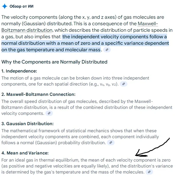

Is not a valid reference here.Mike_bb said:Google AI:
No. You are wrong! Try working through the following carefully.Mike_bb said:Am I right that for every particle with positive component on X-axis we can find particle with opposite (negative) component?
1. Google AI is not an acceptable reference. [See the rules here. Search for "ChatGPT and AI-generated text"]Mike_bb said:jbriggs444,
Ok. Is it right that if we have particle with X-component 4 then we can find particle with Y-component 4? (Google AI says it's true)
