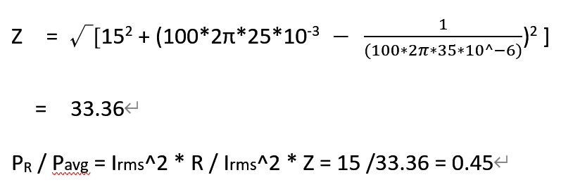

A series circuit consists of a 15-Ω resistor, a 25-mH inductor, and a 35-μF capacitor. If the frequency is 100 Hz the power factor is:
The answer is 0.45
PR / Pavg = Irms^2 * R / Irms^2*Z
I calculated in the following and got the correct answer. However, I wonder whether this way is correct or not. Thanks!
PR / Pavg = Irms^2 * R / Irms^2*Z = 15 /33.36 = 0.45

So how did you get the 33.36 ? From 15/0.45 ? Then the answer is per se correct, but 'the way' is not :wink:
And you have me wondering why you type 33.36 and not 33.33 :cool:

z=√[15^2 + (100*2π*25*10^-3 - 1/(100*2π*35*10^-6))^2]

My detailed calculation is as attached.

Yes the power factor is ##\cos\phi=\frac{R}{Z}##.

Ok Thank you, I understand.
