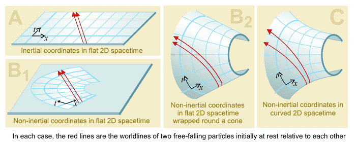

DrGreg said:
This is my own non-animated way of looking at it:
  • A. Two inertial particles, at rest relative to each other, in flat spacetime (i.e. no gravity), shown with inertial coordinates. Drawn as a red distance-time graph on a flat piece of paper with blue gridlines.
  • B1. The same particles in the same flat spacetime, but shown with non-inertial coordinates. Drawn as the same distance-time graph on an identical flat piece of paper except it has different gridlines.
    B2. Take the flat piece of paper depicted in B1, cut out the grid with some scissors, and wrap it round a cone. Nothing within the intrinsic geometry of the paper has changed by doing this, so B2 shows exactly the same thing as B1, just presented in a different way, showing how the red lines could be perceived as looking "curved" against a "straight" grid.
  • C. Two free-falling particles, initially at rest relative to each other, in curved spacetime (i.e. with gravity), shown with non-inertial coordinates. This cannot be drawn to scale on a flat piece of paper; you have to draw it on a curved surface instead. Note how C looks rather similar to B2. This is the equivalence principle in action: if you zoomed in very close to B2 and C, you wouldn't notice any difference between them.
Note the diagrams above aren't entirely accurate because they are drawn with a locally-Euclidean geometry, when really they ought to be drawn with a locally-Lorentzian geometry. I've drawn it this way as an analogy to help visualise the concepts.
Likes Adel Makram

So, my two concerns here in this thread can be demonstrated in those nice graphs;
1) Graph C shows how a curved space-time (gravity) with non-vanishing Riemann tensor may have a vanishing Ricci tensor.
2) Graph B shows how an accelerating frame with non-inertial coordinates can exit in a flat space-time (with no gravity).
