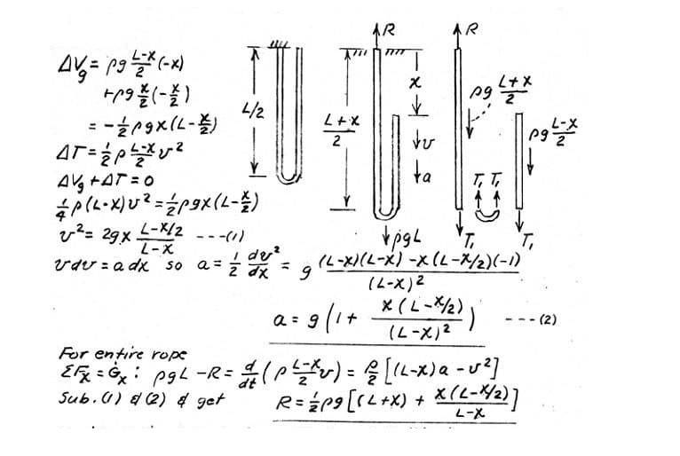

Both ends of a rope with the mass of ρ kg/m and length of L are attached to a horizontal surface (see photo attached). At t=0, one end of the rope detaches from the surface and starts falling vertically. When this end falls the height X, what is the tension on the other end of the rope?
F=ma
E=U+K
and any equation in classical physics.
I have attached two different attempts to solve this problem. They both look correct to me but they give two different answers! Which one is correct, which one is wrong and why?

The second attempt is correct. I am having difficulty following the first attempt, but I note that the answer you have there has a factor x, making the initial tension zero. There are also some unbounded terms in the working as x approaches L.

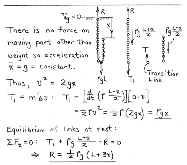

Hello,
Thanks for your response. Please note we are after tension at the fixed end which is referred to as R in both soloutions.
Thanks
What exactly is ##T_1## and how you set it equal to that expression?
Also isn't there supposed to be some interaction between the moving part and the non moving part which will affect the velocity of the moving part which will no longer do free fall?

Ok, but in solution 1 there is still a divisor of L-x, which cannot be right.
Likes Ebi
I do not understand why the total energy must conserve.
The equations of variable mass systems must be employed

Using my own approach I get the result $$R=\rho g(\frac{L}{2}+3x)$$
(No I don't have a typo in the final result).
I ll post my approach when I find the time.

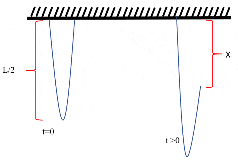

Assume that the distance ##w## between the attachments to the horizontal surface satisfies ##w \ll L##. Write ##u = X/L##, then the distance ##\xi## of the centre of mass below the surface is given by ##\xi = \dfrac{L}{4} \left( 1 + 2u - u^2 \right)##. The free end of the rope is in free fall so ##\ddot{X} = g##, ##\dot{X} = gt## and ##X = \frac{1}{2}gt^2## hence ##\ddot{\xi} = \dfrac{g}{2} \left( 1 - 3 u \right)##.
The equation of motion satisfied by ##\xi## is ##\rho L g - T = \rho L \ddot{\xi}## which can be rearranged for ##T = \dfrac{\rho g L}{2} \left( 1 + 3 u \right)##.
Likes Ebi Rogha and Ebi
This formula for ##\xi## looks like it "drops from the sky". Can you elaborate more on how you find it?
Likes Ebi
From the definition ##\boldsymbol{R} = \dfrac{\sum_a m_a \mathbf{r}_a}{\sum_a m_a} ## write\begin{align*}
\xi = \dfrac{ X \left(\dfrac{X}{2} \right) + (L-X) \left( X + \dfrac{L-X}{4} \right)}{L} &= \dfrac{L}{4} + \dfrac{X}{2} - \dfrac{X^2}{4L} \\ \\
&= \dfrac{L}{4} (1 + 2u - u^2)
\end{align*}

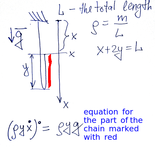

The one-dimensional fall of a folded chain with one end suspended from a rigid support and achain falling from a resting heap on a table is studied. Because their Lagrangians contain no explicittime dependence, the falling chains are conservative systems.
Funny argument little bit. Why do that guys consider this system to be Lagrangian? Assume that the energy is conserved and prove that it is consered.Actually at the folding point the links of the chain lose their velocities instantly from some nonzero values to the zero value. It is like a nonelastic collision.
If the energy would be conserved then the chain would have never come at the rest.
If we want to consider the Hamiltonian statement of the problem that is ok but then we have to use the true equations of chain's motion in ##\mathbb{R}^2## but they are damned crazy complicated.
Yes. They are essentially assuming conservation of mechanical energy when writing the Lagrangian. What caught my attention was the reference to experiments that show that the side of the chain that is falling has a downward acceleration greater than ##g## and that the supporting force was measured to approach approximately 25 times the weight of the chain as ##x## approached ##L##. On the other hand, the model that assumes that the acceleration of the falling portion equals ##g## predicts that the maximum support force is only twice the weight of the chain.

So what exactly is the correct answer to this problem? My answer agrees with that of @Delta2 in post #7. The rate of change of momentum for the free fall part entering the hung part is just ##\rho v^2##, where v is the free fall velocity. This is the added tension on the hung part.
Likes Delta2
It seems that the correct answer to this problem involves breaking our basic assumption that the right half part of the rope does free fall. I haven't understand completely the papers provided by @TSny at posts #12,#13 but it seems that they prove that the acceleration of the falling part is time varying and larger than g.
Under the basic assumption that the falling half of the rope does free fall, my analysis seems to agree completely with you (I also found that that rate of change of momentum is ##\rho v^2## and not ##\frac{1}{2}\rho v^2## as the OP suggests. However I can't find a mistake in the approach of @ergospherical which agrees with the result of the OP method 2.
