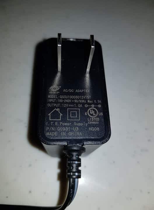

Your Dylos tester uses an unregulated DC supply. It's output voltage can range from about 13.7 VDC unloaded to 9 VDC at 500 mA load, and will be about 11 VDC when delivering 270 mA.

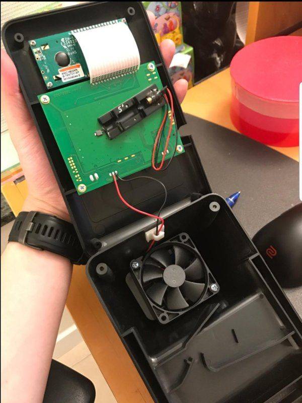

There must be one or more regulators within the Dylos unit, but I've been unable to find a schematic diagram for it so their nature can only be inferred. It has a fan to move air through the test chamber, a laser light source, a computer (and possibly other voltage or current sensitive components such as analog-to-digital converters).
I'd expect fan voltage is regulated (because speed variations would change the air volume, and hence the number of particles passing through the test chamber), the computer needs one or more regulated voltage supplies, and the laser diode will almost certainly have a current regulator.
None of these details are known to us, but what we can do it treat the Dylos as a "black box", measure applied voltage and current draw, and observe what the unit does. For example, it probably demands slightly more current from the supply when the number of characters increase on the LCD display. Does the fan and laser run all the time, or are they switched on only when a particle measurement is commanded? If the latter, it wouldn't surprise me if (as battery terminal voltage decreases too far) the tester would appear to be working fine, but operate strangely when the particle measurement is made.

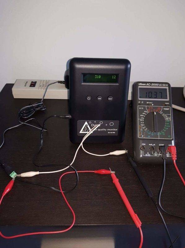

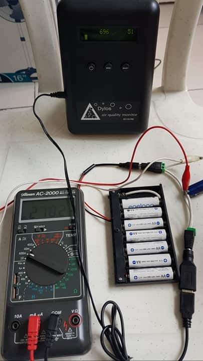

Just before the battery went dead..i noticed the values of the left goes to 3 times and the right 20 times.
Switching to adaptor. The values were much less and the same as prior to the burst of numbers.

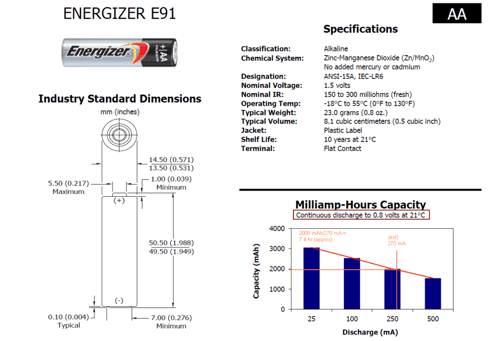

The voltage of the 6 pcs AA direct without the unit is 6.8 volts ( so each battery about 1.1 v)
Can you give examples of other devices that temporarily malfunction when voltage is very low.

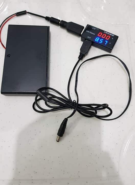

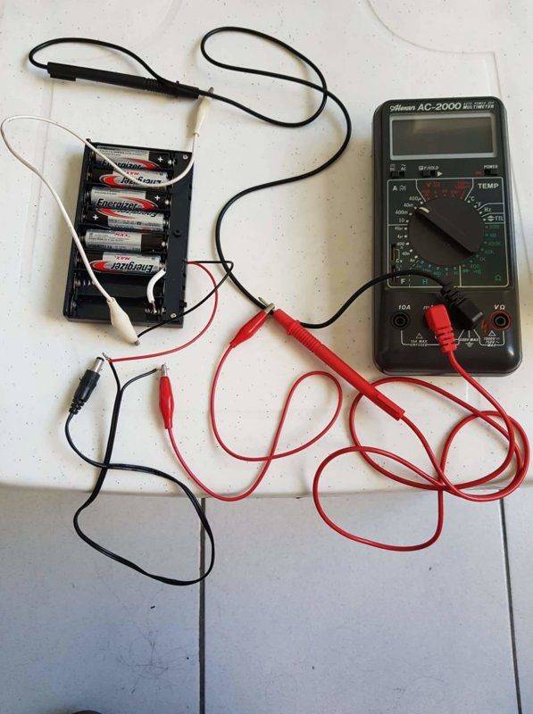

Is the following another way to measure the amperage. I don't use cardboard but connect the negative lead of the multimeter to the negative of the battery pack and the positive of the multimeter to the the negative of the plug? The positive of the battery pack is connected to the positive of the plug.
But when i plugged the Dylos. It boots with dim lcd and then go off. It means the voltage is not sufficient anymore. The ampere seems to read 300ma plus quickly instead of 270ma. Next time when i get new AA battery. Ill try to get the ampere to see if it would be below 270ma. Meanwhile I am using the 5v to 9v usb adapter and powerbank for quick reading.
Likes Asymptotic

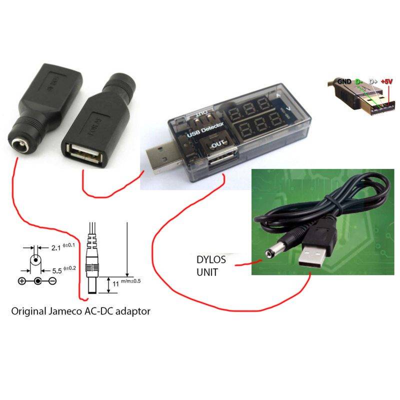

That broken adapter is bugging me for a while already. Could you please tell me the capacity of that powerbank?
If the product is just half decent, then there is no way it could break down so easily - unless it's about the dropping input voltage. Your device requires only (270mA @ 9V) 2.5W: to exceed the maximal input current of the adapter (supposed to be around 2.5A at least) requires the voltage on the powerbank to drop around 1V.
Still not a good explanation, since the protection should kick in way faster than that, but maybe an underdesigned, protectionless powerbank is a more probable...
  • #40

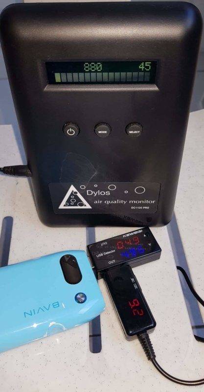

Hmm. Well. To summarize. I have 2 pcs of the 5v to 9v adapter. 1st got busted after 15 mins of use. So i only use it for 5 mins now when outside. Here is my powerbank.
Here is my power meter without anything plugged in:
Here is with the jameco adaptor not plugged into the unit (1.3watts):
When i plugged it to the dylos but not turning on the unit, its consuming some power 2.3 watts):
Here is when i turned on the unit 4.9watts):

9Ah should be able to supply that thing for hours. Was it plugged in the 2A output?
  • #42
Yup. Maybe the 5v to 9v usb adapter is only rated for 200mA.
  • #43
Not likely. The page you linked before has mentions for far higher loads, managed successfully.
Readout numbers on the left are small particle, and those on the right are the large particle count. The following is pure guesswork, but (provided the fan voltage supply, thus fan speed, is regulated)
when supply voltage drops below the point where that regulator no longer functions, the previously fixed fan speed will slow down to track with the reduction in supply voltage. Slowing the fan reduces both air volume and velocity through the test chamber.
From what I've recently read regarding laser-based particle count schemes, they determine particle count and size based on how many times the laser beam to photoreceiver path is blocked (count), and how much time it takes until the beam is sensed again (an indication of particle size). The unusual increase in large particle count due to low supply voltage would be consistent with a reduction in fan speed leading to reduced air velocity, and increasing the amount of time particles block the laser beam.
This observation suggests when battery open circuit voltage has dropped to 6.8V it is enough voltage to get the computer running, and (just barely) power the LCD display, but when the computer commands the laser and/or fan to turn on (increasing current demand decrease battery voltage) the voltage drops below what the computer needs to operate, and it shuts off.
You might observe a brief time of 300 mA+ current every time the unit is powered up. A fan requires more current to bring it up from zero speed to normal running speed (typically, one second or less) than it does to maintain normal running speed.
Likes chirhone

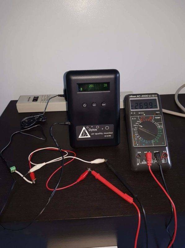

  • #48
The meter leads are reversed, and account for your negative current reading.
The (+) ammeter lead should be connected to the (-) lead from the battery pack, and (-) ammeter lead connected to the load.
  • #49
Rive said:
Current measurement at low range is usually through a fuse. Check the value/status - it is likely you smoked it.
You are right. The multimeter fuse is blown. I think something in the 5v to 9v adapter cause a surge to blow the fuse when the dylos was turned on. Anyway do you know a 5.5mm plug version of this so i can insert it between the jameco plug and dylos?

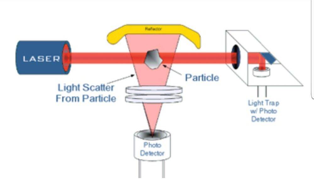

I want to focus now how laser based pm2.5 works in details. I am looking for paper or website that shows the full details which can include 16 channel GRIMM monitors that costs $25000.
I saw this in this page.
https://translate.googleusercontent.com/translate_c?depth=1&hl=nl&nv=1&rurl=translate.google.com&sl=nl&sp=nmt4&tl=en&u=https://www.fijnstofmeter.com/&xid=17259,15700021,15700043,15700186,15700191,15700259,15700271&usg=ALkJrhhlB_KukvpqefBEht4SEM4T9t9xvw
"How does a particulate matter meter work?
A particulate matter meter / particle counter works on the basis of the 'light scattering' or 'light blocking' principle. The air is passed through a measuring chamber through a fan. A laser beam illuminates the particles. The light that comes in contact with a particle is absorbed or scattered in specific directions. The direction of scattering is characteristic of the size of the particle, whereby the particle counter is able to determine the number of particles of a specific size."

You probably want to start another thread to discuss the inner workings of air particle testers. It strays far afield of the original subject of this one ("9V 0.5A battery pack").
I'd be in the same boat as you regarding answers on this question. The sum total of what I know about them was picked up along the way while researching how the Dylos is powered.

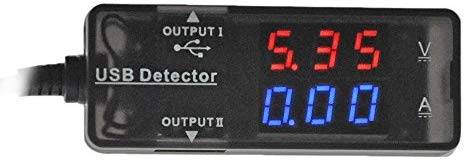

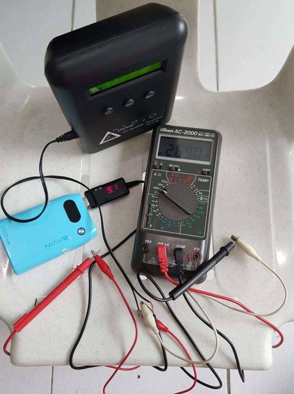

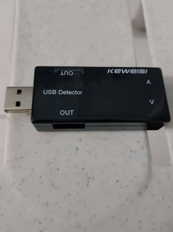

How accurate do you think is this?
I bought one and tried it on the 5v-9v adapter and dylos. But it showed 490ma instead of 269ma I measured using a multimeter.
Showing 490ma instead of 269ma using multimeter
Without any load, the usb ammeter is showing 0. Is it simply not accurate to show 490ma instead of 267ma?
  • #58
You are measuring 0.49 amps at 4.96V from the powerbank, and 9.1V at 267 mA output from the 5-9V boost converter to the Dylos load.
4.96V*0.49A = 2.43 watts
9.1V*0.267A = 2.42 watts
These power values agree to approximately 0.5%.
Likes chirhone
  • #59
Thanks. I didnt think of it. I thought it was simply unaccurate for small amperage. Now I am waiting for this connector from china.
Ill plug the jameco adaptor to its 5.5mm female. Then connect the usb ammeter to the above. And then use this to connect to the dylos.
It will work isn't it? This is to get the voltage and ampere from the jameco adaptor and unit itself.

Make a sketch of what you intend to do. If I'm following what you are saying I think the answer is no.
  • #61

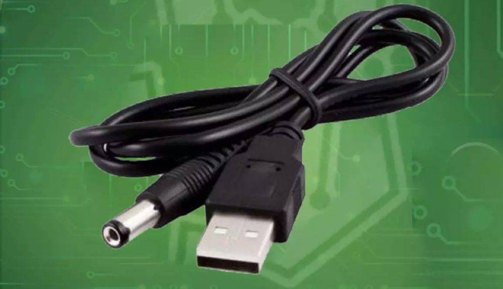

Why won't it work? I already have the male plug/USB in green and USB detector. I tested using continuity tester the outside plug of the green is negative with respect to the USB pins standard. I'm just awaiting the female USB connector (unless this polarity is reverse but conventional is negative is always the outside of the plug).
  • #62
This monitor isn't the one picture in earlier posts #45 and #49. If this Keweisi is the one you have
https://www.amazon.com/dp/B06X6K7NK9/?tag=pfamazon01-20
it lists specifications of:
. Input voltage : 3.0 - 9.0V
. Measuring current: 0.00 -3.00a
Unloaded, the Jameco supply voltage will be about 13.7V, and approximately 11V at 270 mA load. I don't know what the USB Detector will do if supplied substantially more than 9V. Provided it isn't damaged, voltage display is in x.xx format with what appears to be a fixed decimal point, and is at best is capable of displaying up to 9.99V
Likes chirhone

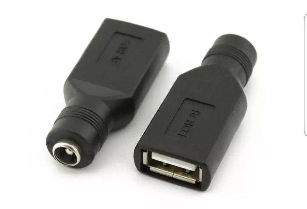

Thanks. I didnt think of the voltage limit. Checking this exact product i got
https://www.lazada.com.ph/products/digital-led-usb-charger-tester-amp-ma-charge-current-volt-meter-monitor-gauge-intl-i128640716-s138744448.html?dsource=share&laz_share_info=22615686_5_100_500042076257_15656003_null&laz_token=2f0e1830ecb3fb1494a00aa992bcdad7
I saw the voltage is only up to 8v! Thanks for the warning. I won't try it anymore. Do you know a similar configuration with larger voltage range? At least i could make use of the usb male and female connector by connecting my multimeter to the male below in the picture by cutting one wire of the pair. It would work either one of the pair when measuring ampere with the multimeter? Thank you.

About the link above. The actual unit shipped to me is the same one in your amazon link. Tnx for the real spec of up to 9v. I guess i can use it with the 6 pcs of AA for 9v and see if i can add one more 1.5v aa (without connecting it to the unit).

The multimeter reads 0.269A, not 0.267A. But after 10 seconds using the USB ammeter, it gets steady at 0.50A so the wattage is still close between the 2 testers.
Now let's combine the concepts in powerbanks, AA battery and AC charger. You wrote in message #30
"270 mA at 6.84V is 1.85 watts.
270 mA is a fairly high current draw for AA alkaline cells, and will provide about 7.4 hours service life at 270 mA continuous demand at 21°C per the Eveready E91 spec sheet."
The AA battery reads 270mA at 6.84.
The powerbank reads 269mA at 4.96v.
This is why i thought the unit draws 270mA constant. That's why I thought the 0,49A in the USB ammeter was wrong at 4.96V because i thought it should be a constant 270mA.
So is the 270mA at 6.84 using AA above and 269mA using USB meter at 4.96v above just a coincidence??
About the ac adaptor. You wrote in one site, it was reported at 220mA and this would give voltage of about 11v + (I read the entire thread many times to comprehend everything you said). I understand this current value is for the particular adaptor and not related to the current values in the powerbank and AA battery, right?
About the AC adaptor. I won't find a separate USB-like ammeter because I just need to know the voltage and current values once and the male and female usb connectors can give me means to measure it once.

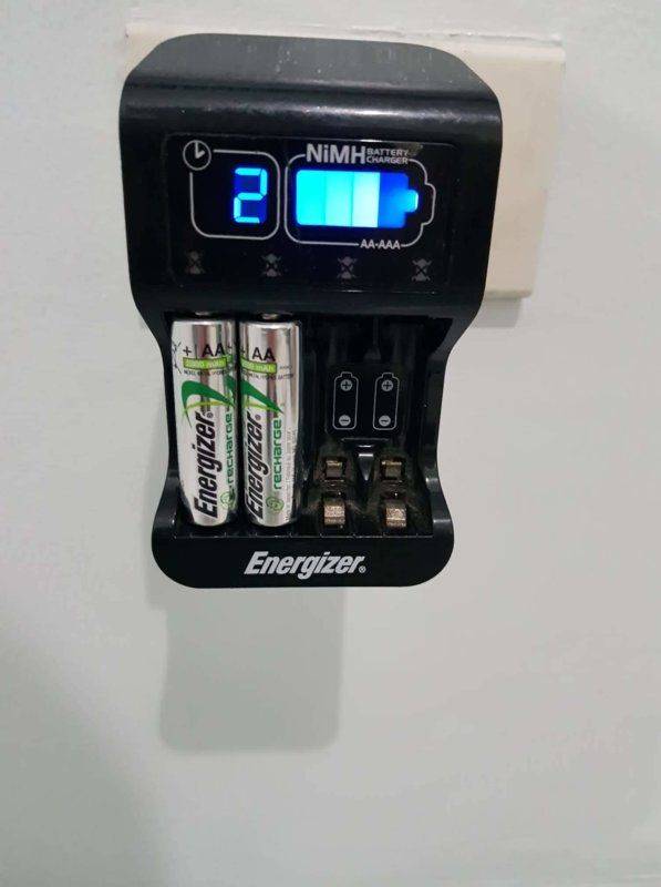

Btw... i found an old NiMH energizer charger in my old things and I think it still works. It has this specs:
http://www.emtcompany.com/energizer-chp41us-battery-charger/101322337.html
Do you believe that the USB ammeter can find great use in the AA battery pack to monitor when voltage gets down from 9v to 6v (discharge voltage)?
Let's wrap up all this battery thing for the Dylos because amazon has just refunded my cheap inaccurate china multi pollution meter today (see 1st msg in https://www.physicsforums.com/threa...ion-particulates-2-5-microns-or-below.983287/ ), giving me a go ahead to buy separate accurate monitors for Co2, and TVOC.
Appreciated so much all your battery tips. I can apply them to my Co2 and Tvoc testers if they don't use batteries. Thanks.

I finally measured the voltage and ampere of the jameco adaptor as you suggested. It's 10.36v and -269.9mA (see pictures above). Power is about 2.8watt. It's different from the powerbank 2.43watt. Conclusion? power is dependent on the source? Note the 6 pcs of AA battery measured also 270mA but 6.84v.
I connected the positive of the lead to the negative of the jameco adaptor terminal, why the display showed -269.9mA with negative? My last measurement will be the 6 pcs AA battery pack but for now they are all discharged already. Thanks for all tips.
  • #68
Well, that's a bit disappointing.
There are two basic types of voltage regulators: DCDC converters: this type is used in that USB-to-9V converter. This type keeps power as constant: you could observe that. The second type is 'linear regulator' , which keeps only current as constant: the one in your device seems to be this type. Although this type sometimes cheaper, especially in this low power range, it works with relatively high losses (the loss depends on the input voltage).
There is no consequence, just a remark.
By the way, based on the behavior of that regulator there is a high chance that your device would be able to work directly from USB - in case you would dare to disassemble and modify it o0)

Here is something puzzling. The wattage in the jameco adaptor output is 2.8w (10.36vx270mA). Powerbank is 2.43w, battery is 1.84w. If it can run it at 1.84w, the almost 1 watt is being dissipated inside the dylos or inside the jameco adaptor as heat? If inside the jameco adaptor. But i measured the wattage from the output of the adaptor.
Also for more info. Input no-load power of the adaptor is 1.3watts as shown in pictures a few days ago. Input power with load is 4.9watts.
