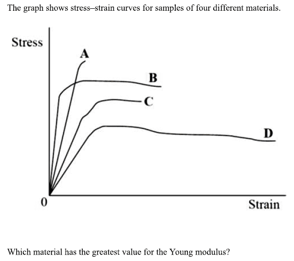

Which material has the greatest Young's Modulus?
The discussion centers on determining which graph represents the material with the greatest Young's Modulus. The initial conclusion was that graph B has the highest slope in its linear portion, suggesting it should be correct. However, the answer key indicates graph A is correct, leading to confusion about whether the entire graph or just the linear portion should be considered. Clarification from a source indicates that Young's Modulus is defined by the slope of the elastic portion of the curve, supporting the choice of graph B. This highlights the importance of focusing on the elastic region when calculating Young's Modulus.

Please see below
Young Modulus = stress / strain
My answer is (B) since it has the highest slope for the straight line part of the graph but the answer key is (A). Is it because the slope of graph B will decrease until the value less than slope A? So we don't only consider the straight line part but the whole graph?
Thanks
Thanks
According to https://en.wikipedia.org/wiki/Young's_modulus, it is the slope of the elastic portion (the linear part at the start) of the curve. That makes B correct.
