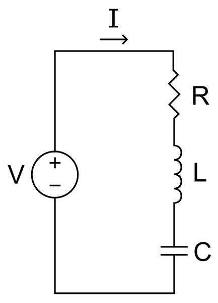

Okay, so I got thinking after reading all your posts and I thought, let me start at the beginning. So here's the story:
We have an RLC circuit, the wires of which are along an Amperian loop. Now, the changing B-field through the coil produces a non-conservative E-field, directed tangentially to the loop at all points (basically the shape of the circuit--a closed loop E-field). Now, the charges rearrange themselves to produce instantaneous conservative E-field to cancel the induced one.
Now, I'm a positive charge--say a proton-- sitting on the battery. I start my journey through the circuit. First, the battery gives me some potential. During my journey, I encounter an induced electric field that is always in the direction I'm going. (side note: I think Einduced should be (L*dI/dt)/length of the entire loop, irrespective of its geometry). As I move along, this E-field keeps taking away more and more of my potential. There is another, conservative E-field in my way, but its effects cancel entirely by the end of my journey. I encounter a resistance, that reduces my potential a bit, and a capacitor which does the same. By the time I have reached back to where I started, my potential is L*dI/dt less than what it was when I started.
Clearly $$\oint_C E \,dl$$ =L*dI/dt
Three observations:
1. What is so special about the ends of the inductor? It seems to me that wherever you place the ends of a voltmeter (one that measure the scalar potential, as @Charles Link and @Delta² agree), it should measure the same p.d.--L*dI/dt, provided there isn't a battery, capacitor or resistor in between. What kind of conservative field would produce a gradient with same same p.d no matter which two points you choose to measure it between?
2. Let's say the length of the Amperian loop is s Since the induced field, (refer to side note above) is (L*dI/dt)/s at every point. The difference in potential at the ends of the inductor should be $$\int_{}^{} E. dl$$ which comes out to be s'(L*dI/dt)/s, where s' is the length of the inductor's wire.
3. This elusive conservative E-field, must also be in a loop, except for a few chinks (where the capacitor, battery etc are). What the heck kind of charge distribution would produce this crazy field?
So, what say you?

The equations of circuit theory follow from Maxwell's equations. Let's take your example with an ideal inductance and a resistor in series and close a switch at ##t=0## connecting it with a battery. Then integrating Faraday's Law along the circuit you get (in quasistationary approximation)
$$L \dot{I}+R I=U_0.$$
Nowhere in this derivation you have to apply a wrong concept as interpreting the first term on the left-hand side as some "potential difference", but it originates from the application of Stokes's integral theorem using the definition of the self-inductance ##L##. The physics is that the magnetic field due to the current is changing such as to hinder this change (Lenz's rule), and this is all included in Maxwell's equations.
The general solution of the differential equation is the general solution of the inhomogeneous equation
$$L \dot{I}+R I=0 \; \Rightarrow \; I_{\text{hom}}=A \exp(-R t/L)$$
added to a special solution of the inhomogeneous one, which is obviously given by the stationary limit ##I_{\text{inh}}=U_0/R##. With the initial condition ##I(t=0)=0## you finally get
$$I(t)=\frac{U_0}{R} \left [1-\exp \left (-\frac{R}{L} t \right) \right],$$
i.e., due to the finite self-inductance of the circuit indeed the current is not suddenly switched on but builds up graduately with a typical "relaxation time" ##\tau=L/R## in accordance with Lenz's Law.
