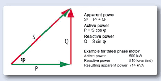

Why isn't Reactive Power defined as Q = S - P ?

Pretty much any electrical textbook defines reactive power pretty precisely... Q = Im{VI*}

I must try to find some source that doesn't just jump in, feet first with the 'power triangle'. There must be a lead in that justifies it better than just making assertions. Perhaps I shall have to reach for my pencil and paper.

I still must say, it strikes me as really strange that a diagram is drawn which involves a Mean Power and a Maximum instantaneous VI value. The coal that's shovelled into the boiler is somehow treated as the same as the extra spec needed for the components. Little wonder that 'they' tell you just to use the formula and 'get over it', without encouraging too much throught about what it all actually represents.
sophiecentaur said:
Reactive Power gives a general idea about the various stresses that poor PF subjects the supply equipment to. I find it interesting that such a simple formula gives such an aparently useful parameter for Engineers to work with.

sophiecentaur said:
No. Not me. Reactive power does represent a 'demand' on the system - otherwise no one would be bothered by it.
Now that's a strange comment. You yourself have made the point that Reactive Power doesn't come from the supply. The light bulb, itself is merely supplied with a Voltage and it 'chooses' how much current to take. If the tubne itself is purely resistive then the power that it consumes is V.I and that's what the power station needs to provide it with. The 'demand' that results from reactive elements in the load is not an Energy Demand; it just represents an overhead that's involved in extra current or volts associated with the generator (+ all the rest of the supplystuff).
If it is a Power Meter then it will only measure the in phase components of V and I. If your appliances happen to be very reactive, it will not be aware but still tell you the Energy dissipated per second.
It sounds like we are 'almost' saying the same thing much of the time but, I'll pause briefly to be sure I understand if and how PF affects my position.
I think though that we are not both thinking from the same reference point where my reference is inside my device whereas you are speaking from within the distribution network. If I am right on that point, then everything within the distribution/transmission realm would be part of that device.

S is the hypotenuse as pointed out by Hesch in post #2
