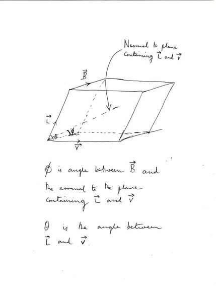

ElmorshedyDr. Shouldn't your book tell you what \theta means? Should you consider using a different book?
In fact the question of angles is not entirely straightforward, because three vectors are involved: \vec B, \vec v, \vec L. So two angles are needed to take account of all possible angles between the three vectors.
The thumbnail is my attempt to show this in three dimensions. The portion of the circuit emf due to L moving is equal to the 'volume' of the parallelepiped (wonky cuboid), that is: emf = Lv \mbox{sin} \theta \ B\ \mbox{cos} \phi. In this equation, Lv \mbox{sin} \theta is the area of the face of the parallelepiped containing the \vec v and \vec L vectors. Multiplying by B\ \mbox{cos} \phi gives the volume.
All this talk of areas and volumes is not needed if you are familiar with dot and cross vector products. Forgive me if you are.

  • #57
ElmorshedyDr. Did you study the thumbnail as well as the text in my post 53? It shows the angles involved, and answers the question you asked in post 51. I thought you wanted to know what the \theta meant in the formula you quoted. I have shown you.
  • #58
So according to your thumbnail Emf = Blv Cos Phi
  • #59
No, My text tells you that
emf = Lv\ \mbox{sin}\ \theta \ B \mbox{cos}\ \phi.
My thumbnail tells you what \theta\ \mbox{and}\ \phi mean.
\mbox{sin}\ \theta = 1 only if \vec{v} is perpendicular to \vec{L}.
\mbox{cos}\ \phi = 1 only if \vec{B} is perpendicular to the plane containing \vec{v} and \vec{L}.
