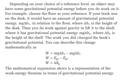

I found my textbook mentioning that about Work-kinetic:
So, do they mean that we shouldn't be applying W = PE2-PE1 and W = KE2 - KE1 in one scenario?
Also, this is how the book built up the W = PE2 - PE1 equation.
In this particular example there are two forces doing work on the book, the person lifting the book and gravity. Suppose the book is lifted at constant speed so that its kinetic energy does not change. Then
1. The work done by the person on the book is Wperson = + mgh
2. The work done by gravity on the book is Wgrav. = - mgh
3. The change in potential energy is the negative of the work done by gravity, PE2 - PE1 = -(-mgh) = + mgh.
In this particular example it turns out that the change in potential energy is also the work done by the person but that cannot be generalized into a rule. The rule is the change in potential energy is equal to the negative of the work done by conservative forces only. The force exerted by the person is not conservative but gravity is.
Likes aljan9559
