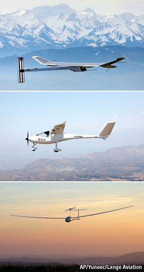

Oh man, I just read that the battery power will only allow it to hover for 6 mins before they are drained.
  • #74
For comparison, the total flight time of those novelty http://en.wikipedia.org/wiki/Jet_pack" is about 9 minutes. Total flight time (not hover) of this VTOL appears to be about 20 minutes (80 km / 240 km/h), with today's batteries. I expect a good idea would be to equip the VTOL with a small but very high density primary battery as a one-time emergency backup, maybe 2 minutes worth of flight time. The military might go with an all-primary, throw away battery set which would triple the flight and hover times immediately.

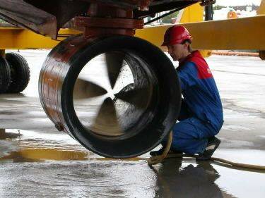

Though your flywheel battery pack did remind me of Cort Nozzles, which makes me wonder how much more efficient we could make props with such a device. I mean, when was the last time anyone saw an open framed turbine?
Ah ha! http://en.wikipedia.org/wiki/Ducted_fan" . Just what we were looking for.
Uh. Oh.
Turbofan engines are used on nearly all airliners, fighters, and bombers.
Did I mention that I know almost nothing about airplanes?

I believe mheslep mentioned that they'd weigh 11 tons. I don't think it would be desirable to have 11 tons of anything spinning.
This is my fault - bringing both the X prize and the small Puffin into this thread. 11 tons of battery was of course for the 850 mi leg of the X prize in semi-large aircraft. The two (Puffin/prize) really should be separated into different threads. Ron was talking about the Puffin I believe.

The dream weaver always makes it sound easy and simple, a fact I'm aware of.:biggrin:
Consider a cesna 310, just as an example, remove the big bulky ICE's and replace with the two electric power tubes.
These power tubes might be placed over or under the wing, and based on motor size will likely be less than 12" in dia. and long enough to hold a tractor prop in front and a pusher prop behind the wing, one on each side of the fuselage. The motors/generators in series inside the tubes.
The props (say six blades) have a composit ring of proper thickness and width, secured to each of the six tips, with batteries secured inside or, on the outside of the ring.
As I said before, it seems to me that thrust load and RPM of the props can be much greater, but this may in fact be false, being as I am not an engineer, finding the answers will be very hard for me if at all I can.
Ideas have to start somewhere, right? Lots of ring products in the market, I have not seen one on a real airplane.:rolleyes:

I doubt it. This is a speed contest, not a stay-aloft-a-long-time contest. Adding a bunch of wing adds a bunch of drag.
On any kind of aircraft at all I doubt if solar panels help for this one time, one trip contest. Panels might provide 8 kWh (10 M^2 x 200W/M^2 x 4 hours ), which is provided by 53 kg of rechargeable Li Ion batteries (150 Wh/kg), or 16kg of non rechargeable batteries. Dump the panels, go with extra batteries.

About the picture of the ring ducts, that is quite like what I was trying to describe only what I picture is smaller and not as bulky looking. Now if you can see in the minds eye those rings as part of the prop and in spin motion, they will store energy like a flywheel and I might dare say the drag of air flowing around and through them will be less than if motionless (?)
