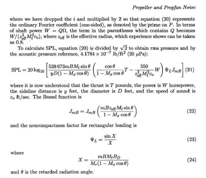

You asked for it. I scanned this in from one of my references. The mB notation refers to the mth harmonic/mode and B is the number of blades. The rest should be somewhat decipherable.
Thanks Fred!
Think I have it all except for theta, the 'retarded radiation angle'? I would expect the SPL is not isotropic, so maybe this is addresses the acoustic pattern?

  • #70
That is not a proper statement. It should read that the ENGINE noise is lower, not the overall aircraft noise. You can not change the acoustic performance of a prop by changing the thing that drives it. The prop noise will still be there.
  • #71
Right, the implication of the SIAM statement is that engine noise dominates in a helicopter w/ combustion engine. That's why I'm running down the prop noise alone. SIAM says its 50dbL at 150 M, a number that can be calculated (if I can define the terms :rolleyes:)
Assumptions per prop:
B (blades) = 4
y = sideline distance = 450 ft
D = 6 ft
T = thrust = 300 lbs takeoff
W = shaft power = 30 HP
c0 = 1000 ft/s
zeff = 0.8
I want worse case, so I'm bypassing all the modal analysis and setting the sincx and Bessel functions to one.
Edit:Still need help on defining theta? It can't be zero or the SPL is zero.
