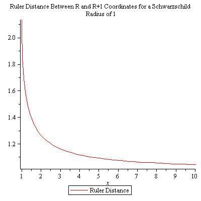

Now let's consider the case when the FRONT clock reaches the Schwarzschild coordinate: R = 2.
Then we can calculate the Schwarzschild coordinate of the BACK clock by solving:
[tex]
\sqrt {x \left( x-1 \right) }-\sqrt {2}+\ln \left( {\frac {\sqrt {x}+
\sqrt {x-1}}{1+\sqrt {2}}} \right) =1
[/tex]
This results in x = 2.757600642
It is perfectly understandable we do not get 3 because the ruler distances between R and R+1 increase for smaller values of R (See this graph https://www.physicsforums.com/attachment.php?attachmentid=28480&d=1285288006 ).

Oops, I see the problem, the formula is to get the ruler length is:
[tex]\sqrt {{\it ro}\, \left( {\it ro}-{\it rs} \right) }-\sqrt {{\it ri}\,
\left( {\it ri}-{\it rs} \right) }+{\it rs}\,\ln \left( {\frac {
\sqrt {{\it ro}}+\sqrt {{\it ro}-{\it rs}}}{\sqrt {{\it ri}}+\sqrt {{
\it ri}-{\it rs}}}} \right) [/tex]
Obviously if we use rs = ri = 1 then the formula can be greatly simplified.
I corrected the original posting accordingly.

OK, x-2 = 0.7576.. is the Schwarzschild coordinate length of stationary ruler of proper length L = 1 with its lowest point at Schwarzschild radial coordinate 2 (using units Rs=1).
If the stationary ruler is progressively reduced from 1 to a very small size, then the Schwarzschild coordinate length contraction factor of the ruler converges to [itex]\sqrt{2} = 0.707106[/itex] which is proportional to a gravitational time dilation factor of [itex]\sqrt{(1-Rs/2)} = \sqrt{(1-1/2)}[/itex] and is also equivalent to the velocity time dilation factor of SR when we use the escape velocity v which is equal to the local velocity an object obtains when it falls from infinity so that the length contraction of the stationary ruler is equal to [itex] \sqrt{(1-v^2)}[/itex] where the terminal velocity of the hypothetical falling object works out to be [itex]v=\sqrt{2}[/itex].

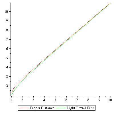

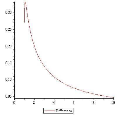

Anyway, none of this directly confirms what the coordinate length or the radar length of the falling ruler is according to any observer. That is what we need to find out.

What do you mean by reduced in size? Are you talking about a ruler's proper length? Or the length with respect to another observer?
Looking at the geometry of the Schwarzschild solution it appears we can put more rulers of proper length 1 between R and R+1 the smaller the value of R gets all the way towards the Schwarzschild radius.

Agreed, but the first thing I think we need to be sure of is the proper length.

Sorry, I should have been clearer here. I did not mean progressively changing over time. I meant if we chose a ruler with an initially shorter proper length, then the ratio of proper length to coordinate length converges to a ratio of 0.707106 for a ruler with one end at Schwarzschild radial coordinate 4GM/c^2. I.e this is the gravitational length contraction factor of an infinitesimal ruler at that location.
Agree, with the additional observation that even when R is exactly 2GM/c^2 the proper ruler length is always finite unlike the radar distance.

I am for the moment ignoring radar distances, not because they are not interesting but for clarity's sake, once the proper distance is ironed out, I like to talk about the radar distance.
Proper distance is hard to nail down. I like to think of it as the ruler distance when the ruler distance is measured by a series of very short rods that all calibrated by radar. Pervect explains this better here: https://www.physicsforums.com/showthread.php?t=431881
This ruler distance is a sort of average of the radar distance measured from one end and the radar distance measured from the other end. However, the proper distance defined as a physical ruler length may let us down when considering a free falling ruler. This has yet to be determined.
One thing I am fairly certain about from discussions in other threads is the proper distance between two points is not the distance measured by a CMIRF.
