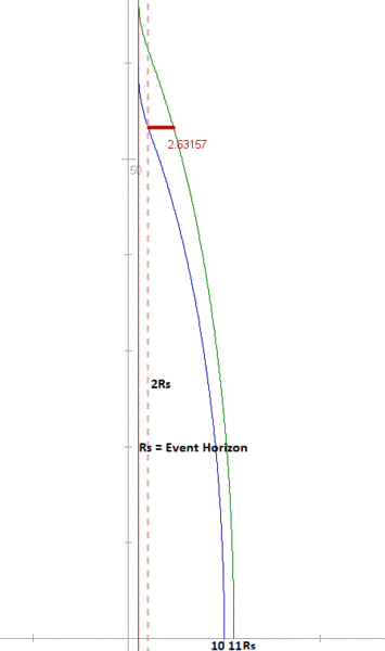

  • #64
Passionflower said:
Actually as I explained with 'time to ultimate doom' the fall from infinity is not a problem at all. We can pick any starting coordinate we want and assume both the front and the back came from infinity. This approach I think has several advantages, not it the least that once we have the right formula we can then express it in terms of proper time left and take it down past the event horizon as well.
The problem is that the equations you gave for "time till doom" do not give the coordinate falling time.
Well that is encouraging, so say we start from R=10 (but they come free falling from infinity - I would not like the inattentive reader to claim I make yet another mistake), and then take it down a coordinate time of 5 and then all we need to do is take the back down from R=11 with the same coordinate time. And that would be our falling two coffee grind particles including a tidal stretching freebie?
As I said before, it is probably easier to relax the fall from infinity requirement (although we might try that later) and assume a drop from initially at rest from a finite height.
After a coordinate time of 5 the leading clock will have fallen to 9.99437 and in the same coordinate time the trailing clock will have fallen to 10.953 and the coordinate gap will have increased from 1 to 1.009 if both particles were initially at rest and released at the same coordinate time from heights 10 Rs and 11 Rs.
It is a bit more interesting if you let the particles fall further.
If we start with the same release heights and let the leading particle fall to height 2 Rs then the coordinate fall time is 2.64 and trailing clock is at 4.64 Rs.
I am using the equations given in post 48 to obtain these results, but I have to numerically solve them as the mathematical software I use is unable to find a symbolic solution for r when t is know.
Here is a list of results for various initial and final heights for the trailing clock, all with the leading clock starting one coordinate unit lower and end point determined by the leading clock arriving at 2 Rs.
11 : 4.64
101 : 9.81
1001 : 21.86
10001 : 48.42
100001 : 105.987
1000001 : 230.22
10000001 : 498.02
100000001 : 1075.06
1000000001 : 2318.31
Very approximately, each tenfold increase in the initial drop height results in a two fold increase in the coordinate separation at the end point.
Is everybody absolutely sure it is really that simple? If so then if we take the proper distance pre and post we can simply subtract the pre proper length from the post proper length and voila we have a difference in length in terms of R coordinate distance and coordinate time (and then of course we can also calculate proper distance and proper time for each grind perspective as well).
No, it is not that simple. All we have done is determined the coordinate separation of the unconnected free falling particles. We have still not determined the proper separation of the freely falling particles in the rest frame of the particles and I not even sure at this point if it is possible to define what that is. It is as you probably already aware, very difficult to operationally define the proper length of the falling particles for non infinitesimal separations. It does however give an indication of the tidal stretching in coordinate terms.
The attached diagram is a graph in Schwarzschild coordinates of the objects falling from 10 Rs and 11 Rs.

  • #67
11 : 4.64
101 : 9.81
1001 : 21.86
10001 : 48.42
100001 : 105.987
1000001 : 230.22
10000001 : 498.02
100000001 : 1075.06
So, according to the above, the distance between particles increases. In the previous post (#62), you were arguing that the distance decreases. Which one is correct?
