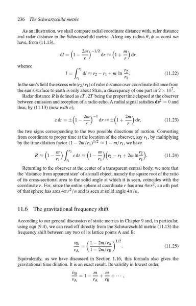

Since I remember you have Rindler (2nd edition) take a look in chapter 11.5 page 236 at the top you see the integral for ruler distance. If you make 2m=1 you get exactly the same integrand as I use.
I attached an image of the page in question.

Thank you, I had a look. You are misunderstanding chapter 11.5, it has nothing to do with free-falling particles. If you want to learn about free-falling particles (falling from a fixed distance or from infinity), this comes up later, in chapter 11.8.
As I wrote before you should really read carefully:
Check my posting https://www.physicsforums.com/showpost.php?p=2915076&postcount=99 again.
I quote myself from that posting:
Passionflower said:
Since the proper distance from r1 to rs for a stationary observer (vlocal=0) is:
<br /> <br /> \int _{1}^{r_1}\!\sqrt {1-{r}^{-1}}{dr} = \sqrt {r \left( r-1 \right) }+\ln \left( \sqrt {r}+\sqrt {r-1}<br /> \right) <br /> <br />
As I said read carefully before you call wrong.

...which is just as wrong since, in this case, the correct integrand is:
ds=\frac{dr}{\sqrt{1-r_s/r}}=(1+r_s/(2r))dr
(see Rindler 11.5)
Since you used the wrong integrand, you also obtained the incorrect integral. If you did it right, you would have obtained a much nicer formula:
\Delta S=r_2-r_1+r_s/2(ln(r_2)-ln(r_1))
The above is a transcendental equation in r_2-r_1, so, it cannot be solved symbolically. The only thing one can say with certitude is that
r_2-r_1&lt;\Delta S
i.e. the coordinate length is less than the proper length.
With r_s=1 you should get:
r_2-r_1+1/2*(ln(r_2)-ln(r_1))=r_2-r_1+ln(\sqrt{r_2/r_1})
Anyway, if you want a comparison between coordinate, radar and proper distances, then Rindler 11.5 gives the answer to your question.
You need to pay attention, the above derivation applies only for a static (unmoving) rod, so all your attempts at using this kind of math, do NOT answer the case of a falling rod, as described in your OP. If you want to find out the length of a ruler falling radially in a gravitational field, then 11.5 is not your answer, you need to proceed to 11.8. A much more difficult problem as I tried to point out to you several times. If you want to know how to answer the problem of a moving rod, then you need to start with the integrand I gave you a few times already.
