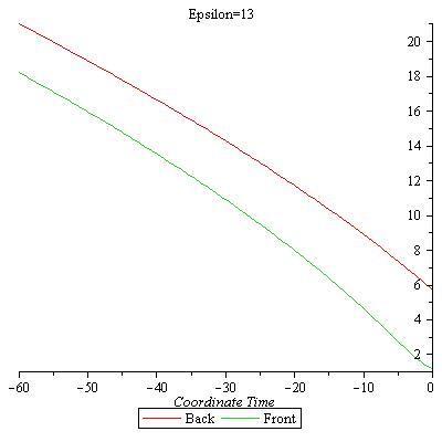

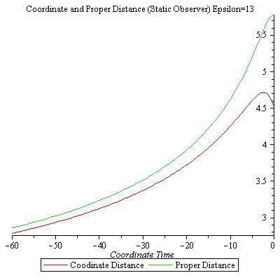

My error
<br /> \sqrt {r \left( r-1 \right) }+\ln \left( \sqrt {r}+\sqrt {r-1}<br /> \right) <br />
works just fine. And I think I see how to sketch out a solution that most of us will agree with.
(It appears that some other people wrote up similar ideas while I was writing this - and it appears that if yuiop agrees with me, strathaus will claim he's wrong, so I don't expect universal agreement ::smiley face::).
If we take r_s =1 or M = 1/2, and R = infinity, we can use the simpler equations MTW 25.38 to find the Schwarzschild t coordinate as a function of the r coordinate. It also gives us proper time, \tau, though we don't really need it.
<br /> \tau = -\frac{2}{3} \, r^{\frac{3}{2}}<br />
<br /> t = -\frac{2}{3} \, r^{\frac{3}{2}} - 2 \, r^{\frac{1}{2}} + ln\frac{r^{\frac{1}{2}}+1}{r^{\frac{1}{2}}-1}<br />
Now, all we need to do to make this a one-parameter group of curves is to use time-translation symmetry. We simply add some small number \epsilon to the schwarzschild time coordinate to represent the second particle, which works because of the time-translation symmetry of the metric, in fancier language \partial / \partial t is a "Killing vector". So we have
<br /> t\left(r, \epsilon\right) = -\frac{2}{3} \, r^{\frac{3}{2}} - 2 r^{\frac{1}{2}} + ln\frac{r^{\frac{1}{2}}+1}{r^{\frac{1}{2}}-1} + \epsilon<br />
Assume that the leading edge of the rod, with the parameter \epsilon =0, has some r-coordinate r_0 at some t-coordinate t_0.
Then we need to find the radial coordinate r_1 of the trailing rod at the same time coordinate t_0 by solving
<br /> t\left(r_1, \epsilon) = t_0 = t\left(r_0, 0\right)<br />
i.e.
<br /> -\frac{2}{3} \, r_{1}^{\frac{3}{2}} - 2 r_{1}^{\frac{1}{2}} + ln\frac{r_{1}^{\frac{1}{2}}+1}{r_{1}^{\frac{1}{2}}-1} + \epsilon = -\frac{2}{3} \, r_{0}^{\frac{3}{2}} - 2 r_{0}^{\frac{1}{2}} + ln\frac{r_{0}^{\frac{1}{2}}+1}{r_{0}^{\frac{1}{2}}-1} <br />
Then we use
<br /> \sqrt {r_{1} \left( r_{1}-1 \right) }+\ln \left( \sqrt {r_{1}}+\sqrt {r_{1}-1} \right) - \sqrt {r_{0} \left( r_{0}-1 \right) } - \ln \left( \sqrt {r_{0}}+\sqrt {r_{0}-1}<br /> \right) <br />
to integrate between r_0 and r_1 to get the length as seen by a static observer for the falling rod. To get the proper length, we multiply by gamma, based on the radial velocity which we know is 1 / \sqrt{r}.

Then we use
So far I have only skimmed your solution, but broadly it seems a reasonable approach. One small observation is that the last part where you suggest multiplying by gamma based on radial velocity, there seems to be the minor problem that for an extended string of particles, the velocities will be different (I think) depending on where the particles are located. Are you proposing a sort of average velocity or having an arrangement where the particles fall at the same velocity or simply relying on the spatial separation being small enough that differences in individual falling velocities is insignificant?
[EDIT] After a quick re-read I now think you mean the last one because you have specified a small separation. [/EDIT]
Forgive me if I have missed anything significant. This is just a first pass on your proposed solution.

  • #175
i.e.
I am running some numbers to verify I understand it.
If we take the front clock at R=40 we have 180.9850160 time units left.
Now let's take an epsilon of 13 time units, this will give us a back coordinate value of R=41.98100155. Thus the coordinate distance between the front and the back is 1.98100155 which gives a proper distance (for a static observer) of 2.005621996. The two are not identical due to the curvature of spacetime.
I calculated r for t=-60-0 for the front and t=-73-13 for the back and plotted the results. I also calculated the coordinate and proper distance (for a static observer).
Now I do see a stretch both in coordinate and proper time. Is this the tidal stress? One problem with this approach is that we cannot run this past the event horizon, the major spaghettification happens closer to r=0, rather than changing coordinate charts is there any way we can use proper time for this?
