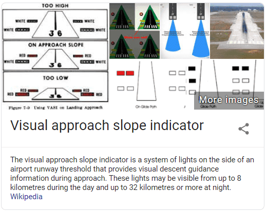

The process of landing starts several miles before the runway. The pilot slows the airplane to the proper speed, puts the landing gear down, puts the flaps down, and lines up with the runway. A typical speed when getting close to the runway is 30% faster than stall speed, or a little faster in rough conditions. They fly a prescribed slope. In good weather, there are visual indicators in addition to knowing the proper sight picture. In bad weather, they have an electronic glide slope.
All airplanes, from a two seat Cessna to a huge Airbus A380, fly the same slope, although at different speeds.
In modern airplanes, the pilot can see the runway ahead when flaring for a landing. That was not the case for many pre World War II small airplanes, where the pilot needed to have good peripheral vision and situational awareness.

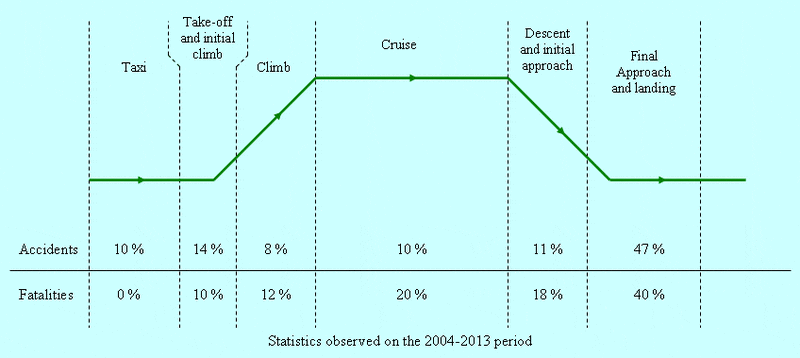

seazal said:
About a decade ago. I rode an airplane where inches away from touchdown, it took off again with full afterburners (?) on...
No, commercial airliners don't have afterburners. That was just full power.
What phase of airplane riding are you concerned the most? Or do you just avoid riding airliner?
I love flying and fly as much as I can (I'm currently taking lessons), so I don't get "concerned" in normal situations. But statistically the landing is the most dangerous:

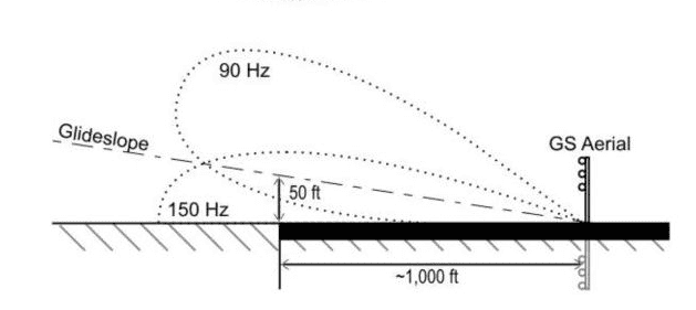

seazal said:
What is the " "?
ILS ? "Instrument Landing System"
a narrow, directional radio beam broadcast from the airport.
If the plane flies right along the beam it'll wind up at the end of the runway at correct altitude.
there's an indicator on the panel something akin to this
pilot flies the plane to keep the two needles in the circle
i tried it a time or two and decided it's a job for the autopilot...

seazal said:
The conversations is "Activate the " " system, re calibrate sea level to minus -200 feet"
What is the " "? All airliners have it too? or just fiction?
ILS: Instrument Landing System. There is a screen in front of the pilot with a set of crosshairs that when centered keep the plane on the glideslope. Yes, they all have it.
https://www.skybrary.aero/index.php/Instrument_Landing_System_(ILS)

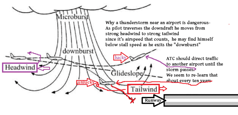

seazal said:
I don't come across airplane that stalls and falls down during landing.
Airline disasters are always like dominoes - several little things align and something sets them in motion.
this has caused more than one stall
(annotations mine)
google "windshear"
Let's just say this guy's stall speed is 70
if pilot enters the storm with airspeed of 100
and headwind is 25
his ground speed is 75,
5 above stall. which sounds ok
but it's airspeed that makes lift not groundspeed...
When he transitions from 25 headwind to 25 tailwind with ground speed still at 75
his airspeed falls to 50
so he's at 20 less than stall speed and is in trouble
http://www.aviation-accidents.net/tag/windshear/
If you're interested in aviation you might enjoy Ernest Gann's book "Fate is the Hunter"
a retired airline captain, he wrote his memoirs and discusses such things..

4) Most accidents occur during take off or landing. You would have to be wearing your chute and stood by the open door waiting to jump just in case. And what if you can't jump because you are too low before realising there is a problem? You would be safer strapped into your seat.
