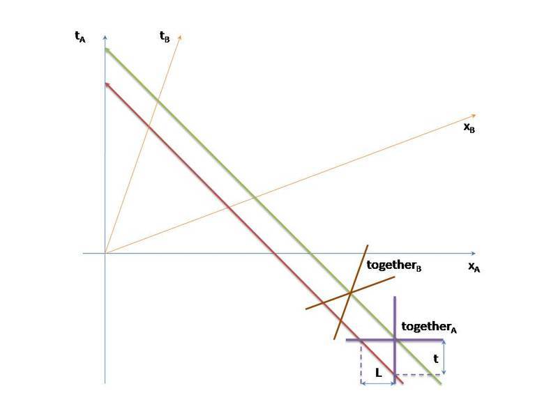

  • #156
Jesse,
Attached is a diagram of the sort of situation I had in mind.
Note that I don't have the events which created the photons we have been discussing (red and green arrows, at 135 degrees from the tA axis. The events could have taken place millennia ago, really all that I am concerned about is the separation between the arrivals of the photons.
The diagram is in drawn in terms of the A frame.
B is moving towards where the events took place, which means that B intercepts the photons before A (in any frame) and B is closer than A to where the events took place (in any frame).
Down in the bottom right hand corner is an indication of what A and B would take to be "togetherness" for events which could have produced the photons.
Note that initiating events that were 1) together spatially for A and 2) could have produced the photons are further apart temporally than intiating events that were 1) together spatially for B and 2) could have produced the photons. This is true in any frame.
Note also that initiating events that were 1) together temporally for A and 2) could have produced the photons are further apart spatially than intiating events that were 1) together temporally for B and 2) could have produced the photons. This is also true in any frame.
Remember in the first post in this subthread, I said that the delay of t between the arrivals of the photons meant that, to have been emitted together, they were either emitted with a delay of t from the same location (relative to A) or simultaneously with a separation of L (relative to A). These values are also marked in the bottom right hand corner.
Now the thing that concerns me is that if I were to plug your figures into my drawing, I don't think I would arrive at 16 seconds between the arrival of the photons for A and 8 seconds between the arrival of the photons for B. I'd arrive at 16s and 12.8s.
Clearly something is wrong somewhere, either with my understanding, my explanation or your assumptions.
cheers,
neopolitan

  • #157
neopolitan said:
Jesse,
Keep in mind that if you draw 1-second ticks along A's time axis and 1-light second ticks along A's space axis, then also draw similar ticks along B's space and time axis, then when drawn from the perspective of A's frame, B's space and time axes are not merely rotated versions of A's, in A's frame the distances (in the diagram) between ticks on B's axes are greater than the distances between ticks on A's axes. You can sort of see this if you look at the diagram from post #5, where in the diagram from the unprimed perspective you can see that the distance between pink events on the light blue space axis of the unprimed frame is just 4 light-seconds, and the distance between pink events on the yellow time axis of the unprimed frame is 4 seconds; but in the diagram from the primed frame, the light blue and yellow axes are not only slanted, but the distance along these axes between the same pink events also looks stretched (and the location of the three pink events in both frames was calculated using the Lorentz transform so I know they're correct).

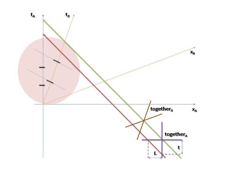

  • #159
neopolitan said:
You mean like this?
Yup, like that (assuming the angle of the dotted lines isn't supposed to have any meaning), and same for the x-axes obviously.
  • #160
I thought about that shortly after I posted the drawing. The angle of the dotted lines, if they were to remain should be 135 degrees (signifying the speed at which a photon or information could reach A and assuming a c=1 sort of relationship between the x and t axes).
(The following is off-track somewhat.)
Now as I wrote it, I realized that "the speed at which a photon or information could reach A" is maybe a little misleading. It's not really that the photon is traveling to intercept A. It's more like the photon is everywhere (and everywhen) along its worldline and there is just a question of when and where the path of A through spacetime intersects that photon relative to when and where the path of B does, and vice versa.
That sort of thinking would upset Tam Hunt ... since unless you somehow shake off causality, it makes the universe highly deterministic - and predetemined at that. If a photon is everywhen along its worldline, and millions of years from now (in my frame, for want of a better frame) that photon is going to hit a descendant of mine, then does that mean that my descendent is predetermined? Note: I know that, without some very special conditions, a photon that I am colocated with will never be colocated with any decendant of mine. Less extreme though, I could trap a number of photons between two mirrors, leave them for a day and come back, then release them. Would my return to release the photons be predetermined by the abrupt end to the worldline of a number of the photons when they are absorbed by my inquisitive eyes?
cheers,
neopolitan

  • #163
neopolitan said:
Right, now on to my thought. We do agree, I hope, that in 4-space individual events all have a unique location, albeit differently identified by different observers. By this I mean that while two inertial observers may have different x,y,z and t values for an event, this does not mean that the event takes place at different 4-space locations.
In the same sense that dots on 2D surface like a sheet of paper or a globe have a unique location on that surface even though they can be assigned different coordinates in different coordinate systems drawn on that surface, right.
neopolitan said:
In light of this, I want to confirm that the diagram I posted is correct.
In A's frame, A is moving along the tA axis at a rate of one second per second while B is moving at an angle to the tA axis such that the gradient of the line is given by 1/v.
With the "gradient" defined as \frac{\Delta t}{\Delta x}, yes.
neopolitan said:
I have to admit that I initially thought of B moving along what B takes to be the xB axis. I see clearly that this is wrong, since that would equate to a speed greater than c. (I was thinking of an F(x) graph, where you plot F(x) on the vertical axis and x on the horixontal axis. This diagram shows an F(t) graph, where F(t) is on the horizontal axis and the gradient is therefore t/F(t) = 1/v, rather than v as I had in mind.)
B is actually moving along the tB axis, according to A, correct?
Right, the tB axis represents B's worldline.
  • #164
Ok, a new attempt. I am using a more rigorous diagram, using the figures you like, ie B is moving at 0.6c relative to A, and plotting numbers obtained from Lorentz Transformations. The green lines are the world lines of photon which pass the ends of the moving rod.
I'm just wondering, where is length contraction?
(I think I might know where it is, but drawing it clearly is difficult.)

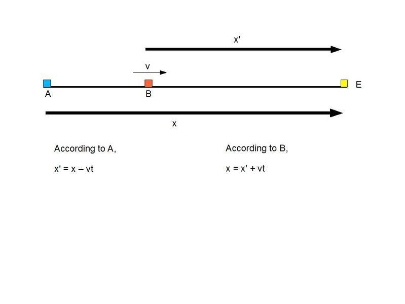

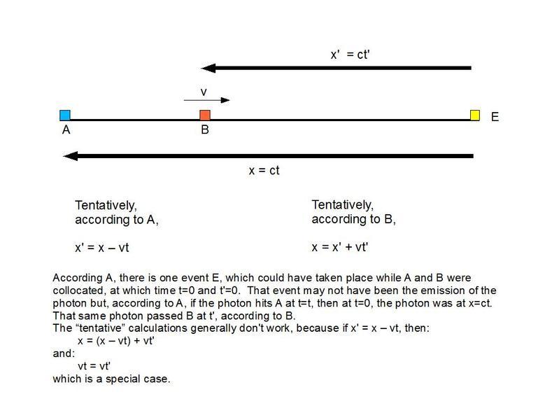

I've been in trouble for showing alternative derivations before.
Nevertheless, the situation I am thinking about is analogous to the diagram with a red and green photon worldline, but with one photon which could have come from anywhere (along its path) and any time. Two observers are initially colocated, one travels away at v, and the photon passes one observer then the other one.
The observers consider themselves to be at rest and the other to be moving. Both assume that the event that spawned the photon occurred when they were colocated with the other observer. Each observer will come to the conclusion that the spawning event occurred at x=ct (x and t in their own frame).
Using Gallilean boosts (ie ignoring relativity), both observers would calculate that x'=x-vt (where v is negative in one instance and x' is the distance in the other frame).

See the three diagrams, numbered:
1 (Galilean boost),
2 (one photon passes B, then A - indistinguishable from a photon from Event E - Galilean boost not applicable) and
3 (part of the way to Lorentz Transformations).There are six numbered equations in diagram 3.
Put (5) into (6) or (6) into (5) and you have:
G = \gamma ... (7)
Put (7) into (1) and you have "SAFTD".
Put (7) and (4) into (2) and you have the spatial Lorentz Transformation.
Because x=ct and x'=ct', then you just divide through by c to get TD and the temporal Lorentz Transformation (noting that t/c = x/c2).

  • #175
Some clarifications to the last post (done in the early hours of the morning).
G to E 01 - (Galileo to Einstein) - shows the standard Galilean boost. There is an assumption of instantaneous transfer of information (or god-like powers to see everything at once).
G to E 02 - shows what happens when you remove the assumption of instantaneous transfer of information. E is an "event". I stress that it could be something that causes the emission of a photon, or it just could be an event along the path of the photon. A and B see the same photon (thought experiment magic).
G to E 03 - shows the reconciliation, with subscripts to show "according to ..."

  • #177
While awaiting a response on https://www.physicsforums.com/showpost.php?p=2165684&postcount=174". That diagram only showed length contraction (LC).
I have developed three more diagrams, one for time dilation (TD), one for spatial analogue for time dilation (SAFTD) and one for temporal analogue for length contraction (TAFLC).
In each of the diagrams I have tried to be consistent with the use of colours. I hope that the sheets (light blue and light orange) are easily understood. Trying to explain briefly, depending on what is being shown:
the blue sheets have a spatial of L or a temporal width of 1 tick in the A frame
the orange sheets have a spatial width of L or a temporal width of 1 tick in the B frame.
The darker blue bar shows either a length L or the period between two consecutive ticks in the A frame. The darker orange bar shows either a length L or the period between two consecutive ticks in the B frame.
The green bars show measurements by A of a length or period in the B frame.
The purple bars show measurements by B of a length or period in the A frame.
For completeness, I will repost JesseM's diagram (which contains some of the information, but not all).
cheers,
neopolitan

  • #178
neopolitan said:
It seems that I can't post diagrams at the moment. So, I have posted them all on one web page http://www.geocities.com/neopolitonian/index.htm".
The labels on the time dilation diagram appear to be backwards. You label the purple segment the time dilation of B looking at A, but that appears to be the time dilation that A sees when it looks at B's clock--it's the difference in A's time coordinates between two events on the worldline of B's clock that are separated by 1 second in B's frame (and the height of the purple segment is greater than 1 second in A's frame, hence the 'dilation'). Likewise, the green bar seems to show the time in B's frame between two ticks of a clock at rest in A's frame, so that should be "time dilation of B looking at A" rather than "A looking at B". Unless I'm misunderstanding what "looking at" is supposed to mean (I interpreted 'A looking at B' to mean how B's clock behaved in A's frame).

  • #180
Time dilation continues to be a problem.
What the diagram tried to show is a value seen from the A frame (from the A frame, ticks are all colocal) such that tB = gamma.tA. Since someone said a while back:
JesseM said:
The usual convention is that the unprimed t represents the time interval between two events on the worldline of a clock as measured in the clock's rest frame (so both events happen at the same spatial location in the unprimed frame, and t will be equal to the time interval as measured by the clock itself), whereas the primed t' represents the time interval between the same two events in a frame where the clock is moving (so the events happen at different locations in the primed frame).
That means that, according to A, tB = t' and tA = t, therefore:
t' = gamma.t
which is time dilation.
I could learn to like time dilation more if the stretching of the time axis in B's frame is time dilation and/or I am allowed to explain something like this:

JesseM said:
In this diagram G to E 02, I take it t refers to the time in A's frame the light reached A, and t' refers to the time in B's frame the light reached B? If so it also seems that x refers to the position of the photon at t=0 in A's frame, while x' refers to the position of the same photon at t'=0 in B's frame (because of the relativity of simultaneity these must refer to different events on the photon's worldline). So in each frame you're calculating the distance and time between a totally different pair of events, correct?
One photon. One event spawning the photon. Two events where the photon passes B, then A. One event when A and B were colocated and t=0 and t'=0.
A thinks that at colocation, the photon was located at x=ct.
B thinks that at colocation, the photon was located at x'=ct'.
What is the relationship between x' and x, and t and t'?
Does that help?
What we do know is that, irrespective of coordinate system, when A and B were colocated, the photon had one unique location. Correct?

The light coloured sheets are simultaneity planes, if you like:
The light orange sheet is 1 tick.gamma in the A frame, spanning 1 tick in the B frame.
The light blue sheet is 1 tick.gamma in the B frame, spanning 1 tick in the A frame.
If you must have events, the light orange sheet shows all the events which are simultaneous in the A frame with two consecutive ticks of B's clock, and all the events between. In the B frame, the two consecutive ticks are 1 tick apart and not simultaneous with all the other events which constitute the boundaries of the light orange sheet. In the A frame, the two consecutive ticks are 1 tick.gamma.
The light blue sheet shows all the events which are simultaneous in the B frame with two consecutive ticks of A's clock, and all the events between. (And so on.)
JesseM said:
Maybe the two events you're thinking of are not 1 and 2 on B's worldline, but just the events which actually lie at the endpoints of the purple line? But then the bar is confusing because it doesn't help you show the time between these events in B's frame, you should instead draw a slanted bar (like the light blue one) whose top and bottom cross the events at the top and bottom of the purple line, and then see where this slanted bar intersects B's time axis, which would give you tB for these two events.
The purple line just shows the time between the events which are simultaneous in the A frame on clock which is at rest with A but not colocated. Any point along the sheet will do.
tB for these two events is already shown on the tB axis. That's why the light orange sheet spans two consecutive ticks on the tB axis.
JesseM said:
But I'm not sure you're clear on the fact that we always have to have a fixed idea of what two events we're talking about in advance before we can use the time dilation equation, which is comparing the time-interval between those specific events in both frames (one of which is the frame where they are colocated, which is normally labeled as the unprimed frame).
We don't really need two specific events. We can use simultaneity sheets. It might not be immediately obvious, but you can do it.

  • #184
Right, that's what I figured.
Yes, and those two consecutive ticks are events 1 and 2 on B's worldline, as I suggested. In this case tA for these events is 1.25 and tB is 1.
Yes, here I assume the two events would be on either end of the dark blue line, the events labeled 2 and 3 on A's time axis. In A's frame tA for these events is 1, while in B's frame tB for these events is 1.25. Can I assume it's this pair of events, and the time between them in both frames, that you were referring to when you said "What the diagram tried to show is a value seen from the A frame (from the A frame, ticks are all colocal) such that tB = gamma.tA"? But in this case the time dilation occurs in B's frame, so I still don't really understand why you labeled the green line "time dilation A looking at B" rather than "B looking at A".
They're not colocated with the clock at x=0 in the A frame, but the two events are colocated with one another in A's frame.
But the light orange sheet shows the events on B's t-axis that are simultaneous with the events at either end of the purple line in A's frame, not in B's frame. The event at the bottom of the purple line does not occur at t=1 in B's frame, and the event at the top of the frame does not occur at t=2 in B's frame. Nowhere in the diagram do you show points on B's axis that are simultaneous with the events at the top and bottom of the purple line, so the diagram just doesn't show tB for those particular events.

  • #185
I find time dilation really awkward. It seems I am not alone.
Can you step back, momentarily and just follow this and see if it is right?
Two events on the tA axis are consecutive ticks of a clock, so tA = 1 tick.
These two events are simultaneous in the B frame with two events on the tB axis which are separated by tB = 1 tick.gamma.
Assuming a gamma of 1.25, if tA = 1s then tB = 1.25s
Is that right?
Now the unprimed frame is that in which ticks are colocal. The primed frame in that in which ticks are not colocal.
If we take the A frame as our reference point, the A frame is the frame in which ticks are colocal and the B frame is the frame in which ticks are not colocal.
Therefore, tA = t and tB = t'.
Therefore t' = tB = tA.gamma = t.gamma, or
t' = t.gamma
Which is your time dilation equation from the A frame, considering the B frame, or "A looking at B".

I have done another couple of diagrams, showing Galilean relativity. These diagrams kill two birds with one stone, since they hopefully show that maybe I was right about instantaneous transmission of information being an issue - keeping in mind that the Galilean boost is:
x' = x - vt
(not x' = x - vt')
They are http://www.geocities.com/neopolitonian/gal_rel_JesseM.jpg".
That aside, look at the separation between the ticks of the B clock in Galilean relativity (either diagram). If the tB axis is imagined as a wiper and swung around to line up with the tA axis then the ticks are further apart. Now go back to the original time dilation diagram and keep in mind the comment about the tB axis being stretched.

  • #186
Is that right?
Yeah, all that is right. But if you're drawing things from the perspective of the A frame, you may find it less awkward to think about ticks on a clock which is moving in the A frame, and the time between them in the A frame (switching all the A's and B's in your explanation above). If two events on the B worldline are separated by 1 second in B's frame, then the time between these events in A's frame--which is just the vertical distance between the events in the diagram--is 1.25 seconds.
t' = t.gamma
Your equations are right but I still just don't get the phrasing...why do you say the time dilation is "from the A frame" when the actual dilation (greater amount of time) occurs in the B frame in your example? You're taking two events on A's worldline which have a separation of 1 second in A's frame, then using that to figure out the time between these same events in the B frame, namely 1.25 seconds. So aren't you figuring out what B observing when it's "looking at" A's clock, and observing that A's ticks seem to be dilated by a factor of 1.25?
Like I said, I think if you're going to draw things in A's frame, it's much more natural to think about time dilation if you pick two events on B's worldline and then understand the dilated time to be the vertical distance between these events in the diagram of A's frame (like events 1 and 2 on B's time axis in your diagram, where the vertical distance is shown by the purple line). In this case tB is the frame where the events are colocated and tA is the frame where they're not, so you still have the equation t' = t*gamma, but now t is the time interval in B's frame and t' is the time interval in A's frame. It's this that I would call "the time dilation in A's frame", since A's time t' is dilated relative to B's time t, although the meaning of such words is ambiguous and perhaps you find it more natural to define them differently.

I done another couple of diagrams, showing Galilean relativity. These diagrams kill two birds with one stone, since they hopefully show that maybe I was right about instantaneous transmission of information being an issue - keeping in mind that the Galilean boost is:
x' = x - vt
(not x' = x - vt')
I think you need some other label for the first diagram besides Galilean relativity where t does not equal t', since in the Galilean boost (i.e. the Galilei transformation) t does equal t', and in the first diagram x' does not equal x - vt either (except in the special case of events along B's time axis of x'=0), so the first diagram would represent some other coordinate transformation that is neither Galilean nor Lorentzian. The second diagram does correctly show two coordinate systems related by the Galilei transformation though. But going back to the issue of what you meant by "The extent to which the tB axis is stretched is given by time dilation", are you saying that since the diagonal distance between ticks on B's axes already appear visually stretched in these diagrams (though of course the vertical distance between ticks on B's time axis is the same as the vertical distance between ticks on A's time axis in both diagrams, and the horizontal distance between ticks on B's space axis is the same as the horizontal distance between ticks on A's space axis in the first diagram), we can apply gamma to this preexisting stretching to get the amount of diagonal stretching seen on the diagram of the Lorentz transform?
The B clock is moving in the A frame. So ticks on the tB axis are "ticks on a clock which is moving in the A frame" which should make you happy with http://www.geocities.com/neopolitonian/TDv2.JPG".
Sort of, yes. But that is the confusing thing with time dilation. In which frame is the clock moving? Work from the A frame, in which the A clock is at rest, which means that tA = tunprimed and tB = tprimed, or more simply tA = t and tB = t'.
You want to me go from B's frame, so that means the B clock is the one at rest and the A clock is in motion, which means that tB = t and tA = t'. Then, if you want me to use the same sheet as I was using (in this http://www.geocities.com/neopolitonian/TD.JPG"), ie the light blue one which:
when it intersects the tA axis spans 1 tick, therefore t' = 1 tick
and
when it intersects the tB axis spans 1 tick.gamma, therefore t = 1 tick.gamma
therefore:
t=t'.gamma
Which is inverse time dilation and is not what I am trying to show. I don't think you want me to use the blue sheet as it is.
I think you want me to use the orange sheet or something like it as you go on to explain ...
But isn't that just what the light orange sheet shows?
Do you still not understand that the light orange sheet is the skewed rotation of the light blue sheet and the purple line is the skewed rotation of the green line, and that if you recast the whole thing so that the tB and xB axes were square, then you would have a (sort of) mirror image of this diagram? (Mirrored in the sense that the tA axis would have a negative slope, not mirrored in the sense that the green photon worldlines would not also be mirrored.)
I'm asking this straight out, because I just don't understand what your problem is. You seem to be saying "you are doing this completely wrong with the blue sheet, look do it this way" and then you go and do what I have done with the orange sheet, but to do that you have to change all the terminology used with the blue sheet, and lo and behold, you have the terminology that I used with the orange sheet.
Try this. Start off the way you like it. Use the orange sheet. Then, try to see how it would look if you flipped frames - and how you would draw it on the same diagram. If it is different from the way it looks on my blue sheet, then we have something to talk about. Otherwise, I really think you are at cross purposes.
Jesse, it's my whole point ie "in the Galilean boost (i.e. the Galilei transformation) t does equal t'". That diagram shows Galilean relativity as you tried to tell me it would work, even if information is not transmitted instantaneously. That's why that diagram's file is called "gal_rel_JesseM.jpg".
Note that in the diagram I don't have x' = x - vt. I have x' = x - vt'. Given that, do you agree that t' does not equal t?

Really, I am just going from the Galilean boost to Lorentz Transformations though. That boost is given by x'=x-vt. Do we at least agree on that?
Yes, that's the spatial component of the boost, and of course the temporal part is t'=t.
neopolitan said:
The Galilean assumption, in terms of my diagram, is that B is moving with an absolute velocity of v towards a location E which is a distance of x from A and, at a time t, the distance from B to E is x' = x - vt. This means that when t=0, A and B were colocated. Do we agree on that?
I assume x' means the distance of B from E, so that's fine.
neopolitan said:
In Galilean relativity, at t, A has not moved, B is moving with a velocity of v and is located vt closer to E than A is. Do we agree on that?
A has not moved in the A frame, although it has moved in the B frame (there is no need to assume absolute space in Galilean relativity, although of course many classical physicists did believe in absolute space). Of course in the B frame it's E that's moving towards B, but either way, it's true that at time t (or t') B will be vt (or vt') closer to E than A is.
neopolitan said:
In Galilean relativity, we could have an event at E, (x,t) in A's frame and (x',t) in B's frame. Do we agree on that?
Yes, and the Galilei transformation is telling us that if an event has coordinates x,t in A's frame, it has coordinates x'=x-vt, t'=t in B's frame.
neopolitan said:
In Galilean relativity, we could have an event at E, (x,t) in A's frame and (x',t') in B's frame, because time is absolute and t=t'. Do we agree on that?
The first part just looks like a repeat of the previous paragraph, but why do you say "because time is absolute and t=t' "? It's certainly true that t=t', but I don't see how the fact that an event has coordinates x,t in A's frame and x',t' in B's frame is "because" of this.
neopolitan said:
In Galilean relativity, if B is told that E is currently x' away, and B has observed that A has been moving away at -vt, then B will calculate that A-E is currently x = x' + vt . Do we agree on that?
Yes, if an event occurs at time t' on E's worldline at position x' in B's frame, then the Galilei transformation tells us that the same event must occur at position x = x' + vt' in A's frame, and since t'=t this is also at position x = x' + vt.
neopolitan said:
Do we further agree that if an event took place at (x,t) in A's frame in Special Relativity and even in a more careful analysis of Galilean relativity, that neither A nor B would know about it until a photon from the event is received?
Yes, but in SR the time-coordinate they learned about the event would be different than tht time-coordinate they retroactively assigned to the event itself, as discussed before.
neopolitan said:
If x = ct, in Galilean relativity, when A receives the photon at 2t, x' = x - 2vt. Do we agree that if we now talk about where a photon from the same event (x,t) hits B, this is not x' as calculated above?
But x' = x - vt relates the coordinates of a single event in two frames. The event of a photon hitting B is different from the event of a photon hitting A, so we would not expect the x,t coordinates of the photon hitting A and the x',t' coordinates of the photon hitting B to be related by the Galilei transformation.

neopolitan said:
JesseM said:
In this diagram G to E 02[/color], I take it t refers to the time in A's frame the light reached A, and t' refers to the time in B's frame the light reached B? If so it also seems that x refers to the position of the photon at t=0 in A's frame, while x' refers to the position of the same photon at t'=0 in B's frame (because of the relativity of simultaneity these must refer to different events on the photon's worldline). So in each frame you're calculating the distance and time between a totally different pair of events, correct?
But x and x' refer to the coordinates of two different events on the photon's worldline in this case, at least if we're dealing with relativity (and we must be if both observers say the photon is traveling at c). The event EA on the photon's worldline that is simultaneous in A's frame with A&B being colocated is different from the event EB on the photon's worldline that is simultaneous in B's frame with A&B being colocated, due to the relativity of simultaneity.
Do you agree that x refers to the position coordinate (in frame A) of one event EA and x' refers to the position coordinate (in frame B) of a different event EB? And do you agree that in the spatial component of the Lorentz transform, x' = gamma*(x - vt), x and x' are supposed to refer to the position coordinates of a single event in two different frames?
Not if simultaneity is relative! And if you want to say that both observers measure the speed of photons to be c regardless of direction, it has to be (as demonstrated by Einstein's train/embankment thought-experiment).
  • #194
JesseM said:
When you say "it is just dividing through by gamma", what does "it" refer to? What quantity are you dividing by gamma to get what other quantity? Do you mean that if we look at the horizontal orange bar spanned between the top of the dark orange slanted line segment, then if you take the height of the orange bar and divide by gamma, you get the proper time between the ends of the dark orange segment? If so I agree of course, but if that's not what you were referring to could you clarify?
The only real difference between TD.JPG and TDv2.JPG is that the light blue and light orange sheets are wider in one than the other.
The relationship between the widths of those sheets remains the same and the relationship between the width of the sheets and what they span on the t-axes remains the same.
The factor relating the sheets in TD.JPG and the sheets in TDv2.JPG is gamma, ie the TD.JPG sheets are gamma wider than those in TDv2.JPG. The dark green bar in TD.JPG is gamma longer than the dark orange bar in both. The purple bar in TD.JPG is gamma longer than the dark blue bar in both.
I think you've misread.
I'll try again, and highlight what I think you have misread:
One photon (there is only one photon, which by thought experiment magic could be detected by both B and then A).
One event spawning the photon (there's only one photon, so there is only one event, so this is really tautological, but despite that you still want to have two events related to the photon, perhaps I have misread you, but you certainly are not on the same page as me on this one).
Two events where the photon passes B, then A (these are two separate events, which I agree with you on, assuming that you agree).
One event when A and B were colocated and t=0 and t'=0 (when A and B are colocated, that is one event, their colocation is the event I am talking about, I am not talking about any other event at any other time or location. To drive it in, this event is (x=0,t=0) and (x'=0, t'=0) and irrespective of their coordinate systems, this is still a unique event to each of them).

It's not a repeat, because in the second I say (x,t) in A and (x',t') in B, whereas in the first it is (x',t) (unprimed t) in B.
Ah, I missed that it was unprimed.
neopolitan said:
I'm not sure what reason you have for t=t' other than time is absolute.
Just to show the full coordinate transformation I suppose, same reason they write y'=y and z'=z in the 3D version of the Lorentz transformation.
neopolitan said:
It seems odd to have Galilean relativity without proper Galilean invariance (although omission of the speed of light as a fundamental law of physics was a forgivable lapse at the time).
True, if you have a finite speed of information transmission which is different in different frames, then if this finite speed is built into the fundamental laws of physics (rather than being a consequence of a physical substance like aether which just happens to be at rest in one particular frame, but which could in principle be moved) then the fundamental laws are not really Galilei-invariant.
