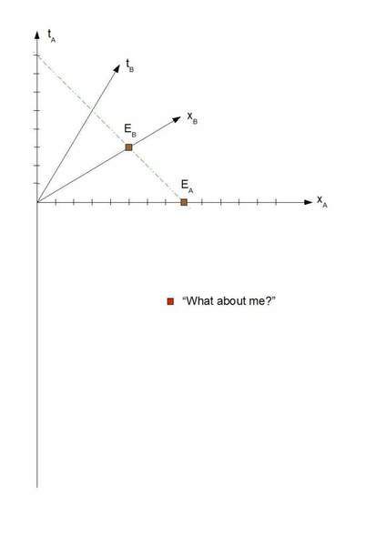

Jesse,
Attached is a diagram of the sort of situation I had in mind.
Note that I don't have the events which created the photons we have been discussing (red and green arrows, at 135 degrees from the tA axis. The events could have taken place millennia ago, really all that I am concerned about is the separation between the arrivals of the photons.
The diagram is in drawn in terms of the A frame.
B is moving towards where the events took place, which means that B intercepts the photons before A (in any frame) and B is closer than A to where the events took place (in any frame).
Down in the bottom right hand corner is an indication of what A and B would take to be "togetherness" for events which could have produced the photons.
Note that initiating events that were 1) together spatially for A and 2) could have produced the photons are further apart temporally than intiating events that were 1) together spatially for B and 2) could have produced the photons. This is true in any frame.
Note also that initiating events that were 1) together temporally for A and 2) could have produced the photons are further apart spatially than intiating events that were 1) together temporally for B and 2) could have produced the photons. This is also true in any frame.
Remember in the first post in this subthread, I said that the delay of t between the arrivals of the photons meant that, to have been emitted together, they were either emitted with a delay of t from the same location (relative to A) or simultaneously with a separation of L (relative to A). These values are also marked in the bottom right hand corner.
Now the thing that concerns me is that if I were to plug your figures into my drawing, I don't think I would arrive at 16 seconds between the arrival of the photons for A and 8 seconds between the arrival of the photons for B. I'd arrive at 16s and 12.8s.
Clearly something is wrong somewhere, either with my understanding, my explanation or your assumptions.
cheers,
neopolitan

neopolitan said:
Jesse,
Keep in mind that if you draw 1-second ticks along A's time axis and 1-light second ticks along A's space axis, then also draw similar ticks along B's space and time axis, then when drawn from the perspective of A's frame, B's space and time axes are not merely rotated versions of A's, in A's frame the distances (in the diagram) between ticks on B's axes are greater than the distances between ticks on A's axes. You can sort of see this if you look at the diagram from post #5, where in the diagram from the unprimed perspective you can see that the distance between pink events on the light blue space axis of the unprimed frame is just 4 light-seconds, and the distance between pink events on the yellow time axis of the unprimed frame is 4 seconds; but in the diagram from the primed frame, the light blue and yellow axes are not only slanted, but the distance along these axes between the same pink events also looks stretched (and the location of the three pink events in both frames was calculated using the Lorentz transform so I know they're correct).

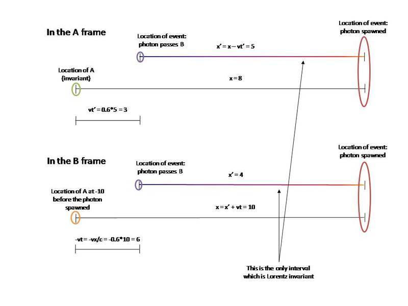

Ok, a new attempt. I am using a more rigorous diagram, using the figures you like, ie B is moving at 0.6c relative to A, and plotting numbers obtained from Lorentz Transformations. The green lines are the world lines of photon which pass the ends of the moving rod.
I'm just wondering, where is length contraction?
(I think I might know where it is, but drawing it clearly is difficult.)
cheers,
neopolitan
Just draw in the worldlines of either end of the orange rod--both worldlines should be parallel to the tB axis, since both ends are at rest in B's frame--and then the horizontal distance between the worldlines (along any surface of simultaneity in A's frame, which are all parallel to the xA axis) represents the length of the orange rod at a single instant in A's frame, it will be 3/gamma.

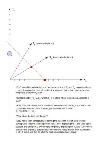

Damn,
I had it half drawn and was called away from my desk!
Anyways, here it is.
I don't want to follow cos' example by getting all wrapped around the wheels on what is "real", but ... it seems to me that what this diagram shows is that the rod is stretched across time and space (ie 1. the ends of the rod are no longer simultaneous, think clocks at each end, simultaneous in the rest frame, are not simultaneous to A, even if the speed is taken into account; and, 2. non-simultaneously, they are further apart), but the rod appears contracted to A.
Is that right?
I think this might be approaching the issue raised elsewhere by Saw.
As for me, it seems that maybe SAFTD might be a simpler feature to champion rather than TAFLC (although there are still benefits attached to TAFLC in my way of thinking). A benefit to SAFTD manifests in the derivation of the Lorentz Transformations from the Gallilean boosts, where you remove the assumption of instantaneous transmission of information (so you are discussing an event at a distance of x where x=ct and at t=0, t'=0 and the origins of the K and K' frames are colocated).
cheers,
neopolitan

Diagram looks good...
True, if clocks on either end are synchronized in the rod's rest frame using the Einstein synchronization convention, then they will not be synchronized at a single moment in A's frame. But I think it's potentially misleading to say "the ends of the rod are no longer simultaneous", the ends are just physical objects which trace out different worldlines in spacetime, they don't have any intrinsic "opinion" about simultaneity, all claims about simultaneity are based on human definitions of coordinate systems. The rod's orange "world-sheet" can be sliced up in different ways, that's what the relativity of simultaneity is all about.
If you say the rod "appears" to be contracted to 2.4 light-seconds in A's frame, you should also say that it "appears" to be 3 light-seconds in B's frame; alternatively you could say the rod is 2.4 l.s in A's frame and it is 3 l.s. in B's frame, the important thing is not to see one frame's definitions as "more correct" than any other's.

  • #174
See the three diagrams, numbered:
1 (Galilean boost),
2 (one photon passes B, then A - indistinguishable from a photon from Event E - Galilean boost not applicable) and
3 (part of the way to Lorentz Transformations).There are six numbered equations in diagram 3.
Put (5) into (6) or (6) into (5) and you have:
[tex]G = \gamma[/tex] ... (7)
Put (7) into (1) and you have "SAFTD".
Put (7) and (4) into (2) and you have the spatial Lorentz Transformation.
Because x=ct and x'=ct', then you just divide through by c to get TD and the temporal Lorentz Transformation (noting that t/c = x/c2).
You are probably going to tell me I am wrong for some reason, but it's really a heck of a lot simpler than some of the derivations I have seen.
cheers,
neopolitan
PS You can call the result of (7) into (1) SAFTD, or inverse length contraction, or length dilation, or relativistic effect on lengths, or the spatial relativistic effect. Or whatever you like. Irrespective of what you call it, can you see the physical significance of it?

  • #175
Some clarifications to the last post (done in the early hours of the morning).
G to E 01 - (Galileo to Einstein) - shows the standard Galilean boost. There is an assumption of instantaneous transfer of information (or god-like powers to see everything at once).
G to E 02 - shows what happens when you remove the assumption of instantaneous transfer of information. E is an "event". I stress that it could be something that causes the emission of a photon, or it just could be an event along the path of the photon. A and B see the same photon (thought experiment magic).
G to E 03 - shows the reconciliation, with subscripts to show "according to ..."
In this process, it becomes explicit what sort of physical things your x, t, x', t' and, if you like, L and L' refer to. You may want to check that they are referring to the right sort of things in your terminology (ie in which frame are things simultaneous and in which frame are things collocated), but I think you will find that while saying "time and space are measured oddly" might sound less than rigorous, it is actually more intuitive. To work out the simultaneity/collocation issues, you really have to already understand so I think it is a stage that should come after you have given a derivation.
