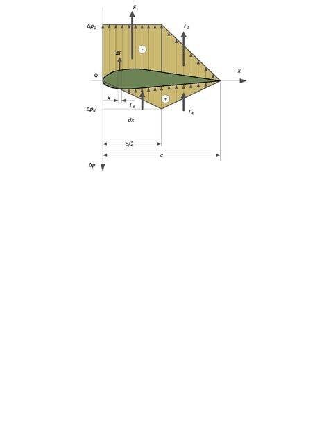

Jurgen M
v=50m/s
βˆ†Pg= -981Pa
βˆ†π‘π‘‘ =490Pa
c=1m
𝜌 = 1,225 kg m3

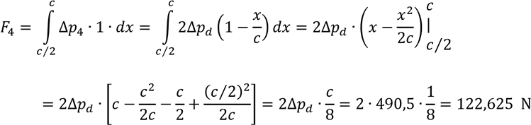

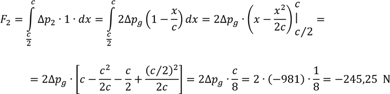

𝐹3 = ∫ βˆ†π‘3 βˆ™ 1 βˆ™ 𝑑π‘₯ 𝑐 2 0 = βˆ†π‘π‘” ∫ 2βˆ†π‘π‘‘ 𝑐 π‘₯𝑑π‘₯ 𝑐 2 0 = 2βˆ†π‘π‘‘ 𝑐 βˆ™ ( π‘₯ 2 2 ) c⁄2 | 0 = 2βˆ†π‘π‘‘ 𝑐 βˆ™ 𝑐 2 4 βˆ™ 2 = βˆ†π‘π‘‘ βˆ™ 𝑐 4 = 490,5 βˆ™ 1 4 = 122,625 N
Lift per unit of span = (F1) + (F2) +F3 + F4= 490.5+245.25+122,25+122,625=981N :confused:
Pressure push at all surfaces on airfoil,just push with less force on upper surface then lower surface, so F1 and F2 must has opposite direction than F3 ,F4.. so why they sum all forces with absolute values like pressure at upper surface pulling...?? pressure can not pull,only push :confused::confused::confused::confused:
Dont understand final lift math and force orientation..

It's not a pressure, but a ##\Delta p##, which is the pressure minus some baseline pressure. That can be negative.

calculate F3 from average pressure..
or with integral
Why they calculate F3 like pressure distribution "triangle" act at bottom airfoil surface from 0 to C/2?
If I see there is no pressure distribution at bottom surface from 0 to X, pressure distribution is drawn from X to C/2

Since there are no surface angles provided, it looks to me like all of the pressures are vertical components only (simplified problem). So while there are certainly positive pressures on the airfoil from 0-X, the orientation of the airfoil surface makes the vertical component negligible.

The pressure plot is based at the zero line not the lower wing surface, I made mistake because I look at surface..
What surface angle you mean?
You don't need the surface angle. You can just assume it's all acting perpendicular but acting on the projected area rather than the true area. Sure, the actual pressure force acts along the surface normal, but the vertical component is the same proportion of the total force as the projected horizontal area is of the total area, so all the angle dependence cancels out. For the calculation, you can just treat all of those as if they're acting vertically on a flat horizontal plate and you'll get the correct answer.
