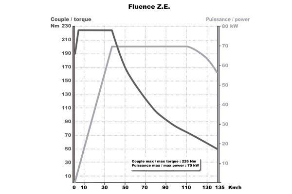

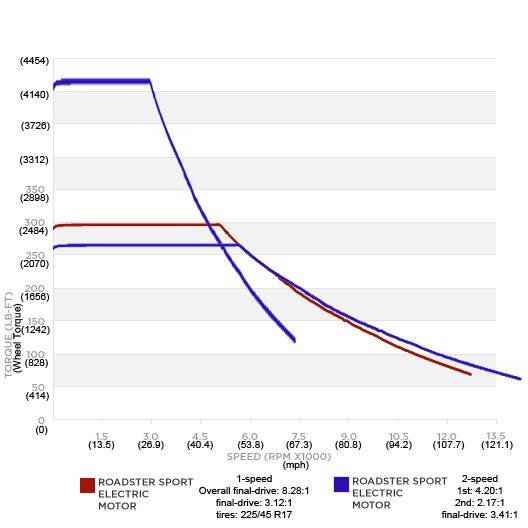

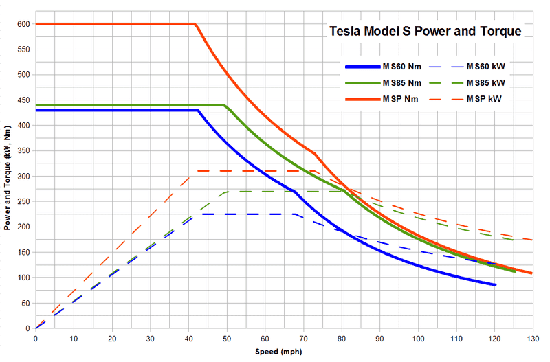

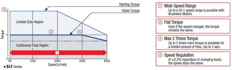

Ok, I add some clarification and set some basic hypotheses from which to start from.
This is the typical output of an electric car (brushless motor):
This is the actual, "physical" torque/speed curve for a dc/brushless motor:
Unfortunately, you can't exploit the whole curve from 0 rpm (stall torque) to no-load speed (= 0 Nm torque), because at stall torque you would have something like THOUSANDS of amperes in your motor, which, guess what, would melt it; so a "rated torque" is fixed by electronic (first picture).
When you read "CVT" for electric cars, they just mean "automatic gear", i.e. you have a gear stick with just three positions: Drive, Neutral, Rear ("standard" people does not need technical details about how CVT is accomplished: if by complex mechanics or just by an electric motor directly placed into the wheel (hub motor), or an electric motor directly connected to differential gear).
I know how actually "electrical CVT" work because I drove 6 different electric cars by myself, I own an electric scooter declared by manufacturer as "CVT", and I also wrote a book on this topic.
This said, I think that to solve the original question, we should really simplify the problem.
In a first instance, let's ignore rolling friction: in worst case, it can increase the 0-60 time, but we currently have too LONG time with all equations we found, so it does not help in finding right equation.
Then, let's consider torque as constant from 0 to 60 mph: again, once we'll add real torque/speed data, we'll get a LONGER time, and again we are not looking for a longer time, 60 seconds to go from 0 to 60 mph are already too many!
I think we should work&think about the actual torque applied to wheel and the actual contribution of air drag to the force expression and speed equation, because there must be something wrong here.

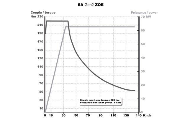

craigi said:
That is specifically what we were talking about and it does match the torque and power curves for many electric cars very well. The Fluence Z.E, for instance, has flat torque upto about 25 mph, followed by flat power up to about 70 mph.
Where did you get these data?

Once we'll find a "best case" result for 0-60 time, we could take into account the real torque/speed curve of an EV:
http://img534.imageshack.us/img534/146/005elecnogears.jpg
Compared to an ICEV curve:
http://img841.imageshack.us/img841/772/004icegears.jpg
Of course this will give longer times, but as I said, we are currently trying to REDUCE time resulting from our current formulas, because even the worst car requires st most 30 seconds to get from 0 to 60 mph, but we get 60+ seconds with our (wrong) formulas.

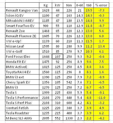

Here is my simplified formula (for electric cars) obtained by finding the best fit in Excel:
##t_{60}=\frac{2.79 m}{P^{0.46}T^{0.72}}##

  • #57
Found some actual charts:

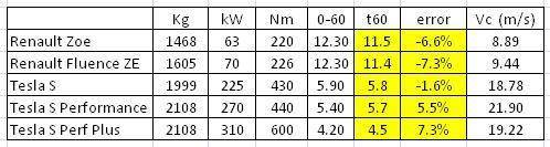

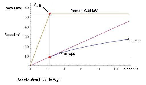

Basically we equate the input energy over the acceleration period to the final kinetic energy, so;
##Pt = \frac{1}{2}Mv^2##
[itex]\Rightarrow t = \frac{1}{2}\frac{Mv^2}{P}[/itex]
If P is the maximum power and if this could could be delivered right from zero mph then the time given by the above formula represents the absolute theoretic minimum acceleration time, but in practice, as you know, the power has to ramp up with the revs and velocity of the vehicle and so we have to find a reduced value for the power representing an averaged figure and taking losses into account.
jumpjack said:
This is an interesting formula... but how did you get to it? "Best fitting" what? And how?
Basically by trial and error and using the solve function in the Excel software. I have gathered together some more data for electric cars and found a better formula. The new equation is:
##t = \frac{1}{2}\frac{M v^2}{P}+\frac{1}{2}\frac{M^{0.48} v^2}{P^{0.48} T^{0.48}} ##
where v is the final velocity (26.8 m/s), P is the maximum power output in Watts, T is the maximum torque in Nm and M is the Kerb weight plus 75 kgs to take account of the driver's weight. The first term represents the bare minimum possible time and the second term represents additional time due to power ramp up, friction and how the the torque curve relates to the power curve. The table below shows an extended table of electric cars and their 0-60 mph times together with the predicted time (t60 column) and the percentage error of the predicted value from the published time in the yellow columns.
The average absolute deviation of predicted values from the published values is about 6% which is not bad considering the very wide range of vehicle weights, power and torque outputs in the table. Generally acceleration is considered to be mainly a function of power to weight ratio, but it can be seen that some cars have faster 0-60 times than other cars that have a higher power to weight ratio, so torque has to be taken into account.
I have found an exception to the above formula where the error margin is unacceptable. It is the million dollar RIMAC Concept One super car which has 1088 horse power (!) and 1600 Nm torque. The predicted 0-60 time is 1.5 seconds whereas the actual time is 2.6 seconds. I am assuming that the RIMAC does not have sufficient traction to transfer all of that extreme power to the tarmac efficiently despite having 4 wheel drive. Actually, this video would suggest that traction IS an issue for the RIMAC. A lot of the energy is going into smoking the tires and melting the tarmac. Still, 2.6 seconds is not to be sneezed at!

  • #59
yuiop said:
Your neighbours claim may be plausible.
No it's not: I forgot mentioning it has a 4 (yes, four) kW electric motor! :-)
Thanks for the new equation and table.
About the RIMAC Concept One... it's not easy to keep wheels in contact with the road when they try to give 1.9 g acceleration to the car! (27.8 m/s / 1.5 = 18.53 m/s2)
Even 2.6 secs mean 1g!
I think it's not very comfortable for passengers... ;-)

Maybe we could try taking into account the non-constant curve to get better results:
http://www.renault.com/fr/innovation/gamme-mecanique/images_without_moderation/courbe-zoe.jpg
We could suppose that given torque is available only for first 30% of speeds w.r.t maximum declared speed, than conisder linear (or quadratic) decrease of torque, or consider instead power values: 0 to Pmax in first 30%, constant P=Pmax for remaining 70%.
Specifically for this picture:
First 30%: T=220 Nm, P=6.3x
Last 70%: T=0.022 x^2- 5.2x + 357, P = 63000W
But torque at maximum speed is not usually an available data, so quadratic approximation of torque is not usually available and we must rely only on power curve.

  • #62
Actually, I found the power curve diagrams useful to make an improved predicted 0-60 time. Here is how it works. Looking at the curve for the Zoe it can be seen that the power is a linear function of the speed up to a critical speed (##v_c##) which in this case is about 30 km/h or 9.16 m/s. It is fairly easy to show that when the power is directly proportional to the speed, that the acceleration is constant and all the standard equations of motion apply, within the speed range ##0<=v<=v_c##. Using the first equation of motion:
##V=at##
##\rightarrow t=V/a##
##\rightarrow t=M V/Force##
##\rightarrow t_c=\frac{M V_c^2}{P_{max}}##
Note that this is twice the time predicted by the usual formula ##t=\frac{1}{2}\frac{M V^2}{P_{max}}## because the average power over this phase is half the maximum power. For the latter part of the curve from the critical speed ##V_c## to the final speed ##V_f## , where the power is constant (##P_{max}##) and the time is given by the usual relationship:
##t_{cf} = \frac{1}{2}\frac{M V_f^2}{P_{max}} - \frac{1}{2}\frac{M V_c^2}{P_{max}}##
Combining the two times above to gives the total theoretical acceleration time:
##t_{60} = \frac{1}{2}\frac{M (V_f^2+V_c^2)}{P_{max}}##
For the Renault Zoe this works out as 9.8 seconds.
This time makes no allowance for drive trains losses, drag, dynamic losses etc. Using a simple assumption of 15% power loss to encompass all these losses the equation can be written as:
##t_{60} = \frac{1}{2}\frac{M (V_{f}^2+V_{c}^2)}{0.85 P_{max}}##,
where M is the kerb weight plus driver weight in kgs, P is the maximum power in Watts and V is the velocity in m/s. This gives an estimated 0-60 time of 11.5 seconds which is pretty close. Applying the same formula to the 5 electric cars that we have power torque curve data for, gives an average absolute deviation of 5.6% from the published values for this admittedly small data sample.
The data set including ##v_c## is shown in the table below together with the predicted values and percentage errors.
The above results suggest the Tesla cars have less losses due to friction, etc than the Renault electric cars. For completeness the diagram below shows power and velocity as a function of time for the Renault Zoe:
It can be seen with power plotted as a function of time, that the average power output over the acceleration period is somewhere between 85 and 90% of the maximum power for a typical electric car. The velocity curve is linear to Vcrit as per the magenta line and then follows the blue curve after that.
if you have some more power/torque curves for electric cars, it would be interesting to see how they compare.

  • #63
From chart I calculated that for Zoe we have, for ##v<v_c##, P = k * v (k = 6900 = 63000 W / 9.16 m/s).
But, given that it must also be P = F * v , and given F = 220 Nm... shouldn't I get k=220 Nm ?!?
  • #64
220 Nm is the torque (T) and and not the force (F) in Newtons.
The force in the example you give is F = P/V = 63000 W / 9.16 m/s = 6877 N so you are right that F = k = Constant for ##V<=V_c##.
The Force can also be found from F=Energy/distance = E/s.
First we need to know the time to accelerate to Vc which is given by tc = M Vc2/Pmax = 1.955 seconds. (The time to Vc in the diagram in the previous post is slightly longer because I was using a value of 85% power to take drive train losses into account.)
The distance traveled in that time is s = Vc*tc/2 = 9.16*1.955/2 = 8.954 metres.
So F = E/s = (1/2)M V2/s = 0.5*1468*9.162/8.954 ≈ 6877 N.
The acceleration in this part of the curve is constant and is given by a = F/M = 6877 N / 1468 kgs = 4.685 m/s2 and ##t_{c}# is given by tc = Vc/a which is 9.16 m/s / 4.685 m/s2 = 1.955 seconds which confirms the earlier result.

Actually, the overall gear ratio might be something like 10:1. In this chart for the Tesla Roadster that you posted in #57, the overall gear ration is quoted as being 8.28:1 and the revs at 100 mph are about 12000! (Much higher than a geared petrol engine).
From the specifications in the Tesla website, the single speed Tesla Roadster Sport (red curve in the above chart) reaches maximum power at 4400 rpm which equates to a critical velocity of 39 mph or 17.4 m/s on the above chart. This is slightly earlier than the speed that the torque drops off from maximum in the chart.
With Vc = 17.4 m/s, a kerb weight of 1335 kg and maximum power of 235 kW, the 0-60 time predicted by my equation (assuming 15% drive train losses and a 75 kg driver) is 3.8 seconds while Tesla claim 3.7 seconds. Pretty good eh!
The outside diameter of a 225/45 R17 tyre as used on the Roadster is 634 mm giving a radius of 0.317 m. The rpm of the wheel at Vc is 17.4/(2*Pi*0.317)*60 ≈ 524 rpm. The engine speed at Vc is about ≈ 4400 rpm (from the chart) giving a overall gear ratio of 4400/524 ≈ 8.4:1 which is close to the 8.28:1 ratio quoted by Tesla.
