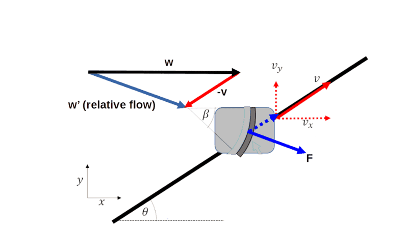

My position is that this result does not support the claim that ##v_x## can exceed ##w##.
The angles in the image below are roughly ##\theta=33°## and ##\beta = 43°##. When you plug these values into your solution you get a limit for ##v_x## of about ## 0.36 w ##.
If the track is completely frictionless, why would the below cart (even with the fixed vane) stop accelerating at ##v_x = 0.36w##?
The incoming relative flow w' would be ~20° clockwise from the x-axis, blowing right onto the vane, creating a force F roughly as shown, which only needs to have some non-zero component in the direction of v for acceleration.

  • #125
erobz said:
##w## is not in the direction you show?
##w## : true wind, air motion relative to the ground, is along positive x direction
##w'## : apparent wind, air motion relative to cart, is given by the vector equation:
##w' = w - v## (see also vector diagram top-left)

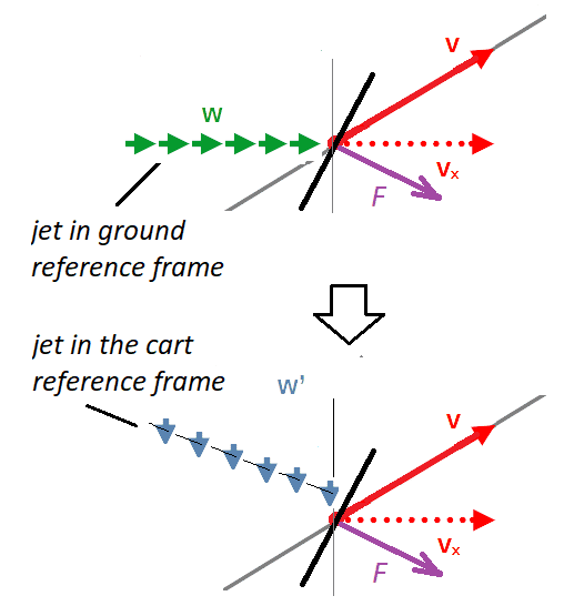

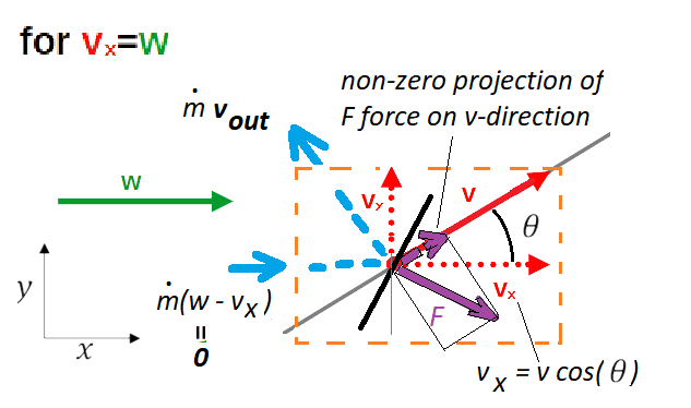

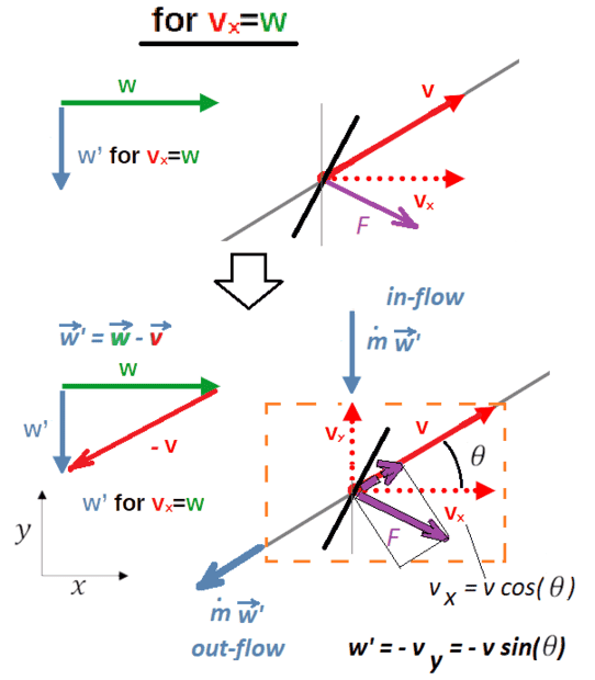

This is the situation at ##v_x = w##:
##w##: true wind (relative to the ground) along positive x
##v##: velocity of the cart relative to the ground
##w'_{in}##: incoming apparent wind (relative to the vane) along negative y (vector equation: ##w'_{in} = w - v##)
##w'_{out}##: deflected apparent wind (relative to the vane)
##F##: force on the vane (vector equation: ##F = \dot{m}w'_{in} - \dot{m}w'_{out}##)
##F_v##: component of ##F## parallel to ##v## (vector equation: ##F_v = F \cdot \hat{v}##)
As long as ##F_v## is positive, we can accelerate further, and ##v_x = w## is not a limit.

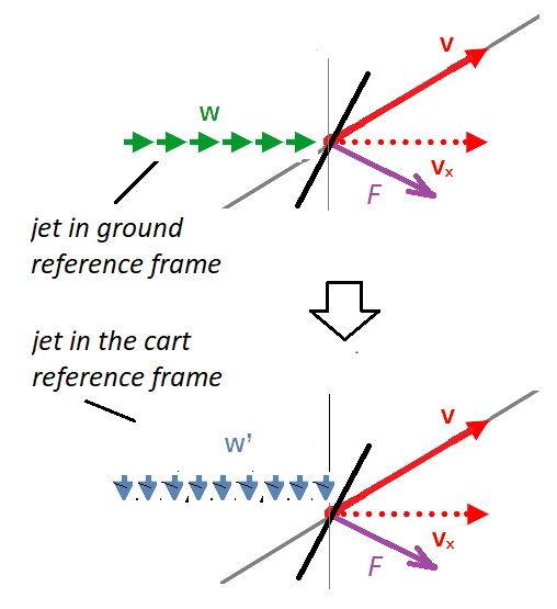

What is the maximum velocity of the cart in the following image?
The original configuration that you refer to was in post #20, so lets move back to that and fix it...I will analyze on any angle a jet(s) impinging on a vane. How do you want me to orient\select geometry for the vane such that the craft will outrun the jet(s) in the direction of the jet for some track angle ##\theta##?

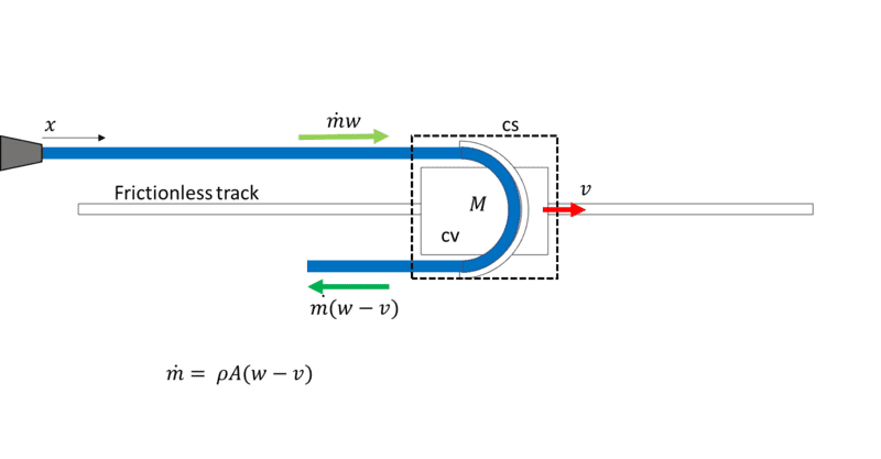

Assumptions:
1) The vane geometry must be fixed ( it's not changing from a quarter turn to a half turn etc...)
2) The direction of the impinging fluid jet(s) is fixed to the right ##\rightarrow^+##
3) The velocity ##w## of the incoming fluid jet(s) relative to the ground is constant magnitude.
4) The frame which we consider the forces is the inertial frame.
If you have a further stipulation that we need to optimize the vane orientation w.r.t. the craft, as a function of cart velocity, I'll work on that after those conditions\assumptions are agreed upon and I complete a fixed vane orientation result.
  • #141
Gleb1964 said:
I would agree even with unrealistic "jet wind" concept, asking consider infinity long sail instead. :smile:
I can begin with that. So you want a single jet, infinitely long planar sail oriented relative to the cart such that the force is maximized on the cart in the direction of motion?
  • #142
You can orient the sail like in the image below:
w : wind relative to the ground
w' : wind relative to the boat
v: boat velocity relative to the ground
This sounds wrong. The direction of fluid inflow onto the sail (w') is not fixed. It changes with v:
w' = w - v
See blue arrows above.

So it looks like we can't agree...can't say I'm surprised. The wind caries momentum into the sail,and is carried out in the direction the sail deflects it. This relative wind you keep trying to invoke for the analysis doesn't exist in the inertial frame. You are making up momentum that doesn't exist in the inertial frame. I'm doing the analysis in the inertial frame (a frame fixed to the ground)
  • #144
erobz said:

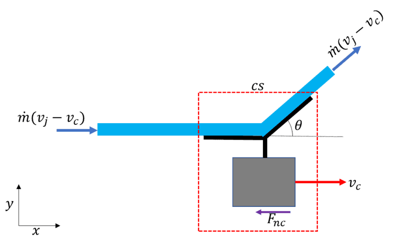

This is the diagram for your suggested infinite planar sail. My goal is to optimize the angle of the sail w.r.t. the cart ##\beta## such that the component of the force ##F## ( shown in purple ) in the direction of motion is maximized. I.e. I'm hoping to maximize ##F \cos \gamma##. Seeing the equations I'm developing I don't suspect to have a prayer of getting there in general, but I'll see what I can come up with.
If you don't like it, shoot it down before I go further.
