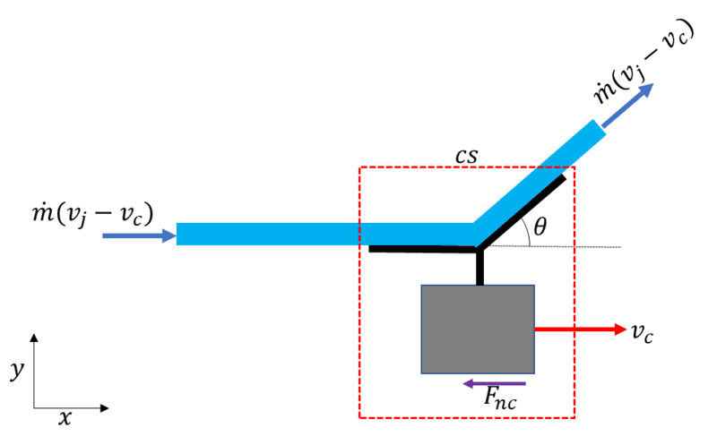

Lets say the cart below is moving at a constant velocity ##v_c## with application of ##F_{nc}##. With respect to an inertial frame fixed to the ground the jet has velocity ##v_j##
Assumptions:
Constant flow properties across the jet
Steady Flow
Inviscid Flow
The diagram is indicating the rate of momentum entering\exiting the cart w.r.t the inertial frame per the assumptions.
What is the force ##F_{nc}## acting on the cart?

The blue arrows aren't forces. That’s partially my fault. I have hybridized what is traditionally two separate diagrams ( momentum diagram, and force diagram) for brevity without stating that.
That's clear. You have mentioned all in a citation above. It is a steady inviscid flow. Flow is transferred momentum into control volume. That's all.
No need mention any air dynamic drag, the control volume is a black box, and a change of transferred momentum enough to calculate force components.
I only make remark, that from the question of "sailing down wind faster than wind" this configuration is irrelevant, because carriage in this case will never exceed the speed of flow. But I hope we will come to the relevant configuration.

Well, I would like to get this ironed out in the straight forward case first. Do you have any input on what I'm asking in post #220?

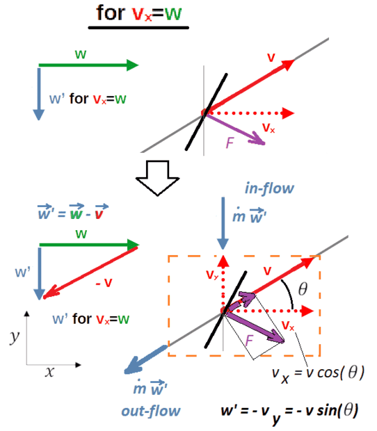

We are at the frame moving with speed ##v_x=w##, no wind.
Because ##v_x=w##, ##w-v_x = 0##
But the boat speed ##v## has ##v_x## and ##v_y## components. Because is ##v_y## component, the "control volume" is moving up with ##v_y = v sin( \theta )##, the sail is "smashing" the air flow upwards and back.

What you are saying is that you don't agree with what the analysis is going to show. That was the whole point of agreeing on the analysis in the video! This is a complete waste of my time!
Me: look at this video...here are all the assumptions
You: Ok looks reasonable.
You: That's what I get too, but...the car needs to be moving at some angle relative to the jet, blah, blah,blah
Me: turn it by some angle, and fiddle with the sail to maximize that force?
You: That will never work out the way I want.
You: lets skip the formalities we just agreed upon and just say I'm correct!
This conversation has been going on like this for three cycles now. I'm just waiting for "just look at the vectors" at this point; As if that not what I've been doing the entire time. Any minute now...

What you are proposing is not parallel to the agreed upon analysis technique shown in the video? Suddenly you are telling me the jet will rebound off of the vane.

Because there is outcoming flow, there should be incoming flow.
May be need to go to the reference frame of control volume? I remind, the reference volume is not fixed, its moving up. That mean I have wrong illustration of incoming flux. It is non-zero. :confused:

The cv is the reference frame. All the same assumptions about flow characteristics apply. We can do this so long as the cv in not accelerating, it is not accelerating because it being acted on by an external force opposite the direction of motion...just as it was in the video. If said force is non-zero at ##v_x= w## you've won the debate.

I should been looking on a diagram of apparent wind to not confuse myself.
Now is corrected drawing. The reference frame is fixed on the cart, control volume is fixed.
There is no wind in ##+x## -direction, ##v_x=w##, but there is a wind in ##-y## -direction.
From the point of control volume there is incoming flow from top with speed ##w'## and outcoming flow with the same speed, showed as out-flow on the picture.

Stop with the apparent jet! Was there an "apparent jet" in the analysis? You are adding it in because you believe you can fool me. I'm not amused...
It is apparent you are desperately grasping for straws now because you already realize what the "agreed upon" analysis is going to say...just as I do!
The jet CANNOT push the cart in the direction of the jet FASTER than the jet! No matter what you do to the sail orientation momentum CANNOT enter ( nor exit) the cart at ##v_x = w##. The mass flow rate ##\dot m ## is a true "mathematical factor" in the sense that it is multiplied by anything you can come up with for the velocities- any configuration your heart desires. Short of DeVine intervention by the hand of GOD no matter what you do to the sail to maximize the acceleration of the cart there is a hard limit.
$$ \lim_{v_x \to v_j} \dot m = 0 \implies F_{nc} \to 0 $$
Period!

Here is your jet, as you wish. One in the ground frame and another in the cart frame. I have to split it in the volumes to illustrate somehow the transformation.
