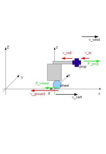

cesiumfrog said:
I agree that the "propeller driven by the wheels" reasoning is nonsense
Why ?
Have you considered the calculation in posts around 472-480 ?
Let us consider the essential parts. We place ourselves in the reference frame of the cart.
The model is given by the following elements:
*) the cart is rolling with a velocity v_cart on the floor (that is to say, in this reference frame, the floor is passing by at a velocity of -v_cart) with a wheel (or a set of wheels).
*) The cart propeller sees an incoming air speed of v_in and will give it an outgoing velocity of v_out.
*) The outgoing velocity of the air is essentially determined by the rotation velocity of the propeller (and its pitch) which is proportional to the rotation of the wheels, and hence to v_cart. We have hence as a model: v_out = K v_cart.
*) the air is moving relative to the floor with a velocity v_wind
In the ground frame, we have the velocity vectors in black ; in the cart frame, which is moving with a velocity v_cart to the right, we have the velocity vectors in red.
We assume that the cart is moving DWFTTW initially, and calculate the force balance on the entire thing. If the overall force is to the left, the cart will slow down ; if it is to the right, then the cart will speed up (or remain steady if we include extra drag).
We take the symbols v_cart, v_in, v_out and v_wind to represent positive numbers (the magnitudes of the displayed vectors).
The transformation from the ground (OXYZ) to the cart (oxyz) frame for velocities comes down to subtracting the vector v_cart from the black velocity vectors, right ?
We see then that the cart velocity is 0 (v_cart - v_cart), which is logical ;
that the ground velocity is (0 - v_cart) is v_cart to the left,
and that the (incoming) air velocity is v_wind - v_cart. Given that we oriented v_in already to the left, this becomes: v_in = v_cart - v_wind (magnitudes, we suppose that v_cart > v_wind).
As the rotation velocity of the wheel is proportional to v_cart, we assume that v_out = K v_cart, and we suppose that K is such that v_out > v_in.
So we have a propeller that sees an incoming air mass with velocity v_in, and it accelerates it to v_out. If the mass of air per unit of time that is thus accelerated is given by m, then we have, per unit of time, a mass m that goes from v_in to v_out.
Now, that means that the MOMENTUM gained by that air per unit of time is:
m (v_out - v_in), right. Now, to do so, Newton tells us that we have to exert a force on the air which is equal to m (v_out - v_in). That's the force that the propeller must exert on the air. Newton, again, tells us that this means that the air must exert a force F_air on the propeller (and on the cart) which is the negative of this. However, as the velocities v_out and v_in were oriented to the left, this comes down to a force TO THE RIGHT equal to:
F_air = m (v_out - v_in).
That's the force that the air exerts on the propeller. It PULLS the cart in the forward direction as long as v_out > v_in.
Now, as the air is accelerated, it didn't only gain momentum, it also gained kinetic energy. Per unit of time, the KE gained by the air is the kinetic energy after - kinetic energy before:
P = 1/2 m (v_out^2 - v_in^2)
That is the POWER that the propeller must deliver to the air. So an ideal propeller will at least need to *receive* this power P. On the axle of the propeller, the mechanical power P needs to be delivered.
Where does that power come from ? Well, the wheel is rolling on the floor and is mechanically connected to the propeller. If the propeller TAKES mechanical power P, that means that on the axle of the wheel, rotating at an angular rotation velocity w, a power is extracted. It means that a *torque* is exercised on the wheel against the rotation velocity w. The wheel is turning CCW, so the propeller, through the mechanical coupling, exercises a T torque in the CW sense (to extract power P). P = w x T. The propeller exerts a force, through this torque, on the ground, such that T = r x F with r the radius of the wheel. This force is oriented forward to have the torque act CW. So the force that the wheel exerts on the ground is forward with a magnitude of F = T / r = P / (w x r)
Now, we have that v_cart = w x r, so we can write this as:
F = P / v_cart
The *reaction force* of the ground on the wheel will be of the same magnitude, but opposite orientation F_wheel:
F_wheel = P / v_cart to the left.
The two forces that act upon our cart in the horizontal direction are:
F_air = m (v_out - v_in) to the right and:
F_wheel = P / v_cart = 1/2 m (v_out^2 - v_in^2) / v_cart to the left.
So the total forward force is given by F_air - F_wheel. If this is a positive number, then the net force will accelerate the cart in the forward direction, otherwise it will make it slow down, right ?
F_tot = m (v_out - v_in) - 1/2 m (v_out^2 - v_in^2) / v_cart
Now, the rest is algebra: we fill in:
v_out = K x v_cart:
F_tot = m x { K x v_cart - v_in - 1/2 (K^2 x v_cart^2 - v_in^2) / v_cart }
v_in = v_cart - v_wind:
F_tot = m x { K x v_cart - (v_cart - v_wind)
- 1/2 (K^2 x v_cart^2 - (v_cart - v_wind)^2) / v_cart }
F_tot = m x { (K-1) x v_cart + v_wind -
1/2 (K^2 x v_cart - v_cart + 2 v_wind - v_wind^2/v_cart) }
F_tot = m x { (K - 1 - K^2/2 + 1/2) v_cart + v_wind^2/(2 v_cart) }
F_tot = m x { - 1/2 (1-K)^2 v_cart + v_wind^2/(2 v_cart) }
F_tot = m / 2 {v_wind^2 - (1-K)^2 v_cart^2 } / v_cart
We see that we have a forward force if:
|1 - K| v_cart < v_wind, or v_cart < v_wind / |1-K|
So if we take K = 0.333, say, then we have a forward force as long as
v_cart < 1.5 x v_wind.
What's wrong with this calculation ?

vanesch said:
Still 55 (now 54) posts to go to reach 1000... Hope we'll get there :shy:
Ok, here's a little help. I probably missed it since your equations were spread out over many posts. What is the justification that 0<k<1 physically exists?
  • #948
I put my TT and cart together again to show a visiting friend and made a video with the TT running at a slower speed for those that want to compare calculations at different speeds (as suggested by mender post #940). I have also replaced the “large” tether arm with a thin bar. Are there any other tests anyone wants done while it’s together again? (that don’t involve me having to buy tachometers).
  • #949
Thanks :cool:
K is a design choice. It comes in v_out = K v_cart
v_cart determines the rotation speed of the wheels, and through some gearing, the rotation speed of the propeller, and the propeller has a pitch. So with a certain rotation speed of the propeller (and hence, rotation speed of the wheels, and hence, speed of the cart on the surface) corresponds a certain velocity of the outgoing air flow.
You can make K as big or as small as you want by changing the gear ratio between the wheel and the propeller, by changing the diameter of the wheel, or by changing the pitch of the propeller.
Note that v_out = K v_cart is an approximative model of a propeller, because v_out might
1) be influenced by the incoming velocity v_in
2) the relationship might be somewhat non-linear (in that case, the model v_out = K v_cart is still useful, but as a local linear approximation, and K can vary with the working point).
For a turbine in a closed tube, the relationship v_out = K v_cart would be much more exact (there's only one velocity that "gets through" the turbine without hitting the blades).
v_in will change the amount of work that needs to be done but it won't influence (much) the final velocity. I don't know in how much this applies to an "open" propeller.
The point was just to have a plausible model that shows that the device can work in principle, not really to get numerically very accurate outcomes. Given that there are large margins, a small model change won't change the qualitative conclusion.
By lowering the gearing ratio, you can make the propeller run as slowly as you like, and hence make K as small as you like. Actually, the relationship 0 < K < 1 is too severe. You can have K values outside of that range and still have the thing working. But if K really is too large (say, K = 5), then the device will not work. It is as if Atom Man was throwing his molecules too fast. The propeller would then require more work than can be delivered with a drag force on the wheels smaller than the trust by the propeller ; in other words, the overall force flips sign.
