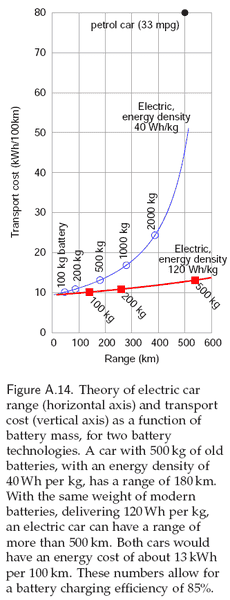

Here's a graph from Cambridge physicist MacKay's tomb on energy, that clearly shows the problem with too heavy batteries like lead acid. Any such design has an exponentially increasing marginal energy cost to adding more batteries. Assumptions: electric drive train eff. 85%, rolling resistance 0.01, drag-area 0.8m^2, some stop and go in the driving pattern, constant vehicle mass w/out batteries 740kg (very optimistic, as the non battery structure mass must also increase w/ battery mass). MacKay's starting assumptions are arguable IMO but the scaling holds true. Blue=lead acid, red=Li ion

I think the chart reflects a correct picture, and for the lead acid to become the battery of choice, it's application will need to be very specific and in line with the accepted average commute.
A range of 150-200 miles would be great, and the two things that can make this a reality would be a battery that can keep it's like new chemical conditions, and a battery that can be held in an ideal thermal state while being fed a much higher rate of charge than is now possible. (a full coverage no charge replacement for the life of the vehicle)
These two things would be the break through Russ mentioned.

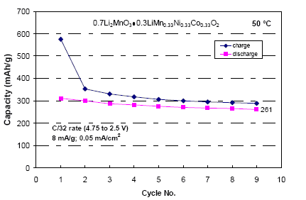

[edit] What we can safely say about the chemistry is that the main reason for the energy density improvement of lithium batteries is that the metal used is lithium, which has an extremely low density. About 1/20th of lead. There is no metal that is another 1/20th of that density.
Here we go, ~2.7MJ/kg Li-Mn battery (250mAh/g from 4 to 2V) out of ANL, or 2 to 3X times existing Li-ion batteries. They're playing some tricks with the structure of the electrodes (nanotech) and not so much the chemistry. Unfortunately this particular attempt lacks a usable cycle life (dozens), but it shows substantial large increases in energy density are possible w/ Lithium chemistry.
Press
http://www.azonano.com/news.asp?newsID=4072
Paper
http://www.electrochem.org/meetings/scheduler/abstracts/211/0305.pdf
