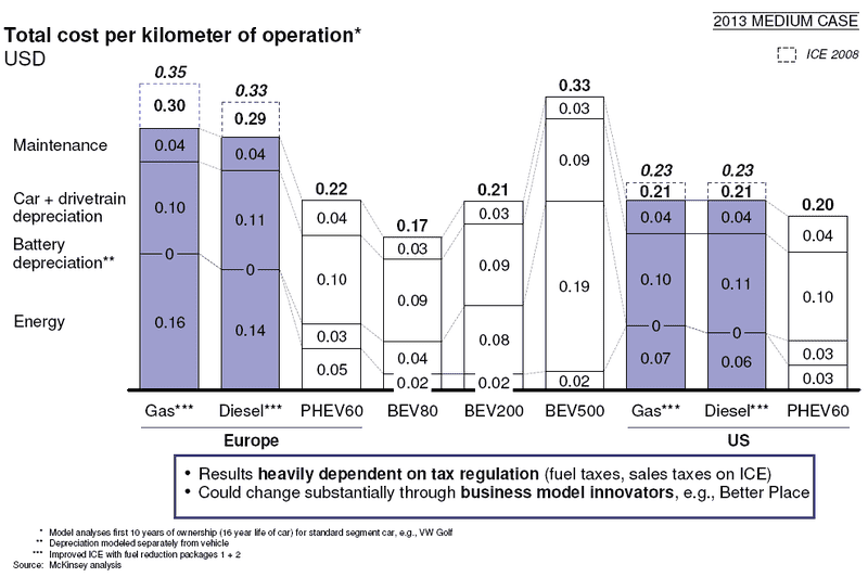

BTW,prior post to McKinsey cost study on gas/diesel/EVs/PHEVs US and Europe.
https://www.physicsforums.com/attachment.php?attachmentid=19278&d=1244668702
I think they are substantially high on EV battery cost.

  • #110
mheslep said:
...BTW,prior post to McKinsey cost study on gas/diesel/EVs/PHEVs US and Europe.
That is, McKinsey reports a lifetime cost of $0.04/km shown for its BEV80(km), and the BEV80 has the lowest total life cycle cost for any vehicle type ($0.17/km), even in the US with its lower fuel costs. Then McKinsey shows the battery cost per distance doubling and more than tripling for the longer range BEV200(km) and BEV500(km). I assert that with a battery exchange model, the battery cost per mile remains constant at 4 cents/km. The reasoning: the cost for a 100km range battery is about $7000, and with 3000 cycles lasts about 170,000 km, the life of the vehicle, thus ~4 cents/km. For a battery of twice that range, 200km, the upfront cost doubles to $14,000, but McKinsey still traps that cost over 170,000 km with the original vehicle owner, even though the battery is good for 340,000km. That makes sense if the battery is indeed trapped in the vehicle, but in a battery exchange system the vehicle owner need only pay for the 170k km driven, so the price can remain 4 cents/km.

Topher925 said:
The guy that developed this report is from the battery side of the alternative energy argument and so of course his argument is completely bias towards batteries. Their model is also completely flawed and *** backwards as far as future power and hydrogen generation goes.
I'm not interested in his stance (he's a fuel cell expert), but the figures on that chart. Aside from replacing electrolysis, do you disagree with any of them? 10% loss in compression, 20% loss in transport, then take a 50% loss in the fuel cell in the vehicle, or worse in a rankine cycle burning H.
... By using hydrogen generated from thermochemical reactions (at high pressures btw) stationary electricity can be generated by the use of SOFCs. Or, you can use that hydrogen and power cars, boats, or what ever else with it. And by using thermochemical cycles and SOFC for power its also possible to achieve much greater efficiencies than 40% out of a nuclear power plant.
This doesn't change anything on the chart except for replacing the electrolysis. Then one still has compress and transport molecules, not electrons, and build all of the H fueling infrastructure to go along with it. No, to the extent hydrogen becomes part of the energy infrastructure, it will be used to make electricity in big central turbines, it'll never get to end vehicles, my take.
