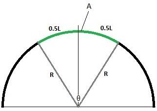

I'm taking this step by step. Reading this explanation, I pictured the following:
Let's say this is a hemisphere of an amount of radiant emittance ##M## of 1 unit area. Are you saying that the radiance ##L## is the amount of energy in the blue cone (##Ω##) that has a solid angle that fits ##\pi## times in the whole hemisphere? Such that the solid angle of 1 ##L## is 1 radian i.e. 57.3 degrees?
Likes Charles Link

You got it reasonably accurate, but a couple of corrections: ## \\ ## 1) ## \int\limits_{0}^{+\infty} M(\lambda,T)=\sigma T^4 ##, but you can't take a derivative of ## \sigma T^4 ## to get ## M(\lambda, T) ##. (If the upper limit on the integral was ## \lambda ## then you could take a derivative to get ## M(\lambda, T) ##, but in this case you can't.) ## \\ ## 2) To derive Wien's law, you take ## \frac{\partial{L(\lambda, T)}}{\partial{\lambda}}=0 ## and solve for ## \lambda=\lambda_{max} ## where this occurs. Given ## x=hc/(\lambda k_b T) ##, you will get ## e^{-x}=1-x/5 ## upon taking the above partial derivative. The equation has two solutions: ## x=0 ## which is extraneous(essentially tells you the slope approaches zero as you go to very long wavelengths), and ## x=4.96 ## or thereabouts. The ## x=4.96 ## solution gives you Wien's law. ## \\ ## Additional item: To get the factor of ## \pi ## as opposed to ## 2 \pi ## for a hemisphere, see the 2nd to the last sentence of post #79="Suggest you compute... " . Please give the computation a try=I think you will be pleased with the result.

Thanks for the feedback. Will try the integration, but I noticed something.
You said that the effective solid angle of the hemisphere is ##\pi##. But doesn't a hemisphere always have a solid angle of ##\pi## anyway? Or did you mean that the effective area of the hemisphere contains ##\pi## steradians instead of ##2 \pi##?. Such that the effective solid angle of the whole hemisphere is ##\pi## steradians × 0.572 radians (solid angle of 1 steradian) = 1,797 radians?

A sphere has solid angle ## \Omega= ##(surface area)## /R^2=4 \pi R^2/R^2=4 \pi ## steradians, so that a hemisphere has ## 2 \pi ## steradians. A flat surface that radiates as ## I(\theta)=I_o cos(\theta) ## puts out power ## P=\int I(\theta) \, d \Omega=I_o \Omega_{effective} ## where ## I_o ## is on-axis intensity and ## \Omega_{effective}=\pi ## steradians. Do the integration and I think you will see that the ## \Omega_{effective} ## is a useful concept.

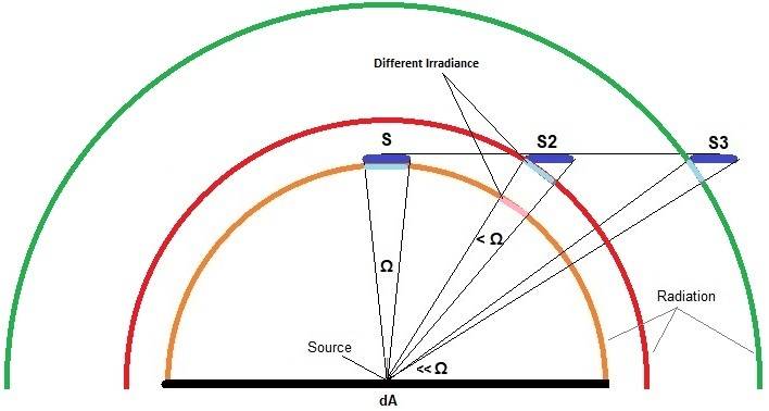

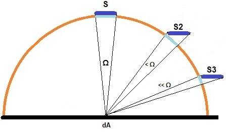

Sorry, but I'm still at the part where I'm trying to understand why radiance decreases when deviating from the on-axis of the hemisphere in the first place. I have a feeling I'm missing something very obvious.
Here's a 2 dimensional schematic of what I think is the cause:
All surfaces ##S, S2## and ##S3## have the same length. They all have a surface that, when put on the radiation arc (orange), has a solid angle of 1 steradian. Surface ##S## is sitting on the radiation arc and thus has a solid angle of 1 steradian. However, when deviating from the radiation arc, like ##S2## and ##S3## shown in the picture, it shows that the more it goes away from the on-axis, the smaller the angle of radiation that it receives.
Is this the cause why radiance decreases when deviating from the on-axis or is it something else? Sorry for bothering you with all this but if this is incorrect, perhaps it's more handy for me to see in a schematic what causes the decrease in radiance when deviating from the on-axis.

The radiance ## L ## is independent of viewing angle and stays constant. When viewed from a distance ## R ##, (## R ## needs to be kept constant here for comparisons), at viewing position at location with angle ## \theta ##, a circular source of area ## A ## will appear to be elliptical with area ## A_{effectiive}= A cos(\theta ) ##. The source will appear to be shrunken in the direction that the viewer is located: e.g. If viewed from a location that has ## y=0 ##, with ## x^2+z^2=R^2 ##, the apparent width in the ## y ## direction will be unaffected, but the apparent width in the x-direction, where ## x=R cos(\theta) ## and ## z=R sin(\theta) ## will be reduced by a factor ## cos(\theta) ##. If the source has radius ## r ##, the width in the y direction will be ## r ##, and the apparent width in the x direction will be ## rcos(\theta) ##. The area will appear to be ## A_{effective}=A cos(\theta) ##. ## \\ ## To precisely quantify the above, if you take the ellipse ## \frac{x^2}{a^2}+\frac{y^2}{b^2}=1 ##, essentially it is a flattened circle when ## b=r ##, and ## a=rcos(\theta) ##. If you compute the area of the ellipse, you will find that it is ## \pi r^2 cos(\theta) ##. ## \\ ## Note: In the above, we are assuming ## R ## is much greater than ## r ##, so that the viewing angle ## \theta ## is constant across the source. ## \\ ## Additional item: The intensity ## I=L A_{effective} ##. Notice if ## A_{effective}=A cos(\theta) ##, that ## I(\theta)=LAcos(\theta)=I_o cos(\theta) ##. A source that obeys this ## cos(\theta) ## fall-off in intensity, (which is very much expected), is said to be "Lambertian", named after Johann Heinrich Lambert. ## \\ ## For an additional problem, we could explore what happens as the viewer moves from S to S2 and to S3 in your figure above. You might find it of interest that the irradiance ## E ## per unit area incident on the surface falls off as ## cos^4(\theta) ##.

Ah, so this is all done according to the observer? While in reality, the "objective" radiance is the same at every angle?
  • #90
Yes. The radiance ## L ## is the surface "brightness. You might find it of interest, with an optical pyrometer to determine the temperature of a blackbody, a wire is heated (so that it glows orange)=and you can adjust the temperature of the wire=higher temperature is brighter orange=typical temperature range for an optical pyrometer is about 800-2000 degrees Centigrade. Anyway, you look through the viewer at your blackbody whose temperature you are measuring. You turn the dial until the heated wire blends in with the blackbody source=the brightness matches, so that the wire and the blackbody are at the "same temperature". (Editing... And this needs to be qualified slightly=see the "Additional question..." at the end). Their brightness level ## L ## is matched. You then read the calibrated dial on the optical pyrometer which tells you the temperature of the blackbody. ## \\ ## Additional question you may have is, is the emissivity of the wire=1.0 (or thereabouts)?, and I think the answer, in general, is no=the dial of the optical pyrometer is calibrated by initially using a thermocouple (or other means) to measure the blackbody surface temperature.

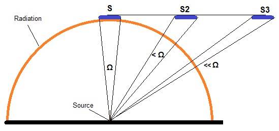

Let's say an observer has moved in the x and y-axis (2 dimensional) to keep the same distance ##R## to the source. Regarding the projected area, is this schematic correct?
If this is correct, then I have 2 questions:
1. How is ##x = cos(*) \cdot R## while my schematic shows that it's ##x = sin(*) \cdot R##? Perhaps I considered ##x## as your ##z## coordinate?
2. For some reason my instinct says that the size of a length when viewed from an angle should be ##B## in the below picture instead of ##A##. Don't know if there is any way to explain why it's ##A## and not ##B##. EDIT: Hold on, I have a hunch it's the same thing, but it looks as if the projected lengths are different.
Btw; The extra info you always add to your posts is very interesting to read. I'm not ignoring them, it's just that I'm trying to understand this first :)

From a previous post (#88) where I discussed the projected area of the source, your y here is that z, and y is the dimension into the paper. The source will appear to be shrunk in the x-direction so that, instead of being circular with radius ## r ##, it will be appear to be elliptical, and in the x direction it will appear to have a half-width of ## a=rcos(\theta) ##. (In the y direction it will be unaffected and appear to have a half -width of ## b=r ##, which is exactly what it has.) ## \\ ## Incidentally ## z=Rcos(\theta) ## and ## \frac{\sqrt{x^2+y^2}}{R}=sin(\theta) ##, so you do have it correct in your figure that ## x=Rsin(\theta) ##, but that is really irrelevant in computing the apparent dimensions of the source as seen from angle ## \theta ##. ## \\ ## As previously mentioned, the location ## R>>r ##, so that the viewing angle ## \theta ## is constant across the entire source. ## \\ ## Suggestion: Take a small circular object (like a penny) and view it from an angle off-axis. Does it look elliptical in appearance?

Thanks, I understand now the influence of viewing angle on how the surface of the radiating source appears to be smaller, but the following stumped me:

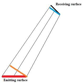

Please bear with me here as I try to punch this in my head. Here's the observer again who has just move in the ##x## direction again w.r.t. the surface ##A##.
As I see it, the ##cos(\theta) \cdot A## is approximately the same as its projection on the observer's sphere only in the case if the observer is very far away (##R## is high) or if the surface ##A## is very small.
That being said, when an area of ##cos(\theta) \cdot A## is on the observer's sphere, it has a certain 3D angle ##\alpha## in the observer's sphere. From what I know, you can calculate ##\alpha## by rearranging the following formula: ##cos(\theta) \cdot A = 2 \pi \cdot R^2 (1 - cos(\frac{\alpha}{2}))##
That aside, the surface ##cos(\theta) \cdot A## is part of the surface of the observer's sphere. The amount of steradians that this surface ##cos(\theta) \cdot A## contains is calculated by ##\frac{cos(\theta) \cdot A}{R^2}##.
So to get the amount of energy per steradian in the observer's sphere, I'd have to divide the energy that the observer preceives by that factor. This would eventually give the amount of energy that the observer perceives per steradian (but not necessarly per steradian per m2). So:
$$\frac{E_{observed} \cdot R^2}{cos(\theta) \cdot A}=L$$
Two questions:
1. Does this all make sense? If not, where exactly did I go wrong?
2. I'm probably having a huge blackout at the moment because I'm not sure how ##E_{observerd}## is calculated first nor what quantity this is. It's the energy that the source is emitting to the eye of the observer but with a certain spatial angle of the observer's sphere himself, not of the sphere of the source. How is this energy calculated?

@JohnnyGui I think you are starting to get a good handle on it. If I'm not mistaken, the brightness ## L ## can be computed either from looking from the surface and how it radiates (per square m^2 per steradian), or alternatively, from the observers' reference and computing the solid angle that the source subtends,( using the irradiance ## E ## at the observer), so that your calculation is correct. Keep up the good work !
## \\ ## Just an additional comment: The irradiance ## E_{observed} ## is often measured with a photodetector. Typically the response is linear, and the voltage from the photodetector (usually coupled to a current to voltage amplifier) is proportional to the irradiance. Typically, a photodetector can be calibrated using a calibration source of known irradiance ## E_{cal} ## at a specific distance. Then ## \frac{E_{observed}}{E_{cal}}=\frac{V_{observed}}{V_{cal}} ## where ## V_{cal} ## is the voltage that the photodector gave for the calibration source. This allows you to compute ## E_{observed} ## from the voltage ## V_{observed} ## of the photodetector.

Furthermore, to speak of the amount of energy the emitted surface emits per m2 of that emitting surface according to that point observer (received energy / (##cos(\theta) \cdot A##) is also not possible because this amount differs with distance from the emitting source.
However, if you consider the receiver as having a surface as well, just like the emitting source, then one would get the following scenario:
I think that in this case, one cannot speak of any quantity that has a solid angle unit in it (for example like radiant intensity) because they're not points. Except if you try to extrapolate the lines further up until they intersect. But to know the radius of that circle, one would have to know the angle at which the rays pass by the sides of the receiving surface. Since the detector you mentioned has a surface, what it does is measure the amount of energy received, by using the proportionality with the calibrated voltage like you said, and divide that amount of energy by it's own detector surface to get the irradiance in W/m2. So only if the receiver is considered a surface can one speak of irradiance.
Does my reasoning make any sense?

I think you are starting to get a good idea of all of the concepts, but it might be good to practice with a couple of calculations. Here is one that I think you could solve: ## \\ ## A source consists of a flat circular blackbody surface of temperature ## T=1000 K ## that has area ## A=.001 m^2 ## and is observed at a location ## \theta=60 ## degrees off-axis and at a distance ## R=1.0 ## m from the blackbody. The receiver/detector has area ## A_{detector}= .0001 ## m^2, and its normal points at the center of the blackbody. Compute the radiant emittance (per unit area ) ## M ## (watts/m^2) of the source (over the whole spectrum), the radiance ## L ## (watts/(m^2 sr)) of the source, the intensity ## I ## (watts/sr) of the source, both on-axis, and at angle ## \theta=60 ## degrees, and the irradiance ## E ## (watts/m^2) at the detector. Finally compute the power ## P_d ## incident on the detector. Also compute the total power ## P ## radiated by the source. If you can successfully compute these quantities, you have a good start at understanding the different terms that arise in this type of calculation.
