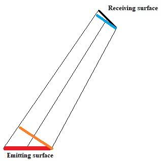

Great, I'll delve deeper into this. But I noticed something that is colliding with my reasoning.
If I understand you correctly, basically what you're saying is that if you straighten out that orange radiation arc (that I drew in post #87) into a straight line that overlap the plane of surfaces S, S2 and S3, you'd have the same total energy ##P## as in the orange radiation arc. If this is really what you meant, then integrating the irradiance ##E## over ##dA## in which you take the increasing distance into account (a proportionality with ##cos(\theta)^2##) would not add up pieces of energy from the orange radiation arc, but add up energy pieces from other larger radiation arcs in which the total energy ##P## is spread differently (over a larger arc). The result is not calculating the total energy ##P## from the orange radiation arc itself but adding up energy per ##dA## from larger radiation arcs.
Here's a schematic of what I mean. When taking the increasing distance into account for surfaces S, S2 and S3, then you'll be calculating irradiances of the light blue projected surfaces from 3 different radiation arcs in which the total energy is spread differently.
An example is shown saying that the irradiance ##E## in the light blue projected surface of ##S2## (on the red radiation arc) is not the same as the pink projected surface of ##S2## (on the orange arc). Their formulas are respectively ##E = \frac{I_0 \cdot cos(\theta)^4}{R^2}## and ##E = \frac{I_0 \cdot cos(\theta)^2}{R^2}##, so a factor of ##cos(\theta)^2## difference like I mentioned (factor of increasing distance).
What I think is the correct way to calculate the total energy ##P## of the orange radiation arc, is if you take out the factor of increasing distance (##cos(\theta)^2##) out of the integral so that you'd be adding up energy pieces of the orange radiation arc itself, like this:
So that one would have to integrate and solve:
$$\int \frac{I_0 \cdot cos(\theta)^2}{R^2} \cdot dA = LA\pi = P$$
Apologies if all this reasoning is wrong. Please correct me if I am.
  • #112
The answer is, yes, we do want to compute it as in your first diagram above at positions (arcs) of different irradiance. We want the observation points to cover an entire plane at a height a distance ## R ## (## h ## might be a better letter) above the original plane. ## \\ ## Your second diagram will not give the correct answer as written, and the reason is that coming off the source gives one factor of ## cos(\theta) ##, and although the irradiance onto the detector is a second factor of ## cos(\theta) ##, that is because the solid angle ## \Delta \Omega ## covered by the detector is ## \Delta \Omega=\frac{A_d}{R^2} cos(\theta) ##. ## P_d=I_o cos(\theta) \Delta \Omega ##. If you want to compute it on the orange arc, you need to keep the detector on the surface of the sphere rather than level with the plane of the emitting surface. Otherwise, there is not a one-to-one correspondence between ## dA ## in the integral and ## A_d ## of the detector. ## \\ ## In this second case, ## R ## is the arc radius. In the first case, ## R ## is the distance to the plane above. In the second case, ## dA=R^2 sin(\theta) \, d \theta \, d \phi ## and the integral is on the surface of the hemisphere. In the first case, ## dA=r \, dr \, d \phi ##, and the integral covers the plane at height ## R ## above the plane of the source. (Notice the use of ## r ##. It represents the radial distance in the plane in polar coordinates. And that is "polar" coordinates in the plane.) The integral over the plane (which is the first diagram in your previous post) of ## P=\int \frac{I_o}{R^2} cos^4 (\theta) \, dA ## ,(where ## R ## is the height above the emitting surface), should also give ## P=I_o \, \pi ##, and it does.

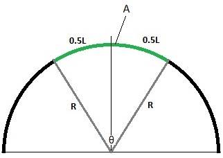

I've thought of yet another (different) problem. I'm trying to deduce the inverse square relationship between energy and distance, but through the change in the solid angle as a fixed surface ##A## gets further away from an emitter (perpendicularly to the emitter's plane). I know the relationship of:
$$A = 2πR^2 (1 - cos(\frac{\theta}{2}))$$
The ##\frac{\theta}{2}## can be written as the ##tan^{-1}## function of half the length of the surface ##A## (##L##) divided by the distance ##R##. So that:
$$A = 2πR^2 (1 - cos(tan^{-1}(\frac{0.5L}{R})))$$
What I'd expect is, that the factor by which ##A## increases in the formula as ##R## increases, should be inversely proportional to the amount of energy in a fixed surface that moves further away by that same ##R## increase. And at the same time, that the amount of energy should be inversely proportional to the square by which the corresponding ##R's## have increased.
So taking an example of ##0.5L=27##, the ratio of the 2 calculated surfaces ##A## at ##R = 5## and ##R = 10## is ##3.191965##. I'd therefore think that the amount of energy in a fixed surface that moves from ##R=5## to ##R=10## should be decreased by a factor of ##3.191965##. However, the corresponding ##R##'s have increased by a factor of ##2## and therefore the amount of energy in a fixed surface should be decreased by a factor of ##2^2=4## instead of ##3.191965##.
I don't get why the inverse of the factor by which ##A## increases does not represent the amount by which energy should decrease in a fixed surface.
  • #118
The above needs a couple of corrections=perhaps this will be helpful: The formula ## A_s=2 \pi R^2(1-cos(sin^{-1}(\frac{r}{R}) )## works best for smaller ## r ##, so that ## sin^{-1}(\frac{r}{R})=\frac{r}{R} ## (approximately), and ## cos(\frac{r}{R})=1-\frac{1}{2} (\frac{r}{R})^2 ## in which case ## A_s=\pi r^2 ##. (approximately). The area ## A_s ## is actually an area on a spherical surface, but for small ## \frac{r}{R} ##, simple flat geometry equations apply. Trying to apply the formula for ## r=27 ## and ## R=5 ## and ## R=10 ## really distorts the meaning of the formula.

Ah, this crossed my mind but I have a hunch that there is a larger cause that breaks the relation of ##A ∝ R^2## in the formula.
Let's throw out the ##tan^{1}## function and call the ##L## now the length of the spherical cap itself so that the spherical cap is the receiving surface ##A##:
The angle in radians that ##0.5L## makes is therefore equal to ##\frac{0.5L}{R}##. This angle should represent the exact length of the receiving surface ##A##, which is the the spherical cap. Now when I use the formula for the same values: ##0.5L = 27## and calculate the spherical cap surface ##A## at ##R=5## and ##R=10##:
$$A = 2πR^2 (1 - cos(\frac{0.5L}{R}))$$
I'd get that ##A## has increased by a factor of ##20.849## while the ##R^2## has increased by a factor of ##4##. So even if the angle represents the exact length ##L## of the receiving surface it's still not showing that energy decreases by the same factor that ##R^2## increases with.
What is now the issue in this case?

The problem is that your diagram is incorrect. The formula works for polar angle ## \frac{\theta}{2} ##. The ## .5 L ## represents the ("straight line" and not "arc") distance from ## z=0 ## to the edge of the circle that forms the boundary of the spherical section, where the sphere has a radius of ## R ##. The radius (from the z-axis) ## r= .5 L ## can not be greater than ## R ## in the way you are using the formula. You also have the formula incorrect in your latest post. It needs ## sin^{-1}(\frac{.5 L}{R}) ## (inside the cosine) which is only equal (approximately) to ## \frac{.5L}{R} ## for small ## \frac{L}{R} ##. ## \\ ## [Note: I made an error in post #118 which I corrected. The formula correctly reads ## A_s=2 \pi R^2(1-cos(sin^{-1}(\frac{r}{R}))) ##, with ## sin^{-1}(\frac{r}{R}) ## , and not ## tan^{-1}(\frac{r}{R}) ##. (Compare to the quote in post #119 and you'll see where I corrected it.) Also, I see in post #117, you have it incorrectly as ## tan^{-1}(\frac{.5L}{R}) ##.] ## \\ ## In any case, when ## r=R ##, ## sin^{-1}(1)=\frac{\pi}{2} ##, (90 degrees), and ## cos(\frac{\pi}{2})=0 ## so that ## A_s=2 \pi R^2 ##, which is a hemisphere. ## \\ ## I think you will find with the correct formula, and correct use of the formula, that it is completely consistent. ## \\ ## Additional item: You may ask, how is it possible to memorize all of the details about this formula? And the answer is, you don't=it is readily derived so that whenever a question comes up about it, you simply derive it: Using spherical coordinates, ## A_s=R^2 \int\limits_{0}^{2 \pi} \int\limits_{0}^{\frac{\theta_o}{2}} sin(\theta) \, d \theta \, d \phi =2 \pi R^2(1-cos(\frac{\theta_o}{2})) ##.

Correct me if I'm missing something, but the way I see it, the formula just contains ##\theta##, not how ##\theta## should be calculated. The way I chose to define ##\frac{\theta}{2}## is by saying that the angle ##\frac{\theta}{2}## in radians can be calculated by dividing its covered arc length (which I chose to be ##0.5L##) by the radius ##R## of the circle. Just like when half a circle's arc has a length ##Rπ## and therefore the angle that covers it is ##\frac{Rπ}{R} = π## radians.
So the "straight line" from the z-axis that you mention in the case of an arc of length ##0.5L## is equal to ##sin(\frac{0.5L}{R}) \cdot R##. So you can calculate the ##\theta## in two ways. I chose the way by using the arc length and divide that by ##R##.
(Btw, with this reasoning, this says that the arc length ##0.5L## cannot exceed an angle of ##0.5π## i.e. a length of ##0.5πR##)

As long as the definitions are consistent, it works. ## s ## is a better letter for arc length, but there's nothing wrong with using ## L ##, just so long as you define it that way.
  • #123
So the definition of ##0.5L## being the arc length instead of the straight line from the z-axis is not the cause of A not being proportional to ##R^2##. So I should be able to express the formula as:
Where ##0.5L## is the half arc length of the spherical cap and ##\frac{0.5L}{R}## = ##\frac{\theta}{2}## in radians.
The thing is, even if I choose ##0.5L## to be smaller than ##0.5 \cdot Rπ##, the proportionality of ##A## with ##R^2## still doesn't exist. I expect that it should since energy decreases by the inverse factor of ##R^2## if it's being divided over a surface ##A## that is larger by that that same factor.
(Sorry for my stubborness on this, but I really want to understand it)

For constant ## \frac{ \theta_o}{2} ## the area is proportional to ## R^2 ##. If your source radiates into the region of full cone angle ## \theta_o ##, which is typical of some directional type sources, (e.g. uch as an automobile headlight and/or a flashlight with a reflector that directs the beam), the area of the beam will be proportional to ## R^2 ## and the irradiance ## E ## will fall off as ## E=I/R^2 ## thereby conserving power ## P=\int E \, dA ##, just as it should.

That's exactly it! I don't get why I was putting a changing angle in the function. Probably a hint that I need to take a small break.
So as a fixed surface gets further away (increasing ##R##), the angle ##\theta## that it makes is inversely proportional to ##R## and the energy that it receives is inversely proportional to ##R^2##.
