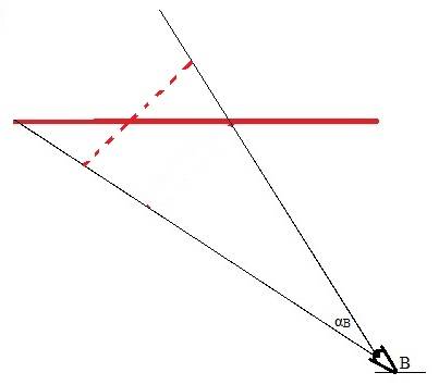

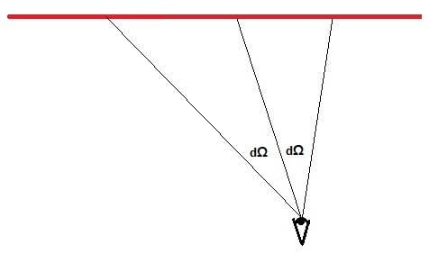

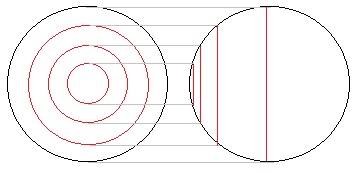

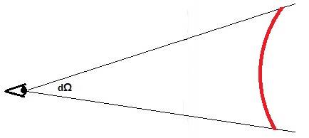

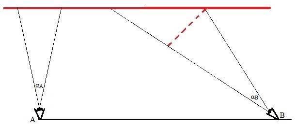

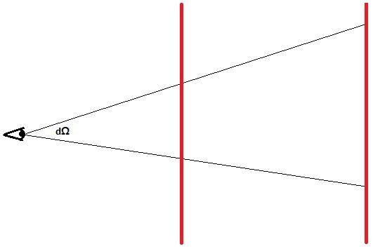

This is readily corrected: Your elemental source on surface ## A_2 ## is ## dI_2=L_2 \, dA_2 \, cos(\theta) ##, and ## dE_{perpendicular \, to \, path}=\frac{dI}{s^2}=\frac{dI}{R^2} cos^2(\theta) ##. Finally ## dE=dE_{perpendicular \, to \, path} cos(\theta) ##, (where ## dE ## refers to irradiance onto surface ## A_1 ##), so that ## \\ ## ## E=\int \frac{ L_2 cos^4(\theta)}{R^2} \, dA_2 ##. ## \\ ## (To make things more clear, I re-derived the ## cos^4(\theta) ## term here.) ## \\ ## Note that ## L_2=\frac{ \sigma T_2^4}{\pi} ##. ## \\ ## (Note the distance ## s=\frac{R}{cos(\theta)} ## in the inverse square law. Note also the ## cos(\theta) ## dependence for the elemental source ## dI_2 ##. Comes from ## I_o=LA ##, and ## I(\theta)=I_o cos(\theta) ##). ## \\ ## Upon evaluating this integral, the result will cancel the ## \pi ## in the denominator of the expression for ## L_2 ## giving ## E=\sigma T_2 ^4 ##.
  • #184
@JohnnyGui Once we have that one solved, an alternative enclosure shape could be used where the "ceiling" is a hemisphere in shape. The same result will be found to occur that ## E=\sigma T_2 ^4 ##. In general this result will be found to be the case for an enclosure of any shape. ## \\ ## And the reason for this result is that ## E=\int L_2 \, cos(\theta) \, d \Omega ## where ## d \Omega ## is the solid angle subtended by the source on surface ## A_2 ## as seen from ## A_1 ##. The solid angle integral just depends upon the hemisphere being completely enclosed=the shape is immaterial.
  • #185

Ah, so that's what was corrected in your post #181
I was falsely assuming that the integration ##\int E \cdot dA_2## would sum every ##E## from each ##dA_2## while this actually would give the total energy from ##E## that surface 1 receives from each ##dA_2## but on ##A_2## itself. So you've corrected the integration so that integrating over ##dA_2## would give ##E##.
Your corrected integration makes sense. So actually my deduced integration:
$$\int I_0 \cdot cos(\theta)^4 \cdot \frac{A_1}{R^2} \cdot dA_2$$
Does not really give ##P_{incident}## coming from the whole surface ##A_2## because I'm multiplying by ##dA_2##.
Instead, as an alternative to your method, I'd have to numerically add multiple times ##I_0 \cdot cos(\theta)^4 \cdot \frac{A_1}{R^2}## for each ##dA_2## until I have calculated ##P_{incident}## on ##A_1## coming from the whole ##A_2## and then divide that by ##A_1## to get ##E##?

You could compute ## P_{incident}=\int E \, dA_1 ## for whatever you pick ## A_1 ## to be, e.g. a small circle, etc. But here we have a simplification: Since ## A_2 ## is uniform in brightness ## L_2 ## and infinite in extent, ## E ## is independent of position on ## A_1 ##, so that ## P=\int E \, dA_1=E \int dA_1=EA_1 ##. We only need to compute ## E ## (by doing an integral over ## dA_2 ##). ## \\ ## It is a much more difficult calculation when ## A_2 ## is finite in size=e.g. a large or medium size circle and ## A_1 ## is also a large or medium size circle. Then the calculation for ## P_{incident} ## onto ## A_1 ## involves what you mentioned with your diagram in post #115. Your diagram in post #115 should also show a bunch of rays coming from the middle parts of the source as well, but you have the right idea.
  • #187
And take a minute to look at what the result ## E=\sigma T_2^4 ## is telling us: The irradiance on ## A_1 ## from ## A_2 ## would be the same if we butted surface ## A_2 ## right up against ## A_1 ##. (The irradiance ## E ## onto surface ## A_1 ## is the same as the radiant emittance ## M=\sigma T_2^4 ## that is leaving surface ## A_2 ##). It doesn't matter how far away surface ## A_2 ## is from ## A_1 ## because it's like looking at a uniform blue sky: If you painted a uniformly lit blue ceiling over your head with no contrast whatsoever, no cracks, no other markings or light fixtures, you could not tell how far away it is: It is the same effect here. You could even make the dome a hemisphere, but if it were uniformly illuminated, you could not even tell its shape: There would be no objects present to focus on to give you distance information.
  • #188

This is actually very interesting to know! Can I explain this also the following way:
The received ##P_{incidence}## is constant (##\sigma T_2^4 \cdot A_1##) and independent from the distance between ##A_1## to ##A_2## because if I move ##A_1## closer to ##A_2##, the received energy from the sides of ##A_2## decreases because of the increased angle ##\theta## but gets exactly compensated by an increased received energy caused by the decreased distance between ##A_1## and ##A_2##?
  • #189
The answer to your question is yes, in principle it could be computed this way. The problem that this method has is that the ## dP_{incident} ## would be found to be a function of ## r ## and ## \phi ## , (i.e. when using polar coordinates=you could also say the result for ## dP_{incident} ## would be a function of (x,y)=corresponding to the position of your elemental source on ## A_2 ## ). As a result, the calculation for ## P_{incident} ## when you are integrating over ## dA_2 ## could get extremely complicated. If you were to go this route by selecting some shape for ## A_1 ##, e.g. a circle, you would necessarily get the result that ## P_{incident}=A_1 \sigma T_2^4 ##, but it's possible the integral expression when integrating over ## dA_1 ## to compute ## dP_{incident} ## from the elemental source ## dA_2 ## at location (x,y) would become unmanageable. (If you did get an answer for ## dP_{incident} ## (by integrating ## E ## over ## dA_1 ##)as a function of (x,y) of the position of ## dA_2 ## on surface ## A_2 ##, you could then integrate over ## dA_2 ## to compute ## P_{incident}=A_1 \sigma T_2^4 ##, but it's quite possible the mathematics to do these two steps would be next to impossible). It is a much easier route to pick one single point on ## A_1 ##, and compute the ## E ## by integrating over ## dA_2 ## first. ## \\ ## And even though you apparently missed a Latex symbol in your second comment, I was able to read it, and yes, it is correct. This ## E=\sigma T_2^4 ## is a very useful result that we previously used in your differential equation in post #31, where ## T_2=T_{ambient} ##.

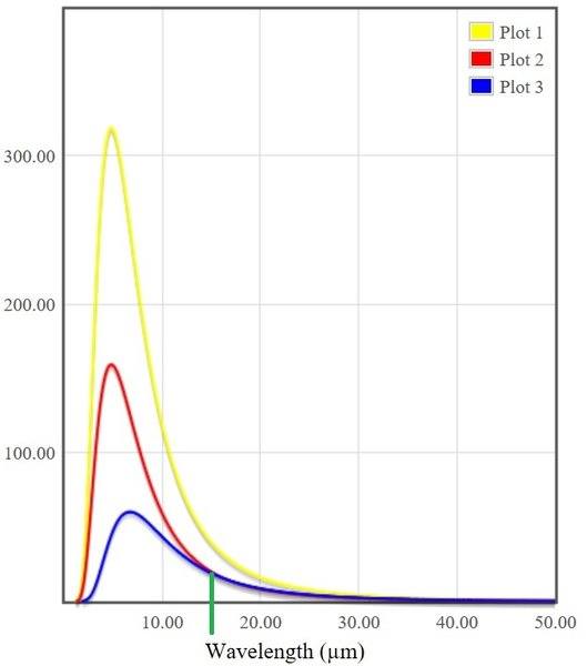

One other thing we could look at that you might find of interest would be to take the Planck blackbody spectral function, (see post #81 for its functional form), for the incadescent source you had in the early parts of this thread. If you assume the emissivity ## \epsilon ## is independent of wavelength, (it's precise value isn't fussy; ## \epsilon=.3 ## would work ok), and assign a temperature ## T ## (degrees kelvin) to the filament, you can then take the ratio of the integral of the Planck function integrated over the visible wavelengths (wavelength ## \lambda= ##380 nm to 750 nm) vs. the integral over the whole spectrum, and this will give you the fraction of the radiated light that is in the visible region of the spectrum. I believe this number will be something like ## r=.15 ## so that these light bulbs basically have an efficiency of about 15%. Most of the output of an incadescent lamp is in the infrared region of the spectrum.## \\ ## A numerical integration should work ok, and an integration for the denominator of wavelengths ## \lambda ## from 0 to 20,000 nm would be ok, (instead of ## +\infty ## for the upper limit on the integral). An increment of ## \Delta \lambda =10 ## nm would give reasonably good accuracy. ## \\ ## (It is also of interest that the exact answer for the integral ## L=\int\limits_{0}^{+\infty} L(\lambda,T) \, d \lambda ## for the function ## L(\lambda,T) ## in post #81 is ## L=\frac{\sigma T^4}{\pi} ## where ## \sigma=(\frac{\pi^2}{60})(\frac{k_b^4}{\hbar^3 c^2}) ##. Plugging in these constants will indeed give the value for ## \sigma=5.67 E-8 ## watts/(m^2 K^4) ). ## \\ ## A couple of helpful items in this integration: ## \\ ## 1) ## L(\lambda,T) ## is undefined at ## \lambda=0 ## but for ## L(0,T) ## you use the value of ## L(\lambda,T) ## as ## \lambda \rightarrow 0 ## which is ## L(0,T)=0 ##. ## \\ ## 2) For the function ## L(\lambda,T) ##, you can use constants ## c_1=2hc^2=1.19E+20 ## Watts/(m^2 nm) (I believe I computed it correctly=it actually gets a unit of nm^5 in the numerator next to watts, but that cancels the nm^5 units in ## \lambda^5 ## ), and ## c_2=\frac{hc}{k_b} =1.438 E+7 ## nm K. ## \\ ## [Use ## \lambda ## measured in nanometers in the formula for ## L(\lambda,T)=\frac{c_1}{\lambda^5 (e^{\frac{c_2}{\lambda T}}-1)} \, ##]. ## \\ ## Additional note: A google of the subject shows there are a couple of programs you can find on-line that will perform the above mathematics for you.
  • #193

And please take a look at the spectral computation of post #192. I think you should find it somewhat easy to follow since we looked at the concept of spectral intensity functions in posts #140-#160 and thereabouts.
I've read it but I need just one hint to fully understand this. Doesn't integrating a spectrum curve, up until 20,000nm like you mentioned, initially give ##\sigma \cdot T^4##? I'm trying to find out how you've rewritten the integration so that you'd be integrating ##L## over ##d\lambda##. I think it's a blackout once again for me, I'm delving into this right now.

Your logic concerning a sensor that outputs an object's temperature is correct. In general it will be prone to the type of error that you have pointed out. ## \\ ## The spectral curve ## L(\lambda, T) ## can be integrated between two wavelengths and gives the radiance ## L ##
contained between those two wavelengths. If you integrate ## L(\lambda, T) ## from 0 to ## +\infty ##, you get ## L=\frac{M}{\pi}=\frac{\sigma T^4}{\pi} ##. The numerical integration from 0 to ## +\infty ## for a hotter object can be cut off around 20,000 nm and you'll account for 99% or more of the total energy. ## \\ ## This integral result from 0 to ## +\infty ## for ## L(\lambda, T) ## is in fact exact, but it is a rather advanced integral, and even a student who has had 2 or 3 calculus courses would not be expected to know how to solve it. You can do a numerical integration of it for a selected temperature ## T ##, (e.g. ## T=2500 \, K ##) , and you should be able to show pretty good agreement to the exact value of ## \frac{\sigma T^4}{\pi} ##. (within +/- 1% or better). ## \\ ## In some literature, you will see the Planck function as ## L(\lambda,T) ##. You will also find it presented at times as ## M(\lambda, T)=\pi L(\lambda, T) ##. The ## L(\lambda, T) ## is the more common form, but you will find it in both forms. For ## M(\lambda,T) ## you have the result ## M=\int\limits_{0}^{+\infty} M(\lambda, T) \, d \lambda=\sigma T^4 ##. ## \\ ## The functional form for the Planck blackbody spectral function ## L(\lambda, T) ## can be derived from some very advanced physics principles, but that is beyond the scope of what we are doing here. We're simply using the results of that derivation. And note only does the result of this derivation give us the Planck spectral function, it also supplies the result that when the Planck function is integrated from 0 to ## +\infty ##, the result is that ## M=\sigma T^4 ##.
  • #197
Charles Link said:
In some literature, you will see the Planck function as L(λ,T)L(λ,T) L(\lambda,T) . You will also find it presented at times as M(λ,T)=πL(λ,T)M(λ,T)=πL(λ,T) M(\lambda, T)=\pi L(\lambda, T) . The L(λ,T)L(λ,T) L(\lambda, T) is the more common form, but you will find it in both forms. For M(λ,T)M(λ,T) M(\lambda,T) you have the result M=+∞∫0M(λ,T)dλ=σT4M=∫0+∞M(λ,T)dλ=σT4 M=\int\limits_{0}^{+\infty} M(\lambda, T) \, d \lambda=\sigma T^4 .
Ah got it. So integrating a ##M(\lambda, T)## curve and a ##L(\lambda, T)## curve would only give a factor of ##\pi## difference?

One question, if ##L(\lambda, T)=\frac{2hc^2}{\lambda^5(exp^{hc/(\lambda k_b T)}-1)}## then what would be the formula for ##M(\lambda, T)## curve? And what are the unity differences on the y-axis between them?
I deduced some conclusions when plotting my deduced formula (##\epsilon## as the ##x## variable) that shows what temperature the detector would give based on ##T_1## and ##T_2##. I'd really appreciate a verification if these are correct.
1. If ##T_1 > T_2##, and the emissivity of the object is anywhere between ##0 < \epsilon < 1##, then the detector would always underestimate the temperature of the object.
2. If ##T_1 < T_2##, and the emissivity of the object is anywhere between ##0 < \epsilon < 1##, then the detector would always overestimate the temperature of the object.
3. If ##\epsilon = 1## then the detector would always give the correct temperature ##T_1## regardless if ##T_1## is lower or higher than ##T_2##.
4. If ##\epsilon = 0## then the detector would always give ##T_2## regardless if ##T_2## is lower or higher than ##T_1##.
Are these correct?

@JohnnyGui One recommendation in using the above "link" is to chose the linear graph option. Anyway, I think you might find it useful. :)

I was thinking this through a bit and I noticed something. I understand that if you move surface ##A_1## away or towards the emitting ##A_2## you'd still receive the same power from each ##dA_2## from the surface ##A_2##. However, (and correct me if I'm wrong) there's one exception: there is exactly one ##dA_2## that you'll get a different power from if you change the distance of ##A_1## from ##A_2##. This is the ##dA_2## that is exactly in front of ##A_1## perpendicularly on it. The surface ##A_1## will receive ##I_0## from that particular ##dA_2## and since there is no ##cos(\theta)## factor that changes with distance from that ##dA_2##, the power that ##A_1## receives from that particular ##dA_2## will have a net change of the distance change ratio squared.
So if you increase the distance between ##A_1## and ##A_2##, wouldn't ##A_1## have a net decrease in received power because of that perpendicular ##dA_2## instead of a constant ##T^4_2 \sigma \cdot A_1##?

Your conclusions concerning the temperatures the detector would determine are all correct.
