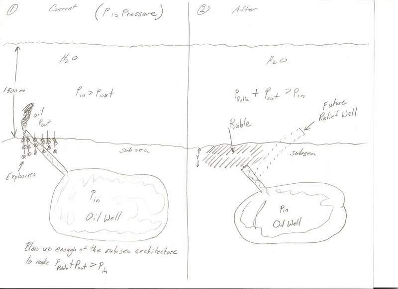

What about series of detonations? This could be a quick fix until the relief well is drilled. Detonations can be performed in a matter of weeks. I hope they are not trying alternative methods for the sake of reusing the well bore or to continue to collect oil. They need to stop the oil ASAP.
Drill many small diameter holes lined with explosive ~1000 meters around the well bore. Use the series of detonations to implode the well hole and cover it with ruble (i.e. make the Pressure inside the well<Pressure outside the well). I almost feel that the extreme pressures of the environment would allow for more controlled explosions or implosion from the detonations. This could stop or slow the leak until the relief well is completed.
I did some rough calcs and oil pressure at ~5000 psi, one would have to implode and cover it with ~1000 meters of ruble. I wonder how many meters they can drill in a day?
I have not heard of ideas regarding detonations of the subsea architecture or an implosion of the well head. What are the risks besides letting the oil leak like it has been for the last month? I am sure the have the well bore mapped.
BP should release some stats on the problem (i.e. map/diagram of the well, P's, T's, and V's, effluent components, flow rates, surrounding material properties, etc.) so some independent engineers can be more serviceable

  • #60
They are not trying to salvage this well. It is cheaper to cap this one and drill another new one than it is to try and save this one. It doesn't even make economic sense let alone common sense to try and save this well.
The rate of penetration (i.e. how much the can drill in a day) depends on many factors specific to the geology of the well and the equipment used.
In order to 'blow the well up' they would have to drill (like they are now with the relief wells) to insert the explosive device. Since that is risky (i.e. blowing up the well) and requires the same amount of time it's better to just kill it with the relief well.
CS

CS

No pressure containment? The riser appears to be kinked or otherwise has its ID reduced, possibly by internal debris. These conditions would reduce flow (and increase pressure inside the riser) as compared to a cleanly square cut riser head atop the BOP. I assumed this was the reason spill flow is expected to increase by 20% (per reports) after the cut, prior to a re-containment of some kind.
  • #64

xxChrisxx said:
Well on the plus side it would make the fisherman's job a lot easier, al those fish can't swim away. Plus they'd probably already be cooked, granted glowing a little but a bit of radioactive fish never hurt anyone. Would probably give us all superhero like powers.
Exploding low yeild nuke under the seabed should not cause those problems, especially radiation and excessive heat. The radiation will be pretty much contained under the seabed. It should not progress outside the seabed at all, due to the very powerful implosion that immediately follows the explosion due to the extreme underwater pressures.
In fact, it should be avoided to use large, 'megaton-class' weaponry(like the Soviet 'Tsar Bomba') as the large explosive energy could compromise the oil-pocket itself and literally, open up the oil pocket to the sea, causing a situation that's completely impossible to fix.
  • #86
Eat this Tuna, and gain the ability to create fire... plus lymphoma! Heh, thanks for showing a lighter side to this. :)
Crapworks: To get deep enough in the seabed would require... wait for it... DRILLING! Why not wait for the relief well in that case? Besides, there are a lot of maybes and shoulds that I don't like when it comes to detonating a nuclear bomb.
  • #87
That's true. And this makes using conventional explosives to pinch the well a much better alternative.
Maybe it's possible to run some quick deep sea trials in collaboration with the navy to try to pinch a metal tube of the same kind used in drilling wells using explosives. If it works consistently, then they can try it on the troubled well itself.
  • #88
I don't think you understand why a nuclear detonation might work, and why conventional explosives would not. It is the fusion of sand and mud into glass over a large area that forms the "plug" from a nuke... compared to collapse from conventionals. The latter would require even more drilling, and I have a hard time believing that it would work.
  • #89
I understand how nuclear detonation will work to seal the troubled well. That was my idea initially. I had to think of other ways due to the unpopularity of 'nuclear solution'.
I'm uncertain with the conventional explosives solution as well, but it won't hurt to try or at least simulate virtually. It's a rough idea I suggested, and it may or may not require drilling, the idea has to be tested first. The basics are several explosive with some distance from the well, equally spaced around it, and simultaneously exploded around the well - that should create a powerful implosion at the middle that might pinch it without destroying it.
  • #90
Imagine the miles of geologic formations containing the the oil reservoir, in the worst case, as glass , i.e. brittle. Then imagine the worst case outcome of a large explosion in the 'glass' containment material over possibly hundreds of millions of barrels of oil & gas down there.
  • #91
mheslep said:
Imagine the miles of geologic formations containing the the oil reservoir, in the worst case, as glass , i.e. brittle. Then what imagine the worst case outcome a large explosion in the 'glass' containment of possibly hundreds of millions of barrels of oil & gas down there.
Well, I know what I'll be having a nightmare about tonight! :wink:
  • #92
stewartcs said:
No.
1) they can't glue steel tubes together especially while the well is flowing.
2) even if they could seal the tubes together the pressure acting on the surface area on the bottom of the tubes would blow them out.
CS
Thanks for comments! Maybe you are right regarding possibility "glueing/cementing" tube shells together in actual conditions - but I also mentioned possibility relying on the tube sections own weights. If the tubes are sufficiently long, they will of course stand the pressure - if 900 atm (that may have decreased by now) appr 1.2 km steel tubes stand the pressure. And in the beginning, when inserting the outermost tubes, the pressure may be much lower because of still decent flow through pipe, reducing pressure due to flow resistance in the well. I realize exact static and dynamic forces on tube sections are not easy to tell without knowing more. But If the total length corresponds to static pressure when flow is halted - the tube will not be lifted at any conditions - I dare say without being hydromechanics professional.
Possibly the tubes could be hanging down by help from "collars" at end of tubes - securing their position.
If the flow still cannot be fully halted, such tubes will at least reduce the flow considerably
and also prevent the original pipe from being eroded away - a very dangerous threat in the long run if the flow continues, an oil "expert" mentioned.
