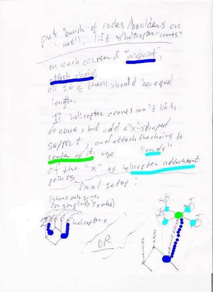

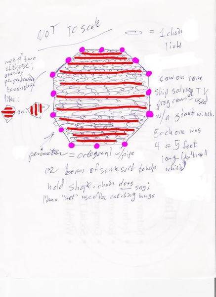

Hi Om,
Just have time for a quick response.
I sketched a very crude and simple set of drawings of what I have in mind, I'm not sure we are in tune about size of the tube (we do know it needs to be close to 5,000 feet long) but the weight (based on 16oz material) came out at 50 tons for fabric alone.
My plan is 15' dia. at the bottom and 100' at the top and a floating ring of containers (three sets of rings (90 or so each ring) to form a containment pool 200' in diameter. The containers would float in a vertical position with 10' to 15' above water and 25 or 30 feet under water (a solid wall liner from top to bottom 40', this is all just best guess and can be trimmed in size (or expanded).
The tube alone came in at 1.5 million dollars for just the fabric (16.95/yd) and the containers I calculated at $3,000 each, which I think will cover shipping and prep. Allowing for boats and barges for a working platform, the project came close to 2.5 million. Double that and at 5 million it is still a bargin.
I saw on the news last night that someone finally has tried the suction method for getting the oil off the water before it gets on land, this to me is the second most important thing to do in this disaster.
My thoughts about working the shoreline is a simple pair of pontoon floats (4' X 48' X1') built from materials from a big box store and having a bridge across them for a work surface. using the lightest materials possible a floating platform about 12'-18' wide and 48' long.
