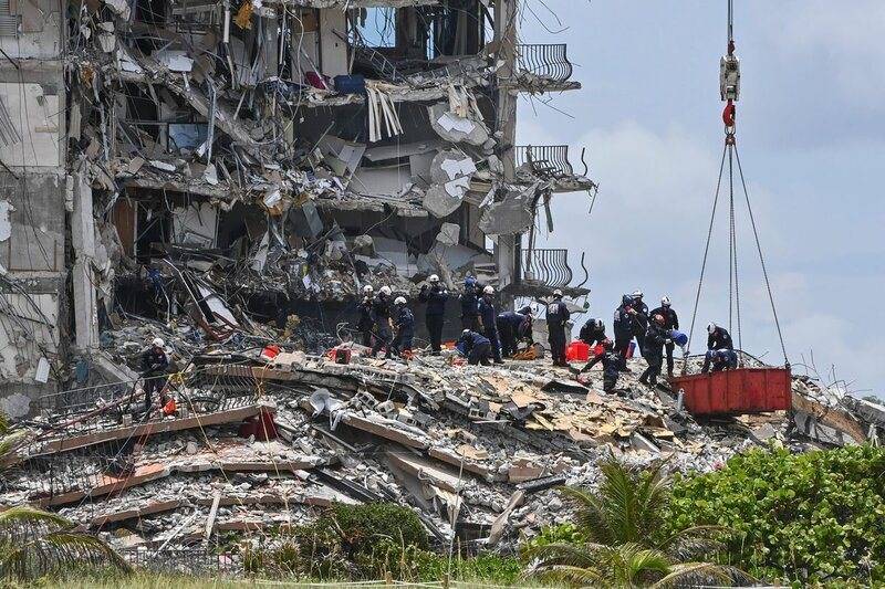

Structural failures are rare, but they do happen, and when they do engineers like myself want to know why. Afterall, we follow various strict design codes, e.g., ASME BPV code, which was established based on understanding failures in the distant past before such codes existed. Similarly, there are building codes that exist to ensure site characterization is appropriate, building design and materials are appropriate, construction methods are appropriate, and building maintenance (including periodic inspections) is appropriate, . . . . Maybe there are deficiency in one or more codes/regulations.
Residential buildings should not collapse, especially where there is not dramatic force like a tornado, hurricane or earthquake. If however, there is water, especially seawater, intrusion, or a ground is unstable, then that needs to be determined, and the matter addressed.
Something went majorly wrong under Chaplain Towers South. It could have been an initial design flaw/error, or materials, or environmental degradation, . . . . , or a combination. There were yellow/orange flags (alerts/warnings) and red flags (MC findings, and more recent observations), that went unheeded for too long, or otherwise, delays in addressing the problem because it cost too much.
We have to wait until the literally get to the bottom of the structure. If it si determined that a sinkhole developed, then we have to ask how and why, and also why such a structure was build on unstable ground. If seawater infiltrated the foundation, we need to know how and why, especially given the MC report indicating extensive damage that need immediate or near-term (months, not years) remediation. The MC report also flagged what appeared to be superficial damage to walls, concrete on balconies and exterior walls, but the more serious damage to the foundation (concrete cracking/spallation and rebar corrosion) was not addressed.

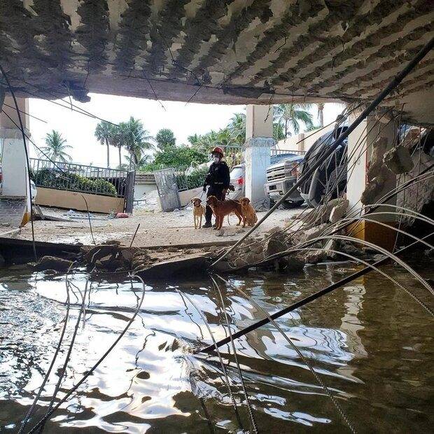

I don't believe failure of the pool deck would 'take down the building', but rather whatever caused that part of the structure to fail is probably related to whatever caused the building to fail. If there was a dramatic collapse, e.g., a sinkhole developing, under the structure, it might have been enough to undermine the pool deck/parking garage and the building foundation at the critical spot. The part that is still standing would seem to be on firmer (maybe drier, or less saturated) ground, and even the eastern most portion may have remained standing had the initial failure not pulled it off-balance.
Investigators will have to get down below the foundation to find out if subsidence or collapse of the geologic formation has occurred.

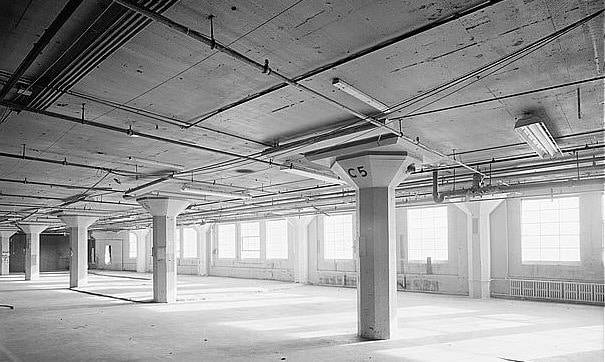

See this demolition from CDI, also in Miami.
For those that don't want the whole deal start from 18:00
You will see there in action what I told here before , they detonated a single column on a structure that judging from the video seems like a on site cast reinforced concrete structure with vertical columns and floor slabs all being monolith.
And from what it seems the part where the column was cut isn't even at the top of the building where there would be much less gravity load on the column but rather at the lower part of it.
The building did not collapse afterwards , instead the vertical load of that column was distributed within the floor slabs that connect to it to adjacent columns.
I would argue that for a properly built reinforced concrete structure the loss of single column should not result in structural failure.Now in the Champlain towers case there were no explosives and no single column was detonated or cut, so I think that even more my argument holds , even a column in bad shape with rusted rebar etc, cannot lose it's vertical loading capability suddenly and abruptly and all at once.
The only way I see a column could lose it's loading capability completely and suddenly is if it lost ground beneath it.
Also I want to point out that the tower wasn't that big and I would argue that it's structure had the same level of wear throughout it with some part probably being worse and others better. Now if the tower itself , not the ground beneath it or other factors but if the tower itself was supposedly in such a critical condition then how would one explain the argument that half the structure survived the collapse of the other half?
For panel structures that would be easy because panels are welded together which is their weakest point and they usually separate at those points during a collapse. So in the many famous Russian gas explosions in panel concrete apartment structures one can see that only the portion above the weakened part collapses.
But the Champlain tower was a cast monolith reinforced concrete structure so each column was connected to every other one through the floor slabs. When half the building came down at that point the lateral pull on the other half through the rebar and floor slabs was probably immense not to mention the vibration from ground impact etc. Yet the structure is left standing and that seems like a clue to me that the structure itself was maybe not in such a critical condition and there could be other factors that led to it;s partial collapse.
Surely don't take any of this as truth I am just expressing a knowledge based guess here

ps. as for the PT rebar discussion I think I saw drawings of the towers somewhere online recently at also from the live pictures it seems that all was regular rebar.
Also from what I know PT rebar is almost never used in vertical columns because columns are already under a compression type of load mostly. I think PT is more for longer lateral spans
