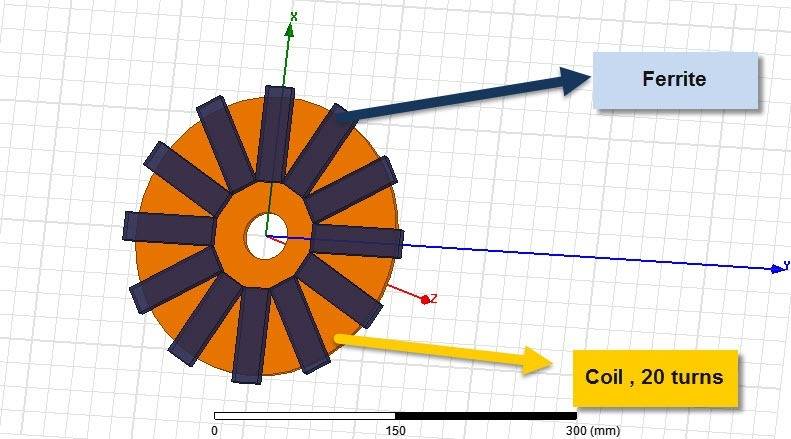

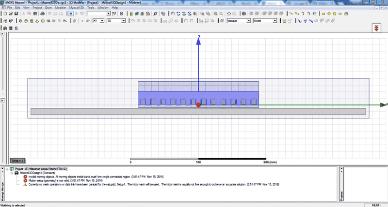

Hi everyone
I'm working on this structure, I’m using Transient and Magnetostatic solvers. Please answer my following questions:
1-for some reasons I should split this structure to just one pie of 1/6 size, after using Boolean, which boundary conditions should I use?2-Im working with Simplorer, but in Transient and Magnetostatic solvers, there is no information about resistance of coils, how can I add resistance to the model in this kind of transient-transient Link with Simplorer?
Thanks a lot .
  • #218
Q1,
I would suggest to use the full model instead of 1/16th. The region will normally be a rectangular. When you cut the model into 1/16th, the region will be cut into the same shape because the coil current excitation surface need to meet with the region boundary. I haven't used other shape region, not sure if this will work. Assume it can be done, but It will be very difficult and confusing to use because you need to use amper-turns to the surface, not just the ampers. You need to predict the H filed direction, and assign the boundary either perpendicular or parallel to the H field. The default it tangent (parallel)
Q2,
If you specify your winding coil (conduction path) as stranded, you need to specify DCR value when you assign current excitation. If you specify your winding coil as solid, Maxwell will simulate the DCR value and the result will be used.
Not sure if this answers your questions, but it is the basic to start with. I don't use Simplorer, not sure how it works.
Likes juvefansir

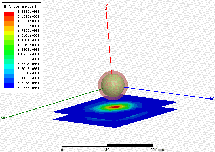

Hi all,
I am using Ansys Maxwell for magnetostatic simulation and I have plotted the magnetic flux density (B) for the whole system - Linear generator - permanent magnet. I want to calculate the magnetic flux denisty of the air gap alone. I am not able to find how to do that.
When I plot B, it gives B values for the whole linear generator. Is there any way to export the results of B? Thanks for your reply
  • #225
B value (H, J for the same) can be plotted along a line, or at a point for specific value.
In order to see the B value along a line, you need draw a line using the line tool. You can add a line as non model so you don't have to solve the simulation again. Once you add a line, go to Results -> Create Fields Report -> Rectangular Plot, then select the line from Geometry menu on the top left. On the right, Calculator Expressions -> Mag_B.
You can export the 2D plot to a data table. Or you can plot the data table similar as you plot 2D curve.
  • #226

I've modeled a linear induction motor in Maxwell3D. Selecting the "Translation Motion Type" in "Motion Setup", I face the following set of errors:
Maxwell3DDesign1 (Transient)
[error] Invalid moving objects. All moving objects inside band must form single connected region. (2:36:21 PM Nov 14, 2016)
[error] Motion setup (geometry) is not valid. (2:36:21 PM Nov 14, 2016)

I don't have access to Maxwell and couldn't recall any details, but such kind of error sometimes indicates that due to the movement of your object, they are out of defined region. Try animation to see the movement, and see if all objects are still within the region after moving. I could be wrong though.

Could you please describe more. I have attached a view of my model to make it more clarified. In this model, for example when I set the motion setup type in "Rotation" around Y-axis, there are no faults. And I don't understand the meaning of the error: "[error] Invalid moving objects. All moving objects inside band must form single connected region". How can the all moving objects inside band form single connected region?

You have the purple rail inside another object and these are touching never have objects touching unless you define the boundaries , make it bigger so they don't touch. When you have two separate bodies in linear motion it gives the error you say, you must enclose these objects in a band and make a bigger band as moving band that encloses the band and moving objects. Otherwise make the moving region longer or the duration of the simulation shorter so the rail doesn't hit the band border.

Thanks a lot. Seems that the problem is solved. I made a bigger band that enclosed the former and assigned the bigger one as the moving band.
