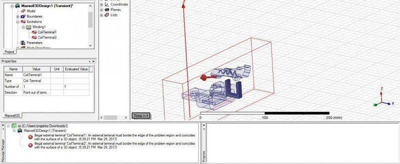

Hello everyone,
I am really new to Maxwell and I'm having problems simulating a simple transformer for a junior university project. :confused:
http://i.imgur.com/11kSlKw.jpg - a simple drawing for reference. I made the actual drawing in AutoCAD 3D and I want to simulate some things in Maxwell.
Steps I take:
1. Import the 3D model
2. Assign all materials (copper and steel with custom B/H graph)
3. Create an external circuit in Maxwell Circuit Editor (actually there I create 3 separate circuits in one drawing with the windings and other elements and voltage sources - I don't connect them magnetically (mutual Inductance) because the coils are 3 and the block for inductance is 2 windings only but they import successfully in Maxwell).
4. I create sections for the coils on my drawing via Modeler > Surface > Section and Modeler > Boolean > Separate Bodies
5. Select all sections and right click > Assign Excitation > External Circuit (and I add the circuit)
I saw these steps in a tutorial.
My problems:
1. How do I specify the number of turns for the coil (for example 300?). Since I am using an external circuit do I have to click the sections and 'Add Coil Circuit' to specify turns to different coils?
2. Do I have to set up any currents because I give the voltage and some resistance elements in the external circuit and Maxwell should calculate as needed?
3. I get this error for the transformer body (probably about it or because of wrong coil design in external circuit?):
http://i.imgur.com/NP6s9gd.png
Do I have to specify anything else for the body other than material and that it is laminated? Maxwell doesn't give me the option to create a section. When I try it creates a section in the same plane as the section of the coils and it looks like a lamination sheet instead of a cross-section of the body?
Would really appreciate your help! There are not many tutorials and some are not full. :cry:
  • #197
Simple thing first,
For the error message, second one is normal. You are using transient solution, so it tells you that only initial mesh will be used, meaning the mesh may not be fine enough, the result may not be that accurate, but, generally acceptable.
For the first error, do you have a region defined?
For others, I recommend not using the external circuit, just specify the excitation source as current. Run the simulation and see if it works. Once you sort out all the bugs, you can then introduce the external circuit as the excitation source.
For transient solution, you specify the turns on the terminal (number of conductors). For Magnetostatic, you specify in the Matrix properties.

when simulation finished I cannot see any result!
For instance I cannot read any J field or other values on the "results" or "Field Overlays" when I select them from the object
Can anyone help how I can see results?
Thank you in advance for any useful information / suggestion
Best regards
