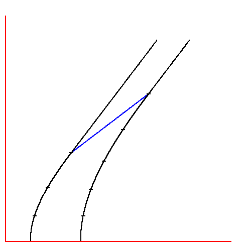

Aha! I have a drawing of the string problem. I didn't know where it would be reasonable to draw the string, so I just drew the rockets.
The red frame is the frame in which the rockets are initially at rest. The green frame is some other frame -- it's not precisely 0.5c: I picked a velocity in which it was convenient to program.
The origin of the green frame occurs where the leftmost rocket happens to be at rest in that frame. (plus or minus a pixel or two)
The black lines are the two rockets.
For fun, I've drawn the exact same picture twice. They represent exactly the same problem -- I just chose two different methods of drawing them in Euclidean space.
(I've gotten the drawing slightly off -- but it looks qualitatively the same as the true picture. I can fix it if you really disbelieve)

Hurkyl said:
Point at an actual mistake. I've worked the problem, and got results. If you think the result is wrong, that means I've made a mistake in my work. Show me that mistake.
You're switching to the string problem now, and not the two-clocks-on-one-rocket problem? Are we considering a version wher the rockets eventually stop accelerating, or one where they accelerate indefinitely? I'm going to assume indefinitely.
I can't really make heads or tails of your post. Too many things are simply nonsensical.
Let F0 denote the reference frame in which the rockets are initially at rest.

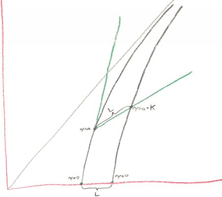

?? You haven’t recognized the string with the front attached to a clock in one rocket the back attached to a clock on a following rocket is essentially the same problem as your two clocks in one rocket problem? If you don’t get that no wonder I cannot make heads or tails of your complaints. Neither problem calls for stopping, and I didn’t ask for them to stop, just a revelation of an instant in the future when the two were in the frame that moves at 0.5c with respect to your F0 frame.
As to “point at an actual mistake”, here’s the best I can do for you.
Instead of having the two rockets take off at the same time and acceleration from F0; take the point you’re making your measurements from in F0 and accelerate that in opposite direction you were going to send the rocket(s). When you work this problem and graphs your results from that point you will still get the same results of clocks running at different rates or the string breaking (or getting slack). Even though in this example the rocket(s) haven’t even moved, but do appear to be accelerating from the relative measure of your observation point. The clocks, or string, in fact could not do that as they didn’t even move.
IMO the reason that such effects can look correct, come from the same errors that are often made in thinking “The Twins” don’t age differently, that was my first mistake I held with conviction for awhile when starting out in understanding relativity. That taught me to very careful about simultaneity issues. The approaches I’ve seen here do not do that IMO. If you do not agree with that, then there is little chance we will ever agree with each other on this paradox, so we should just end this.
  • #78
I can't tell from a quick glance if either RandallB or Hurkyl believes the other is arguing that a string stretched between two observers in the Bell congruence would not break (in fact it would), much less whether either is in fact making that claim.
Still trying to spread oil on the troubled waters: it is quite possible you two don't actually disagree about anything, just that some misunderstanding arose, probably from being insufficient precision in describing a thought experiment.
  • #79
That just says you need more than a quick glance.
Hurkle is actually talking about a single rocket with two clocks; I see that as including the problem of the string. Provided the whole rocket accelerates uniformly; so that we do not have to deal with "jerk" (acceleration of acceleration) compression oscillations going up and down the material the rocket is made of.
I assume you agree with him that two clocks on one rocket would run at different rates of time; along with somehow defining gravity on Earth as constant as altitude changes and that you both think the string breaks.
As I just said in my prior post if you use an accelerating observation point and frame give you the same results even though the rocket or string doesn’t actually move.
With just a quick glance, you are only contributing or voting your preconceived notions, not putting oil on the water.
As I’ve said, if you guys do not think a more rigorous treatment of simultaneity is called for on these issues we will never agree. If so I’m willing to leave this and simply say that there is a chance that Hurkle is as right as I am, and I might be as wrong as Hurkle is.
  • #80
Of course I don't: they aren't the same problem. They aren't even analogous problems.
In this picture, I've drawn three problems.
Problem 1:
On the red coordinates, I've drawn the one-rocket-with-two-clocks problem. The two black lines are the worldlines of the head and tail. The gray area is the worldsheet traced out by the rocket.
Problem 2:
On the green coordinates, I've drawn the two-rockets-and-string problem. The two black lines are the worldlines of the two rockets (assumed to be point-particles). The blue area is the worldsheet tracet out by the string.
Of course, if you so desired, you could combine the two problems into one grand problem:
Problem 3:
On the blue coordinates, I've drawn the two-rockets-and-string problem where I've treated the rockets as extended objects, rather than point particles.
Why do you think such a thing exists in the two-rockets-and-string problem?
I don't follow. F0 is a frame. Frames assign coordinates to every events. My measurements are the coordinates assigned by F0.
Although I'm not sure just what you mean, it sounds like you are telling me to measure things with respect to some noninertial "frame" F2. It's not clear to me exactly what noninertial frame: I think you're telling me that the t-axis should trace out the path of a hypothetical uniformly accelerated particle that started at rest at the origin of F0... presumably so that F2's time coordinate coincides with the proper time experienced by the hypothetical particle. But I don't know how you want to assign coordinates to the rest of Minkowski space.
Care is good. But I don't understand what you find lacking in my treatment, nor do I see rigor in yours.
Look at this picture again. My biggest "Eureka!" moment for SR is essentially that you don't have to Lorentz transform into the green coordinates in order to figure out the length of the rocket at t=0. Length, as measured by the green frame, is nothing more than the proper length of a segment of a line of simultaneity. That segment is indicated in the middle of the picture. I know how to compute that proper length using the red coordinates, so I never have to bother with a Lorentz transform.
(as always, green text indicates things relative to the green coordinate chart)
This led me to realize that SR is a geometric theory, and it eventually sunk into my head that only Lorentz invariant quantities matter -- everything else is just an artifact of how you're analyzing the problem.
I worry that your approach is fundamentally misguided -- you seem to be extremely insistant that one chooses their coordinate frame properly, and keeps switching between frames to analyze different parts of the problem. But a choice of coordinate chart is completely aphysical: it has absolutely no bearing on the problem. If you get right answers by doing it, then good -- but I fear you are completely missing what's happening in SR!

I note you did not draw the diagrams as seen from a single point on F0 from the view of accelerating that point (and its reference frame view of F0) in the opposite direction without moving the clocks or string at all.
Also the fact that you can fit the clocks and the string onto a single diagram as you did is proof enough that the two are related problems.
OH, but wait you did give three diagrams from the view of an accelerating point without the clocks or string moving at all.
The same three diagrams you gave for holding the observation point stationary. This must prove that string tied to fixed points will break spontaneously! I’ve put up a sting and am waiting for it to break, but no luck so far. Maybe it means that it won’t break unless some accelerating observer goes by and actually looks at the string and its attachment points! But that would mean the moon is not really there unless someone looks at it, and I don’t buy that view either.
As to the frame for speed 0.5c of course both clocks must eventually be in that frame, what are you thinking. The only question is at what point and time in that frame is clock A at a speed of zero in relation to that frame, it can only be a single point and time and what time is on clock A as well. Likewise for clock B, it cannot be the same point in the 0.5c frame. So now how do the numbers compare; is there a difference in time in that frame for those two points? What is the distance between the two points in that frame? And how does the time on clock A, compare to clock B?
It takes detail like this to understand the twin’s paradox, and you simply haven’t gone though enough detail to come to a convincing final conclusion on this problem.
You are just repeating the same pattern and answer as before, which IMO and a moving F0 doesn’t work.
Problem 1:
Problem 2:
Just wanted to point out that these are respectively what I called the Rindler and Bell congruences. As Hurkyl says, these are distinct congruences, which is rather Bell's point. If you know that the Rindler observers are rigid, it follows at once that the Bell congruence must not be rigid! And it is not; the string must eventually break, as Bell said. See the version of the WP article "Bell's spaceship paradox" listed at http://en.wikipedia.org/wiki/User:Hillman/Archive (more recent versions might be better, or might be much worse; several physics Ph.D.s plus myself spent months unsuccessfully trying to persuade a dissident WP editor not to munge the version written mostly by myself and Peter Jacobi).

Hurkyl is correct; these are two distinct congruences and that is the point of the "paradox". The Rindler congruence is the rigid one; it is the pseudoeuclidean analog of a family of concentric circles, so of course the inner hyperbolic arcs in the Rindler congruence have larger path curvature. The Bell congruence is not rigid; in the version of the WP article "Bell's spaceship paradox" which was written mostly by myself and Peter Jacobi (see http://en.wikipedia.org/wiki/User:Hillman/Archive) I computed the expansion tensor of the Bell congruence, which clearly shows why the string must break.

Wow you are having trouble following the problem.
If the distance between the two Bell observer clocks as call them, is viewed as shorter, and the length of the string between them is also shorter, why would you think I'd ever suggest the string would break?
You are correct though, I should have edited that post better – should have had a guest ion there … do you expect it to break or ... using one or the other observation point? But I’m sure Hurkle can tell where I disagree.
As to “congruence” apply it to an F0 observer’s view of the two Bell observer clocks with a string attached between them; but with the F0 frame accelerating and the two clocks remaining stationary. You will still see the string break, which is why I think Bell got this one wrong.
  • #98
I don't know what you mean by "FO observer", and because you neglected to write down any congruences, I still don't know if you understand what I mean by "Bell observer" and "Rindler observer" (see Hurkyl's diagram for the gist).
The standard "spaceship and string paradox" involves a string stretched betwen two spacecraft whose worlds lines belong to the Bell congruence, not to the Rindler congruence. In both congruences, the world lines are hyperbolic arcs, i.e. have constant path curvature along each arc, just as circular arcs have constant path curvature in euclidean geometry, but in the Rindler congruence, not all the arcs have the same path curvature, just in the analogous euclidean congruence, a family of concentric circles, the inner circles bend faster than the outer ones.
The standard way to study congruences in (semi)-Riemannian geometry is to compute their kinematic decomposition (acceleration, expansion, vorticity). This shows that the Rindler congruence has zero expansion (we say it is a "rigid" congruence), but the Bell congruence has nonzero expansion.
Physically, this means that a string stretched between two Rindler observers will not be stretched by the relative motion of these observers, which initially strikes many as odd because the trailing Rindler observer is accelerating harder than the leading Rindler observer!
OTH, a string stretched between two Bell observers must eventually break, because the expansion tensor of the Bell congruence shows that positive expansion along the direction in question. IOW, because the trailing Bell observer is accelerating with the same magnitude and direction of acceleration as the leading Bell observer, comparing with the Rindler congruence, we see at once that the string must suffer unbounded stretching, so it must eventually break. This is just Minkowski geometry; only the physical interpretation of Minkowski geometry (due to Minkowski) involves physics.
So this is why it is crucial to understand whether you are claiming that a string stretched between two Bell observers must eventually break (correct), or that a string stretched between two Rindler observers must eventually break (incorrect). Bell was talking about the first scenario, and he correctly concluded that the string will break.
