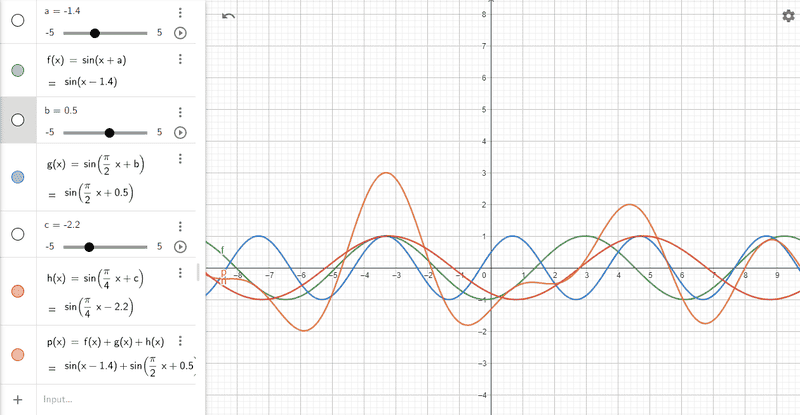

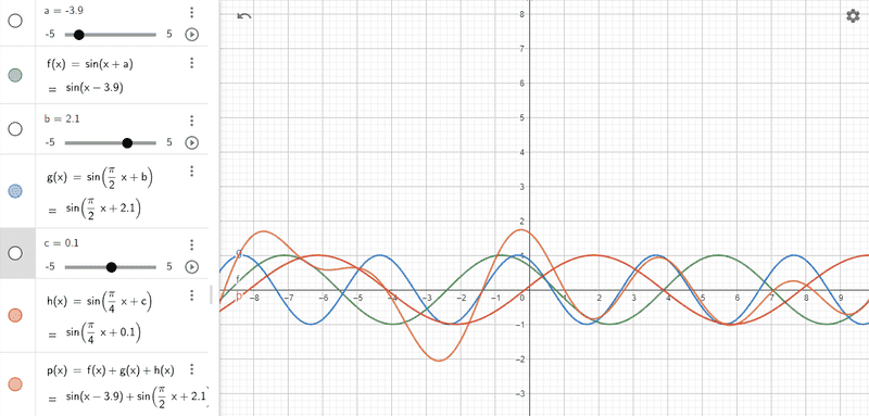

Hello !
I've got a problem understanding the pickup ? or the sound ? I don't know I got very confused. I wanted to learn how to make guitar effects although I don't know much about music but I wanted to make. On this website : https://sound-au.com/articles/guitar-voltage.htm Here the Peak voltages of E1 is 100mV and E2 is 300mV, the thing is when there is a chord, I guess it is a E1 and E2 played at the same time so E1 + E2 is 300mV it is the same as single E2 which is also 300mV. That doesn't make any sense to me ... So single string makes E1 sound, and another single string makes E2 sound but playing both strings E1 and E2 makes the same sound as E2 ??????
Second thing is my experimentation. I know about interference and phase shift of the signals. But interference means that the sinewaves must add up to each other right ? Here are the images and the link : https://www.geogebra.org/graphing/merap3ws, so the orange function is the sum of 3 sinewaves (f(x),g(x),h(x)). So f(x) is let's say E1, g(x) is E2 and h(x) is E3 so we have 3 strings (guitar has 6 strings the classic one).
We play all 3 string at the same time so we have 3 sinewaves adding to each other sometimes the sum exceeds value "1" which here it is "3". How does the pickup makes these sound into voltages ? for peak sound "1" it is 0.7V or for peak sound of "3" it is 0.7V ? The maks that pickup can make is 1V but I said 0.7V because it is easier. How does it work ??? What if we have sound that has "20" as a value how does the pickup changes the sound sinewaves into voltage sinewaves ?
Hence I couldn't understand why the output of the guitar is maks 1Vpp or 1V I guess ?
I got so lost because these sums are exceeding this value of "1" and how the pickup "knows" what is the pick of the sound or when he uses maks voltage, when the sound peak is "300","3000" etc ? The sums of the sinus can be alot.
PS. If it's possible to make is simple for goofball like me.

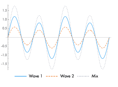

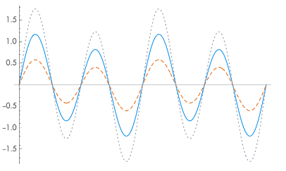

https://www.informit.com/articles/article.aspx?p=2355856&seqNum=5
Here I have found something interesting.
The author says that sound that add up using superposition and scales it to +1 and -1 so even if we have a sound that exceeds the value 1 after superposition it is scaled back to +1 and -1 as if adding more sound at the same time makes all individual sound smaller than originally.
Let's say I play E1 and the E2 they have amplitude of 0.3V but if I play E1 and E2 at the same time the final result is the same but E1 and E2 have smaller amplitude than the individual sounds.
Weird that adding sounds reduced their individual amplitude.
PS.
Although here the two so waves added exceeds value "1" and aren't scaled to +1 and -1. So I am lost here when it comes to exceeding some value of amplitude. Or how superposition works in pickups or how Vibration that is similar to the sine wave sound because it creates the sinus signal must add up but never exceeds value 1V wierd
That's a choice by the programmer. Physical waves (as in waves in the real world, not in a computer simulation or formula) do not automatically scale in this manner. In fact, you can see this in Berkeman's link in post #4.
Unless you are artificially scaling the sum of the two tones in some manner then they will not have reduced amplitude. Indeed conservation of energy forbids it. Imagine 100 violinists playing slightly different notes. It's going to be LOUD despite the fact that the notes are all different.

I saw the Berkeman's link and it shows that the two sound signals surpassed the value peak of "1". So how the pickup reduces it so it sounds the same.
What if the whole sound made of many sounds like 20 frequencies added to each other made that peak value is not "1" but "10" and the smallest value is "2" so the pickup sees that maks value is "10" and smallest is "2" so the output will be just a constant 0.7V output xD.
There must be some correlation to the sound value because adding each frequency must make some difference when the amplitude exceeds the values. Adding more frequencies will exceed the peak and the lowest value even more.
The pickup doesn't reduce anything. It simply outputs a voltage based on the motion of the strings. Different notes can produce a large range of voltage outputs. For example, in the reference in your first post, the measured RMS voltage output in the first table of results varies between 12 mV and 128 mV depending on the note/chord and the pickup position. And this was in a controlled experiment. A real guitar would probably be subject to a much larger difference in min-max voltages depending on playstyle and such.

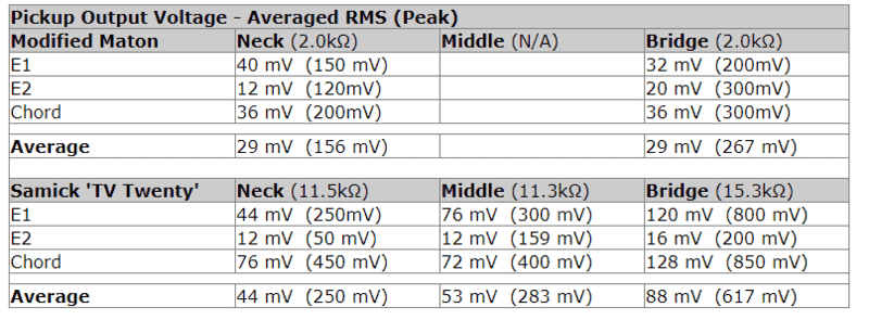

I wouldn't take these results as being 100% accurate. Without some machine to physically pluck the strings such that they vibrate the same for each test the results must be taken with a grain of salt. To quote the article:
"I tried to be as consistent as possible, but it's not easy. Every time you strike (or pluck) a string it will be a wee bit different. While it might sound very similar, the oscilloscope is totally unforgiving, and will show every tiny difference in the harmonic structure and the overall wave-shape. It's not really feasible to take many waveforms from each string and try to generate an average, as one ends up with a vast number of files that must be relevant to each test. This gets very messy, very quickly."
And:
"The oscilloscope shows the RMS level averaged across the full four second sweep, and while it's not particularly accurate, it is a useful indicator of what you can expect."

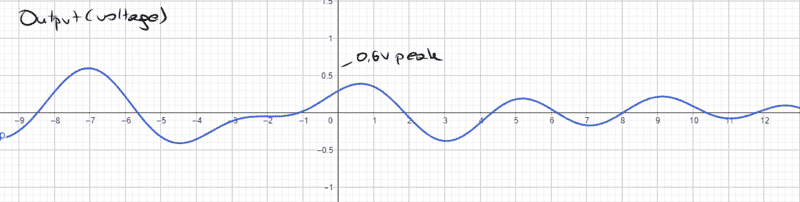

Okey but the pickup interprets high amplitude of the vibration ?
Like I've said before and looking at some pictures the amplitude of a sound/vibration exceeds the value "1" when there are multiple sounds/vibrations. How the pickup will interpret the vibration of a amplitude which pik is "100" in value and how it will interpret the different sound of a amplitude of value "10" ???
The amplitude value is inconsistent to what max pickup value can give. And the pickup is recreating the sound the strings vibrate. So the sound from vibration is the same at the voltage we get atleast the shape is similar/same. So what about the amplitude of vibration which is similar to sound because they add up so they exceed value "1" like "100" or lower but still how pickup interprets them ?

You really are confusing yourself.
The signal from the pickup, is the voltage between two wires, that appears across the resistance at the input to the amplifier. That voltage is the linear sum of all the movement, of all the strings, many different frequencies and each of those with a different amplitude varying with time.
Power is proportional to the square of the voltage. So we square the voltage, then take the mean, which will be positive. That mean is proportional to the power. We can find the equivalent positive voltage by taking the square root. That is why the voltage amplitude of an AC signal is called the RMS voltage, the Root of the Mean Square of the voltage.
If you take the combined signal, and measure the power of each frequency separately, they do sum to the total power of the combined signal.
Because energy is conserved, it is the square of voltage that is important.
When; a² + b² = c² ; it does not follow that; a + b = c .
The peak voltage amplitude of the combined signal is misleading, because you are summing in the voltage domain, not the power domain.

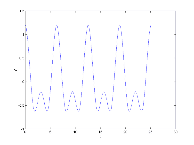

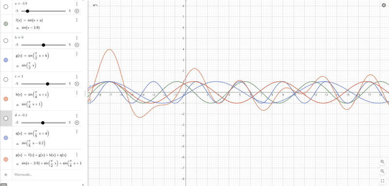

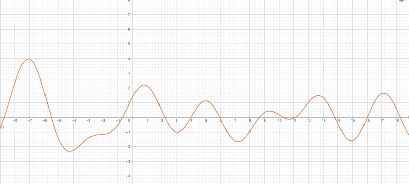

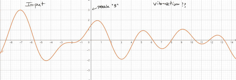

But mainly let's use an example, because it might get easier.
This is the vibration of 4 sounds. The peak is "4" (I don't know the unit of the sound/vibration so I just say "4"), it consist of 4 sounds so adding them will result in this orange signal. It is correct to the superposition linked in post #9.
- So is this orange signal a power ?
- Will the pickup voltage signal will be similar to this orange signal ?
- What will pickup do to this "4" peak ? What will be the value in voltage of that peak ?
- Will a different peak like "10" have similar voltage value like "4" peak ?
- What has power domain to the voltage domain ? If orange signal is in power domain so square root of that top value will result in "2" (I might be wrong here).
- here I saw something about RMS but still peak is "4" RMS = +/- 2.8. It's a mean value in AC because normally mean value of the sine is 0, but yea RMS is a mean value for AC signals.
So I wanted to understand it using an example. Example that some sources provided like superposition of 2 signal and more or the link of the voltage value from the 1st post. I just wanted to know what pickup does to very high peak values.
Or maybe you are telling me this, but I just don't find it connected to my question or something. Because I asked about what happens to the peak and I read about power ;D Don't get me wrong here I just don't get the explanation because for sure I can't properly ask a question or my examples aren't clear so yea ;D
No, it is a sinusoid that goes negative, so it is not power.
The instantaneous voltage is 4.
I have no idea what that sentence means. "10" what, "4" what?
A number without units is meaningless.
If it is linear, it does nothing to them.
The peaks are nothing special, they are just coincidences in time of positive voltages. But they have fascinated your mind, and are now a distraction from everything that is important.
Plot a sinusoidal signal voltage.
Plot the square of that signal voltage. You will get a sinusoid, above the x-axis, with double the original frequency, that represents energy flow.
Now integrate that squared signal, divide by time, and you have the power of that original signal.

@Xenon02 i suspect you are getting confused for several reasons. The first is that doubling voltage does not equate doubling power. You need to realize that a vibrating string is being represented as a voltage. Doubling voltage quadruples power. Striking two strings instead of one is not quadrupling power. Math doesn't lie.
Likes berkeman
That's why I used example to see it.
What power ? What doubling ? Where did I confused/said that doubling the voltage equals doubling power ? I just showed what vibrating string gives which is the orange signal. How the pickup interprets the orange signal received from vibrating strings into voltage signal ? I sit the same ? How it interprets the peak of that vibration when it's value is "4" (I don't know the units).
The pickup receives the whole orange signal with this peak value of "4" and must transfer it into equivelant of the voltage signal. Pickup maks output voltage can be 1V. And pickup receives the input signal from vibration so the magnetic field movement and transfers this movement into voltage.
I still don't get it, so that's why I used the example so it would be clearer for me if it was used or rather say what is wrong or confusing in my text because I often refer to peak values of the input signal from vibration/sound wave received by the pickup, and how pickup interprets that input and makes it into output what happens to the peak value of "4" from then input when the max output signal can be 1V or 0.7V.
I don't know what do you mean by power here when I see only orange signal that is not the power nor the voltage signal it is just the input for the pickup that is made from the vibration, the sum of these vibrations is the orange signal so the pickup must change this input into voltage output. But the input has some high peak values which is "4" or can be "10", "1000" etc. But the pickup can have maks 1V output.
It is not logical that the peak values received by pickup doesn't match up with the output voltage. I don't see it. Neither I don't know where the power here shows up in the signals I just use the whole signal and not the mean value so I don't understand why power came up here, when I was talking about input and output signals. In which output is voltage signal and the input is the vibration signal both have the same shape but different amplitude.

Could you tell me then what my orange signal represents ? Because I guess this is an input from vibration yes ?
Because for now I understand that 1 string is X watts and 2 strings is 2X watts. So 1 string = X watt = voltage, 2 strings = 2X watts = not 2*voltage, not 4*voltage it is <2*voltage.
So why in websites it showed the sum of those sinuses and the peak values etc where that high, if I can know.
I also understand that 4x watts = 2*voltage (RMS and PEAK) ?
Again then what my signal represents ? And is it correct ? What will pickup do to this signal ?
https://nsinstruments.com/principles/linear.html this links shows signal that his maks value is 1.5
So It doesn't have units so I don't know what it is then. Or rather how to interpret it when you've said that 2xPower = 2 strings, here are 2 strings let's say stroke.
Similar with my example from post # 19. So yea how to interpret those ?
I don't know what your orange line represents and I'm not going to bother trying to find out. This is your project and if you are unable to conclude what you are looking at then you have no chance of designing circuits to create guitar effects. I assume based on your first post that this is what you want to do.
Ohms law should tell you what you need to know assuming you know how to apply it concerning volts vs watts in your plot.
E=IR
P=IE
The other formulas that are commonly known and used can be derived from the above two.
What I tried to represent with my orange signal/line is that the signals add up like in the links I've provided :
https://nsinstruments.com/principles/linear.html , and from stackoverflow : https://physics.stackexchange.com/questions/495511/vibration-in-a-guitar-when-playing-two-strings in which you can see that the final signal looks like :
It is not voltage it is the vibration/sound wave. So This is what pickup receives and it doesn't calculate with the math you've said. Or as far I know. I'm not trying to the one who annoys everyone. I just see some conflicts in the logic of voltages and the input the pickup receives like the blue signal I sent now or my orange signal. The peak values where the thing that worried me because how a peak value from the sound is now received by pickup which maks voltage he can make is 1V ...
No one in the links says a word about what it is other than that is a sound/vibration wave/signal.
Dunno how these equations will help me or how to use it in practice.

Xenon02 said:
How the pickup will interpret it ? As I said I just did what in other websites/videos did. So I am trying to use the example to understand it because without it I am lost.
If the pickup ( and the amplifier plus scope) has a fast response (wide bandwidth) then it will produce a single varying voltage (only one trace on a scope) which will correspond to the vibrations on the strings added together at each instant. If the pickup cannot respond fast, then (as when you hear the beats between two notes) you will see a wavy trace that changes in amplitude. The fast waves will be the pickup's attempt to chase both waveforms.
  • #36
The pickup is what actually is summing the other signals to get the orange one.
But the input must be also a sine wave / waves am I wrong ? The pickup pick the vibration and the vibration itself must be sinus wave/waves. So I though from the link and they said that the sound/vibrations are these sinuses and they add up resulting in the single wiggly signal, which the orange signal was supposed to represent.
Hence the orange signal was supposed to be the vibration signal received by the pickup. So the output that is processed by the pickup with the sinus waves signals he produces the voltage equivalent. But still the input must be sinus waves or am I wrong ? If so is there any info about it somewhere ?
You get it what I try to say here ? Like vibrations are also sinus waves if so I just made one with orange signal that has it's peaks without units because no one mentioned in the website about it.
But still interesting intel to get. But still want to confront what I read/understand/drawn with how other says, from websites as well. Because I guess my understanding isn't that incorrect but still doesn't make sense with the output max voltage value to the input values represented by my actual understanding which is the orange signal/function representing the sum of couple of the string vibrations.

According to this : https://sound-au.com/articles/guitar-voltage.htm
E1 and E2 at bridge were very similar. Sometimes even E2 is smaller than E1.
At bridge the E2 has the same amplitude as chord which I guess consist of all 6 E sounds.
But I don't know if what you've said answered it. The vibration itself is also a sin wave as I understand. Many websites shows some sinuses adding up, and even in stackoverflow they've added 2 sinewaves with different frequences in result they've achieved value of "1.5" of something. I understood that this result is the input, and the output of the voltage is unknown.
How do the sounds mixs up so the amplitude doesn't skyrocket is wierd, because in examples I see they do exceed that limit, still pickup somehow works IRL, dunno why.
I accepted what you've said about power and voltage but it somehow doesn't link with the information I've found so far or have missed somewhere that part in the websites/youtube videos.
So far what I understand is the following :
- Power =/= voltage
- Maybe the signals I see are the pickup ? Although the pickup maks amplitude is 1V or 0.7V.
- Signals/sounds do sum up, and can use superpositions.
What I still don't understand is :
- What is this unit in diagrams of summed sinewaves, is it an input or and output, if an output why it exceeds 1V, if input why it exceeds value "1", hence how will the pickup respond to high pick from multiple sinuses.
For example :
So for the sake I am not taking this out of nowhere :
Looks to me like input, because the output cannot be more than 1V, so pickup somehow must work on it ? How ? I don't know, but somehow the input signal is the same as output in volts so it is magic. It somehow scales it or something, dunno.

Weirder it goes when I saw this one : https://physics.stackexchange.com/questions/495511/vibration-in-a-guitar-when-playing-two-strings here they've added two sounds waves and the result was a peak pretty big, hence what will the pickup do ? "Reduce the peak" ? What rule is behind of it ?
Maybe my question is stupid and I should look at it like that but I don't know sounds like a good way to understand what pickup is receiving, and how to prepare op amp for the output voltage.
But also when reading I only see images with graphs of added signals but having high peaks, so there was only a question how pickup works with this then. or any other electric Device. If that makes sense.
  • #43
Xenon02 said:
Because it cannot exceed 1V peak.
You appear to be wrongly assuming, that all sine waves have an amplitude of ±1 volt, and that when several waves are added, they must exceed the dynamic limit of ±1 volt.
If one guitar string could produce a signal with a maximum amplitude of ±100 mV, then it would need 10 strings, played to the maximum, all at the same time, to make the maximum ±1 volt signal.
  • #44
The pickup will detect the motion of one section of the strings and output a voltage profile that is the sum of both strings. It might be similar to the 3rd graph if the pickup is located at the same place along the string that the 3rd graph is, but it doesn't have to be. If, for example, the pickup was located in the direct middle of both of the example strings, it would output a simple sine wave since there is a node at that location on the first string.

Perhaps, but looking at this site again :
So if 2 strings can generate 300mV like in the Bridge part, then 6 strings can exceed 1V for sure. If course they are phase shifter and have different frequency but at some point all peaks must meet somewhere and then all peaks add up which will result in high peak.
simple sine wave in the middle of both strings, node at the location of first string even though the pickup is right in the middle of 2 strings ?
Where is your math for this and are you assuming peak amplitude or RMS?
  • #50
That is irrational. If two produce 300 mV peak, then one produces 150 mV peak and six produce 900 mV peak. That is less than one volt peak, not more.
This is an electric guitar. If you hit every string at once, you would complain if it did not clip and distort.
