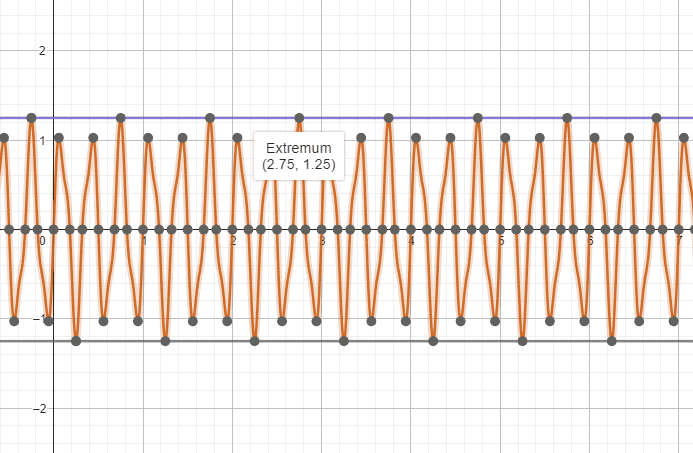

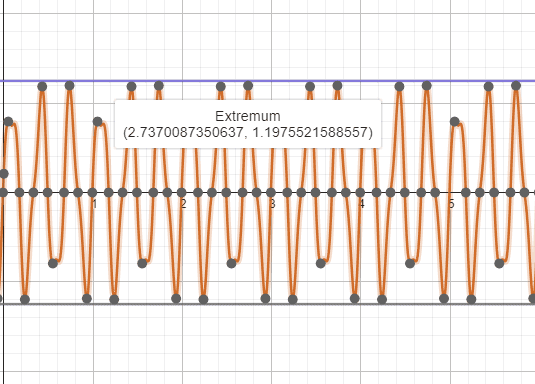

This is what I tried to say by using a two signals with different frequency that at some point the peaks must add up. If the two signals were the same frequency and had a small phase shift then their peaks won't add up ever, but this is a different story with two signals with different frequency.
But yea it is still confusing, looking at certain real values.

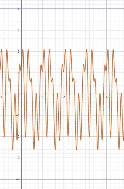

@Xenon02
You will have seen many different pictures of waveforms. The 'spikey' sounds from a guitar string have a waveform with distinct peaks - unlike all your smooth, sinusoidal examples. Two similar waveforms of that sort of shape will clearly only cause an audible crack then the peaks occur at the same time and add together. That is far more obvious than the subtle changes
in 'roughly sinusoidal' waves. An amp may produce very little distortion except where the spikes on two waveforms occur at the same time.

https://www.geogebra.org/graphing/merap3ws
So adding up will result in chaotic one. So the peak I saw most of the time were Y = 5.3, couldn't find Y = 6, it must have happened at some point but I couldn't find it.
But going into hand made like the one in the picture I will try to make it in paint if it's not a problem :
Changing the phase will make that peak of blue and read will match and appear as the Y = 100+200 = 300
I can change the phase of blue one so that it will match with the red peak value.
But even without changing the phase the peak will appear, somewhere ? Is it incorrect ?
I've recreated the effect in website and tried to explain what happens while shifting the blue or red signals. The website was easier to recreate but is also non-sinewave, it repeats at some point. So what is incorrect in the website version ? The Excel will be similar but with hand written values. Adding up the signal will result in similar effect like the handwritten one or the website one.
PS. My diagram from website I made is like this :
Which leads to the question if my diagram is incorrect ? Is my deduction also incorrect ? Yes, then why ?
I deduced that because E1 and E2 didn't add up is because there was not enough time ? the signal is long and for it to happen it takes time, or my signal is way to slow.
It's hard to deduce it having arbitrary stuff that's true ... But it just gives question why it did not happen, phase shift can only make this point happen faster or not.

You know what now I have found my fault here, phase shift indeed makes difference when it comes to adding. Because in my examples it happened that even if there was one full cycle the signal didn't reach it's peak (like sum of three sinuses which is 1+1+1 = 3 so here it was 2.8 ?). I thought that after one cycle the signals peaks must add up.
But ! Each cycle the values are different although the shapes are the same, so it implies that the peaks can meet up am I right ?
Two cycles are here so yea. Even though they look similar they have different values at top which is visible in the blue marked values, because they have different value.
Indeed my signals might not be correct aswell as you've said, don't know why their sum was always huge hmmmm : https://www.geogebra.org/graphing/merap3ws - it's laggy. But shifting the phase makes the top value reduce and the bottom increase.
So it is I think basic math but am I right that at some point the peaks add up after x-cycles ??
So I now know why adding E1 and E2 which are 300mV and 200mV might have not added up which was 500mV, although in my example they still where high, so the peak should have been like 350mV or something and it was only E1 and E2 but chord has E3 ... E6 hmmmm but I am getting to something I guess.
Okey just say if I am wrong or not. No matter the phases the peaks up will add after x-cycles at some point yes or no ?
Sorry for borring you here. I just saw something I just kept thinking was correct. But each cycle had different peak values so I rethinked it a bit.

I've made some arbitrary numbers to create a one cycle and copied it. After the plotting each cycle has similar shape but different value. Changing the phase changed the shape a bit. But there because each cycle had a bit different value but similar shape it
It's hard for me to deduce it ... Because when I was using sin(x + a), sin(pi/2 x + b) and sin(pi/3 x +c ) they very much changed the values drastically, and the tops overlaped less or more.
When I changed into sin(2pi x + a), sin(2pi *2x + b) and sin(2pi*3x+c) then the peaks were more constant ...
Here the green is pretty consistent, hence :
No matter how many cycles passed the peaks are the same and didn't reach value Y = 3. Which confuses me mathematically because I might be dumb here again.
I don't know now because faster signals should catch up to slower signals at some point so that peaks should match at some point and result in Y = 3 after x-cycles.
Now I don't know, does signals with different frequencies will always have that one point where their peaks add up ? In one example with sin(x + a), sin(pi/2 x + b) and sin(pi/3 x +c ) it showed that fast signals slowly catched up to slower signals so that peaks where bigger at times like in first picture, in the other example it showed that faster signals never catched up to slower ones so that peaks match up.
I am now confused mathematically, and can't deduce from making excel sheet nor with this graphical web. Whether the peaks of signals with different frequencies must add up no matter the frequencies (no matter means here that after x-cycles the peaks match, changing frequencies changed the time when this happens). If not I wonder now why when in one the fast one was catching up to slower one and the other it was all the time the same ......
Confusion lvl 100.

Phase changes the max peak value. https://www.geogebra.org/calculator/myxxzexe - tested with 2,3,4 signals. Each added with shifted phase could reduce the max amplitude, was able to reduce it to 2 max amplitude (dunno if I can lower it having 4 signals maybe different frequecies ?). Changing the faze I can get bigger amplitude, but not max which was Y = 4 (to big steps of the phase shift maybe).
Well so phases changes the peak. But there is still a question.
What is the max amplitude value of one string ? Do strings have different max values of the amplitude ?
Also it is a phase shift so E1 and E2 if happened that the phase was shifted enough to add 300mV and 200mV and other signals peaks, then it will for sure ? Exceed 0.7V and it is periodic so the distortion will be heard :
So playing the same chord can bring this distortion but it was mentioned it would be not heard although distortion is hearable in rock music (it has that specific metalic/cracking sound). Which videos show how it sound with and without distortion.
So yea it is probability that the phase will align so that all peaks are added (like E1 300mV and E2 200mV and other that are not mentioned). It is a chance.
If this question even have sens, then distortion happening when the luck will happen playing the same chord and add all peaks. That it will not distort. Playing the same sound over and over and distortion happens. And it will be hearable. So I wondered what is the max single string amplitude value, or does every single string on the guitar has it's own max amplitude value which cannot exceed.
  • #140
Ok, you mentioned alot in the last post but I'm only going to address one thing for now. Rethink/experiment after you read what I have to say.
Changing phase will NOT change the peak amplitude. The peak amplitude will occur every so many cycles repeatedly. Changing frequency will change how often this peak occurs. Pretty basic stuff from a signals and systems standpoint.
Likes Xenon02
