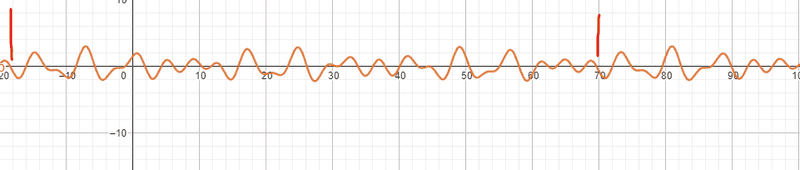

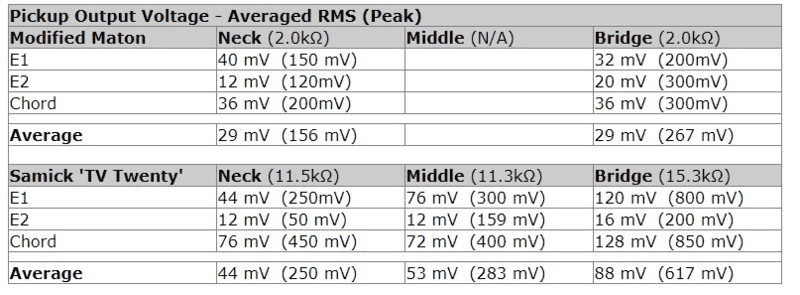

  • #101
Xenon02 said:
I just wondered if the chord could just make the E1 reduced from 0.8V to smaller like 0.6V
If you actually did something besides pick stuff from the net that you really don't know what the signal is you would understand this. If you concern yourself with peak without considering RMS in this you will not get very far. Yes, adding a second signal from a different string could reduce the peak of the signal while increasing the RMS voltage.
You need to study up on signals and systems to fully understand this. It's apparent that you don't. Yet you think you do.
If the above can be believed as accurate then the fact the RMS is higher with the chord vs E2 and the peak remained unchanged (20 mV to 36 mV RMS and 300 to 300 peak) should have answered your question, yet you asked. So that implies you don't trust the source of this info.
It's really difficult to get anything meaningful about the behavior of the pickup just thumbing it. A constant vibration of the string(s) will tell you something. This has to be controlled and the travel of the string measured. This takes patience and a well fixtured setup.

  • #103
Aha so indeed I was partly correct that the E2 was reduced because of the chord like you have said here (20mV to 36 mV RMS and peaks are the same 300mV) so the E2 peak had to be reduced then. But yea the RMS changed which I didn't give much thought. Well not always the peak was reduced but I get the idea.
Oke I think now I know what I wanted to know, now I can go back to the stuff that really matters ;>
I know this knowledge might be not useful but now knowing a bit how it looks like, satisfies my reptilian cerebellum.
Of course the source info isn't very accurate like it was said before, still thanks for patience. I'll just go back learn basics I guess ;>

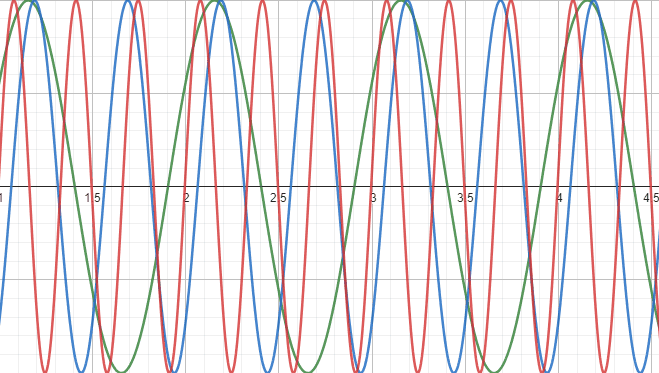

  • #111
sophiecentaur said:
Of course "peaks add" but only when they coincide in time. No one has claimed that superposition doesn't work; it has to, in a linear medium.
If you are trying to relate the addition of non-related signals to Interference, (which is between coherent signals) then you will always be confused.
This is what I tried to say by using a two signals with different frequency that at some point the peaks must add up. If the two signals were the same frequency and had a small phase shift then their peaks won't add up ever, but this is a different story with two signals with different frequency.
But yea it is still confusing, looking at certain real values.
sophiecentaur said:
Your "PS" implies that you have not actually been reading what's in this thread. Peak and RMS values of two signals are not automatically tied together except when you are discussing the same signal (e.g. sine wave).
What do you mean by not tied together ? Chord consists of these two signals. So there were 2 signals separate and 2 signals together at the same time. Yes they are not sinusoidal, but these signals consist of many sinusoidal signals. Hmm how to describe it so it won't sound stupid from me, any sound can be made adding up many sinusoidal signals so in fact even if the input is not sinusoidal it consist of many sinusoidal signals with different frequencies so they add up.
It's hard to imagine to be honest, is there any picture that could better describe what you've tried to tell me ? Sorry if I am asking alot.
I just see it in the way I saw in lessons like sinuses adding up or that every signal is like a bunch of sinuses added up to create a unique shape of a signal.
So I gave my thoughts and it was confusing in many ways, such as why 0.7 was max value (more renowned circuit designer in music assumed this in circuits I have seen made by him), if the strength of the strum can make the amplitude bigger then what is the limit ? why it doesn't distort ? Can strumming the string has a limit ?
Also why this question is also irrelevant ? I know in practical use designing a circuit probably I just need to know max value and that's it. But there are tools to reduce some specific frequency so it is known the value. These frequency has to be somehow picked and reduced. Or making a sound effect that affect I guess specific frequencies so I must to know how much to reduce etc. So it's cool that superposition works but somehow seeing real values it is just incorrect. I can't picture it why though. And what if I just strum to hard ? The amplitude could make the circuit just distort, or if even pickup can distort stuff. If only pickup distort before giving the signal to the circuit then it should be hearable even small cut will lead to distortion. Playing the same chord should lead to distort to if the sum is just to big.

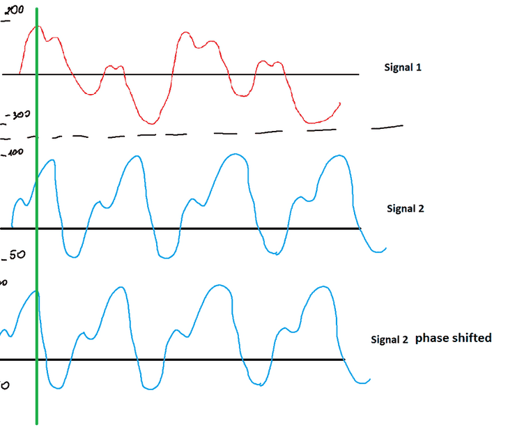

  • #113
sophiecentaur said:
= low coherence
I still don't get this part or perhaps I don't know what coherence is or looks like in this situation.
something like this ? I mean yea it looks like they are of different frequencies so because of that the peaks must add at some point in time. All peaks visible in the incoherent part will add up at some point no matter what creating really big value of that peak.
So still I don't know what this has to this
So it still suits the idea, many signals with different frequencies adds up at some point all their peaks. In the reality it does not, question is why. If they do add up like with E1 and E2 it can exceed this 0.7V said while constructing a circuit. And why pickup doesn't distort it ? Or can pickup distort it/cut the signal or it will just give in the output 2V instead of 0.7V max.

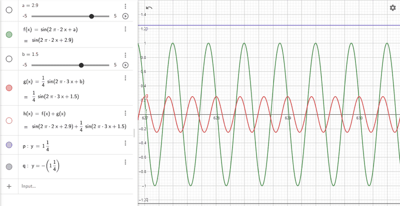

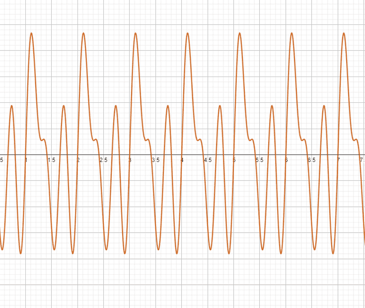

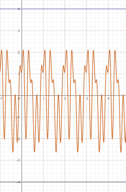

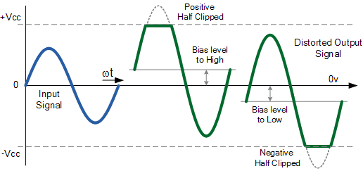

  • #115
@Xenon02

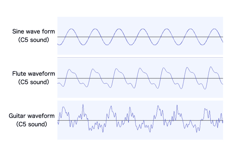

You will have seen many different pictures of waveforms. The 'spikey' sounds from a guitar string have a waveform with distinct peaks - unlike all your smooth, sinusoidal examples. Two similar waveforms of that sort of shape will clearly only cause an audible crack then the peaks occur at the same time and add together. That is far more obvious than the subtle changes
in 'roughly sinusoidal' waves. An amp may produce very little distortion except where the spikes on two waveforms occur at the same time.
Xenon02 said:
it's nice that what others think is also correct to what I thought as well)
Don't assume that this is anything more than chance - if you don't understand the theory. Theory is not 'thinking'.
Xenon02 said:
When you play many time the same chord or the same note, you won't hear the crack
How would you actually identify the 'crack'? The distortion will be more audible as the amplitude is increased but you can only be sure of detecting it if you subtract the original waveform from the new one (suitably scaled). Your ear can't do that but distortion measuring equipment effectively does just that.
But I have already remarked that all musical instruments produce distortion all the time so you cannot be certain of what you are hearing.
What evidence do you have? Theory will predict distortion but that doesn't mean you will hear it in mild cases.
Tom.G said:
A)
As I understand a guitar pickup, it is a coil of wire wound around a permanent magnet. A wire will have a voltage induced in it if it is in a changing magnetic field. A coil of wire will have that voltage induced into each turn; with the induced voltages from each turn adding to each other.
Unfortunately there is another can of worms here. It could further confuse the OP.
1.The induced voltage will be proportional to the rate of change of flux. So it's already differentiating the position of the string related to the pole.
2. The fields around the pickup are not uniform where the string is moving about, by any means, so large displacement of the string will take it through a range of magnetic field values (and directions).
I was hoping to avoid these extra complications which tell us that the 'transducer' is not actually linear. That will mean the signal from each string is a 'version' of the basic note (distortion of the individual signals).
However, inside the pickup, the system is linear so the individual emfs will add in a well behaved fashion so there would be little cross-modulation between the individual signals.

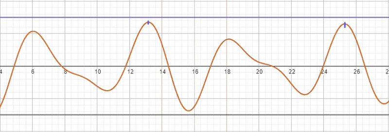

  • #116

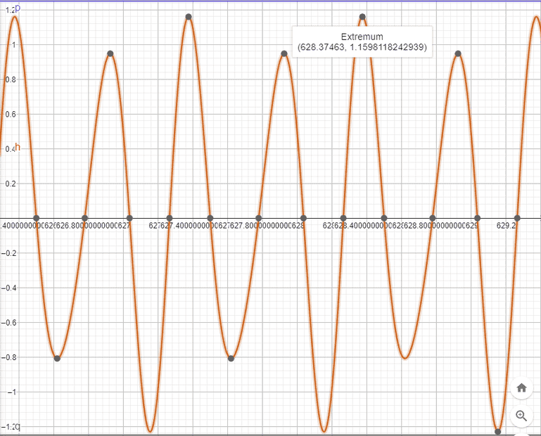

May I ask if I can.
So I understand that this picture is like a single string sound. I can imagine it is like that. This can be also analyzed as many sinusoidal signal added up into this red signal.
Also my signal I know it was clear sinusoidal but the sum was not. So my point was that the peaks should add up.
So I understand that the peak of red signal and the second signal very similar to the red signal must add up at some time, hence the time is small that even if the distortion happens we don't hear it ?
That's how I understood the text

Rather than taking some waveforms from a website, why not draw two waveforms with random peaks on them (neatly) on two strips of paper and see what the sums look like for different timing differences (phases). Sometimes the peaks coincide a lot and produce a high resultant sometimes hardly at all.
Thing is that with actual music from a musical instrument you can get all sorts of results. It will depends on the actual tuning of strings and instruments. Also the chords used in the music. In the end, it's often down to personal preference whether you perceive the sound as nice or distorted for the same amplifier. People (hifi buffs) are very fussy, often objecting to 'quality' with no just cause.
  • #125
I did something like this, one with 2 sinuses and one with 2 different shape signals. Here is the one with different shapes (g_1, h_1), it is hard to find that the sum is equal 6 : https://www.geogebra.org/graphing/merap3ws
I believe that the peaks of two not sinusoidal signals adds up at some point but this point is pretty hard to find (was doing it by hand by sliding the function all the time right ...).
I mean there is no reason for it that two peaks won't meet at some point. But I think you've tried to tell me that this sum might happen or not during the play.
Also it is not a real waveform I know it looks more like this I guess :
But didn't know how to approach making something like this ;D
But did I answer correctly ? is it that peaks add up but when it's unknown and it might not even happen during the play. Like in my example the peaks of g_1 and h_1 is y = 3, and the sum of those peaks is y = 6. I couldn't find it but it must have happened at some point but dunno when and during the play this might be neglected. So that's maybe why peak was 300mV and not 500mV because maybe 500mV could have happened but it was not enough of time or something like that or randomly one time can happen.
This is my interpretation of what I have drawn + your text.

I assume that you have looked at videos of typical guitar waveforms. Google can help you there.
I can't think why you want to consider six string chords before you have an idea of how two string chords work. Just get the basics first.
  • #129
Found these images. Huh so they are repeatable signals,
Mine was also repeatable :
This is one string
This is second strong signal it repeats.
So adding up will result in chaotic one. So the peak I saw most of the time were Y = 5.3, couldn't find Y = 6, it must have happened at some point but I couldn't find it.
But going into hand made like the one in the picture I will try to make it in paint if it's not a problem :
Changing the phase will make that peak of blue and read will match and appear as the Y = 100+200 = 300
I can change the phase of blue one so that it will match with the red peak value.
But even without changing the phase the peak will appear, somewhere ? Is it incorrect ?
I've recreated the effect in website and tried to explain what happens while shifting the blue or red signals. The website was easier to recreate but is also non-sinewave, it repeats at some point. So what is incorrect in the website version ? The Excel will be similar but with hand written values. Adding up the signal will result in similar effect like the handwritten one or the website one.
PS. My diagram from website I made is like this :
Which leads to the question if my diagram is incorrect ? Is my deduction also incorrect ? Yes, then why ?
I deduced that because E1 and E2 didn't add up is because there was not enough time ? the signal is long and for it to happen it takes time, or my signal is way to slow.
It's hard to deduce it having arbitrary stuff that's true ... But it just gives question why it did not happen, phase shift can only make this point happen faster or not.

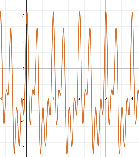

I've made some arbitrary numbers to create a one cycle and copied it. After the plotting each cycle has similar shape but different value. Changing the phase changed the shape a bit. But there because each cycle had a bit different value but similar shape it
It's hard for me to deduce it ... Because when I was using sin(x + a), sin(pi/2 x + b) and sin(pi/3 x +c ) they very much changed the values drastically, and the tops overlaped less or more.
When I changed into sin(2pi x + a), sin(2pi *2x + b) and sin(2pi*3x+c) then the peaks were more constant ...
Here the green is pretty consistent, hence :
No matter how many cycles passed the peaks are the same and didn't reach value Y = 3. Which confuses me mathematically because I might be dumb here again.
I don't know now because faster signals should catch up to slower signals at some point so that peaks should match at some point and result in Y = 3 after x-cycles.
Now I don't know, does signals with different frequencies will always have that one point where their peaks add up ? In one example with sin(x + a), sin(pi/2 x + b) and sin(pi/3 x +c ) it showed that fast signals slowly catched up to slower signals so that peaks where bigger at times like in first picture, in the other example it showed that faster signals never catched up to slower ones so that peaks match up.
I am now confused mathematically, and can't deduce from making excel sheet nor with this graphical web. Whether the peaks of signals with different frequencies must add up no matter the frequencies (no matter means here that after x-cycles the peaks match, changing frequencies changed the time when this happens). If not I wonder now why when in one the fast one was catching up to slower one and the other it was all the time the same ......
Confusion lvl 100.

Phase changes the max peak value. https://www.geogebra.org/calculator/myxxzexe - tested with 2,3,4 signals. Each added with shifted phase could reduce the max amplitude, was able to reduce it to 2 max amplitude (dunno if I can lower it having 4 signals maybe different frequecies ?). Changing the faze I can get bigger amplitude, but not max which was Y = 4 (to big steps of the phase shift maybe).
Well so phases changes the peak. But there is still a question.
What is the max amplitude value of one string ? Do strings have different max values of the amplitude ?
Also it is a phase shift so E1 and E2 if happened that the phase was shifted enough to add 300mV and 200mV and other signals peaks, then it will for sure ? Exceed 0.7V and it is periodic so the distortion will be heard :
So playing the same chord can bring this distortion but it was mentioned it would be not heard although distortion is hearable in rock music (it has that specific metalic/cracking sound). Which videos show how it sound with and without distortion.
So yea it is probability that the phase will align so that all peaks are added (like E1 300mV and E2 200mV and other that are not mentioned). It is a chance.
If this question even have sens, then distortion happening when the luck will happen playing the same chord and add all peaks. That it will not distort. Playing the same sound over and over and distortion happens. And it will be hearable. So I wondered what is the max single string amplitude value, or does every single string on the guitar has it's own max amplitude value which cannot exceed.
Changing phase will NOT change the peak amplitude. The peak amplitude will occur every so many cycles repeatedly. Changing frequency will change how often this peak occurs. Pretty basic stuff from a signals and systems standpoint.

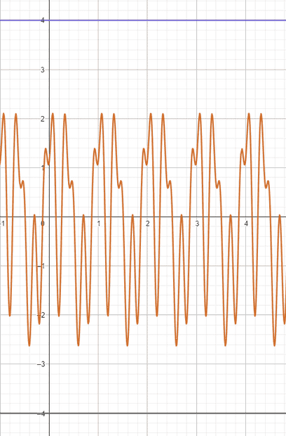

Hmmm
So my example here
Should at one point have Y=4 ? It was most of the time Y=2.09 or a little bit bigger like Y=2.1 and not higher after looking at many cycles.
Same signal but different phase of one of 4 signals, and top value is 3.14. Max sum can be 4 because 4 signals with amplitude 1. But here it was constantly 3.14, sometimes 3.12 or 3.15 but not heigher. But I only changed the phase and the sum changed.
Hmmm I'll check somethings. Because if it not changes the peak.
But when I changed the phase the top value changes so hmmm but how often it occured was less often.
  • #142

I am confused, the pictures I've shown are one signal in fact. The sum is just each sound that are decomposed from the output.
Okey so E1 has a specific output, E2 also a specific output, playing E1 and E2 at the same time will produce a different single output but decomposing it will consist of E1 output and E2 output but added. It is a single output like you've said it just consist of E1 and E2 because you hear them.
Nevermind for now I'll now focus on what Averagesupernova said, because it is still superposition, the chord consist of each string sound so it can produce the output which is a single signal. And I have a feeling of lack of understanding the additive part of each signals.

Idk
I think I'll just stand with this version :
Changing the phase of signals will change the amplitude of the sum of all signals. Like here one signal was being changed (it's phase), and the amplitude of the sum changed. So the peak value of periodic signal here can change and doesn't have to be the sum of all peak signals separately. Phase matters etc.

Show us a plot with the fundamental frequency and a single non-integer harmonic that is about a quarter or less of the peak to peak value of the fundamental. Take enough cycles you will find that the cycles eventually line up. Your peak just moves farther out. You are not waiting for enough cycles to go by in your case.
If you just use the fundamental and a very close frequency you will see changes. But you have wait longer for more cycles and the peak will show up. Try adding two signals of the same frequency and yes, phase matters and you will never see any peak different than the previous. Also, keep in mind that X degrees of phase change on the higher frequency signal doesn't move those peaks very far between the peaks of the lower frequency signal.
Likes Xenon02
  • #146
I took it that the first frequency is 2Hz while the second one is 3Hz do the second one is as I read non-integer.
After like X = 630, didn't count the exact cycles their sum didn't change much.
Top value wasn't changing alot.
Values I've noted :
Y = 1.1598118242943, X = 3
Y = 1.1598118242939, X = 100
Y = 1.1598118242940, X = 224
Y = 1.1598118242938, X = 352
Y = 1.1598118235486, X = 724
Y = 1.1598118236484, X = 1251
Y = 1.1598118197268, X = 1430
Y = 1.1598118170228, X = 1509
Y = 1.1598118205792, X = 2139
Y = 1.1598118197515, X = 2784
Y = 1.1598118242948, X = 3123
It was dropping to 81 then again back to raising to 82. I can imagine that faster signal can catch up to slower but here it is a bit random. Like I could never reach that moment because it is not constantly raising. At some point it was going back to square one. Here till 1509 it was decreasing and from that it was raising at 2139 and again from there it was decreasing and again back to increasing.
It was decreasing, and at some point it was again increasing but didn't find the moment though.
For the same frequency I can imagine that their peaks won't add up if their frequency is not matched.

Try when the 2 signals are relatively prime to each other in frequency -- perhaps 3 Hertz and 7 Hertz.
If you plot enough cycles of the output, you should see a result where the amplitude repeats every 21 cycles of the output.

Indeed in 3Hz and 7Hz amplitude repeats itself.
But I think Averagesupernova
So I interpreted it that changing the phase will not change that the max amplitude will be when two signals will be in phase at one point. In other words peaks of each signals at some point should add up. Because peak will no change.
So I went with this idea but I see it is repeating the amplitude which was : 1.1998263829145 for 3Hz and 7Hz each 21 cycles. So I dunno when Y = 1.25 which is max because changing phase doesn't change the peak as it was said. Or I misunderstood it.
  • #149
So I've given two signals and they weren't getting any bigger infact it was repeating at some point. The peak didn't get to the max which is Y = 1.25 and changing phase shouldn't change that the Max peak should occur.
